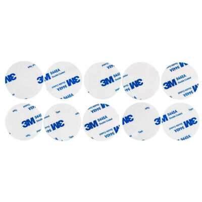

Do you know where I can purchase 6448A 3M sticker for the bezel?
I tried most of aliexpress store and they all sell #613 sticker.
#613 works too but I think its bit thick and I am thinking maybe 3M 6448A is much thinner.
10 pack

@derjenigewelcher , @KJ2020
This is what I use:
