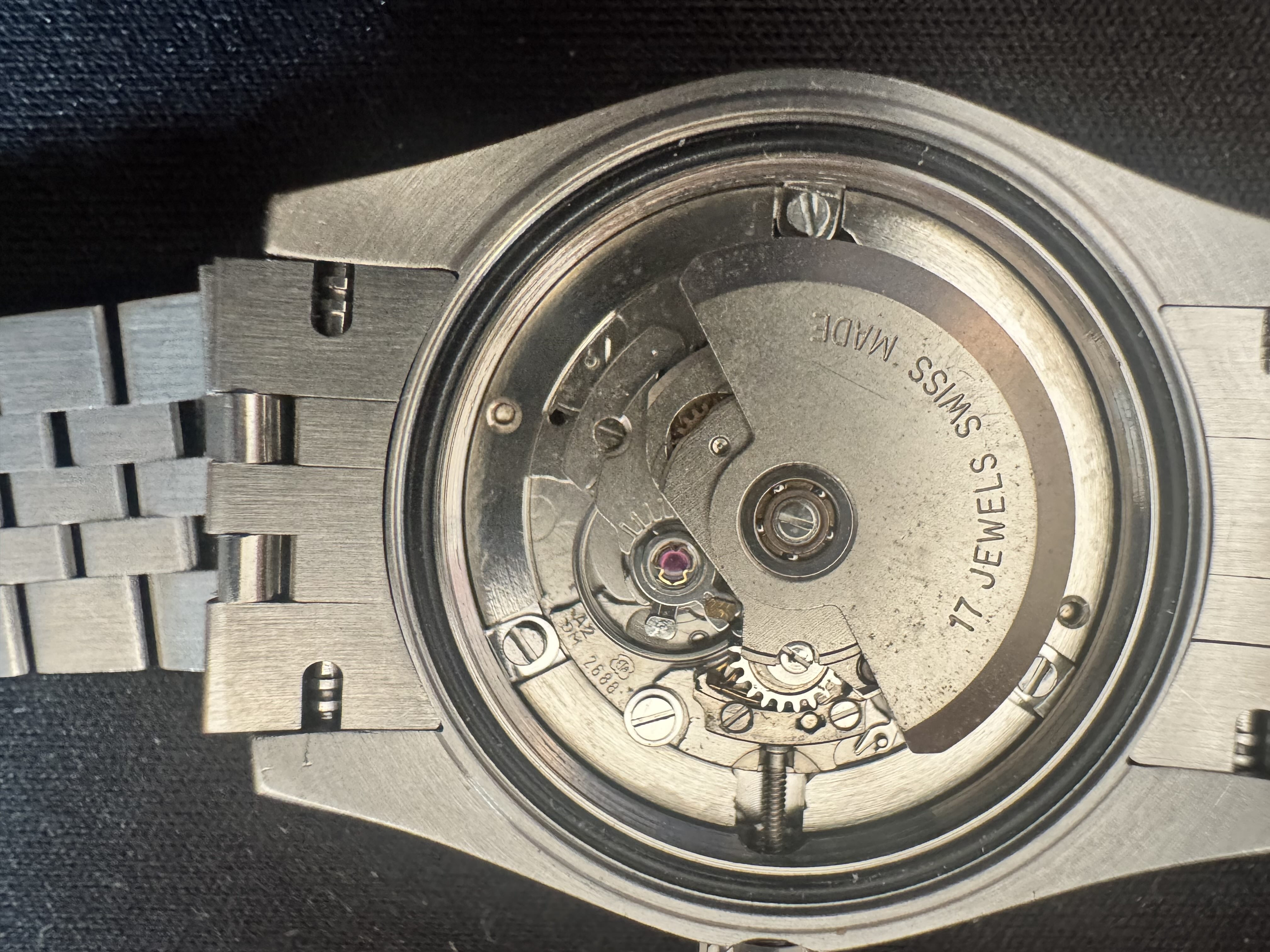

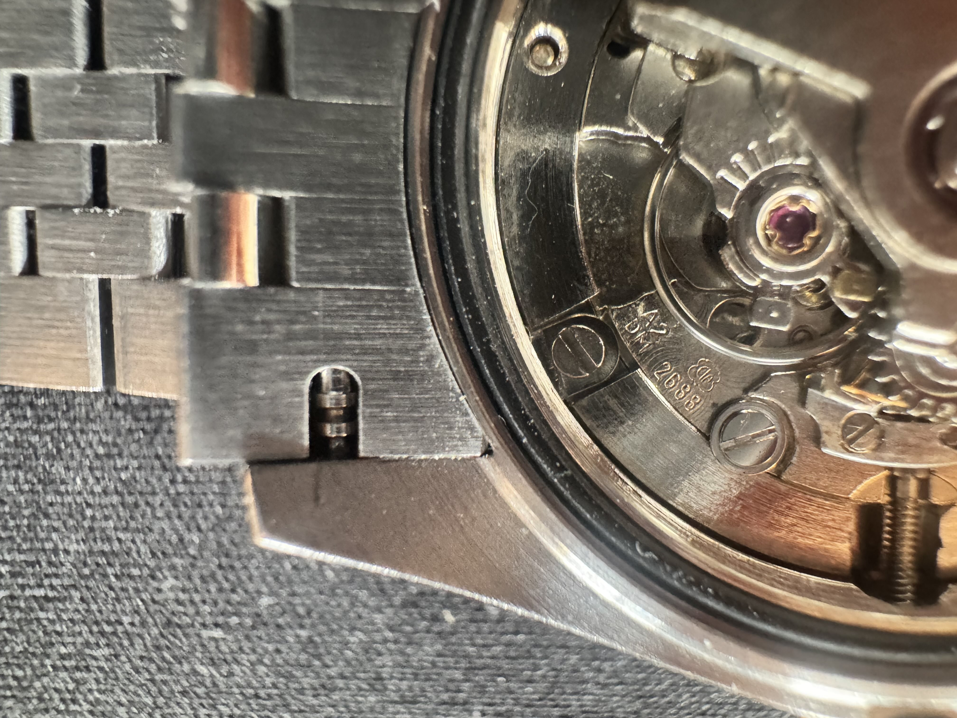

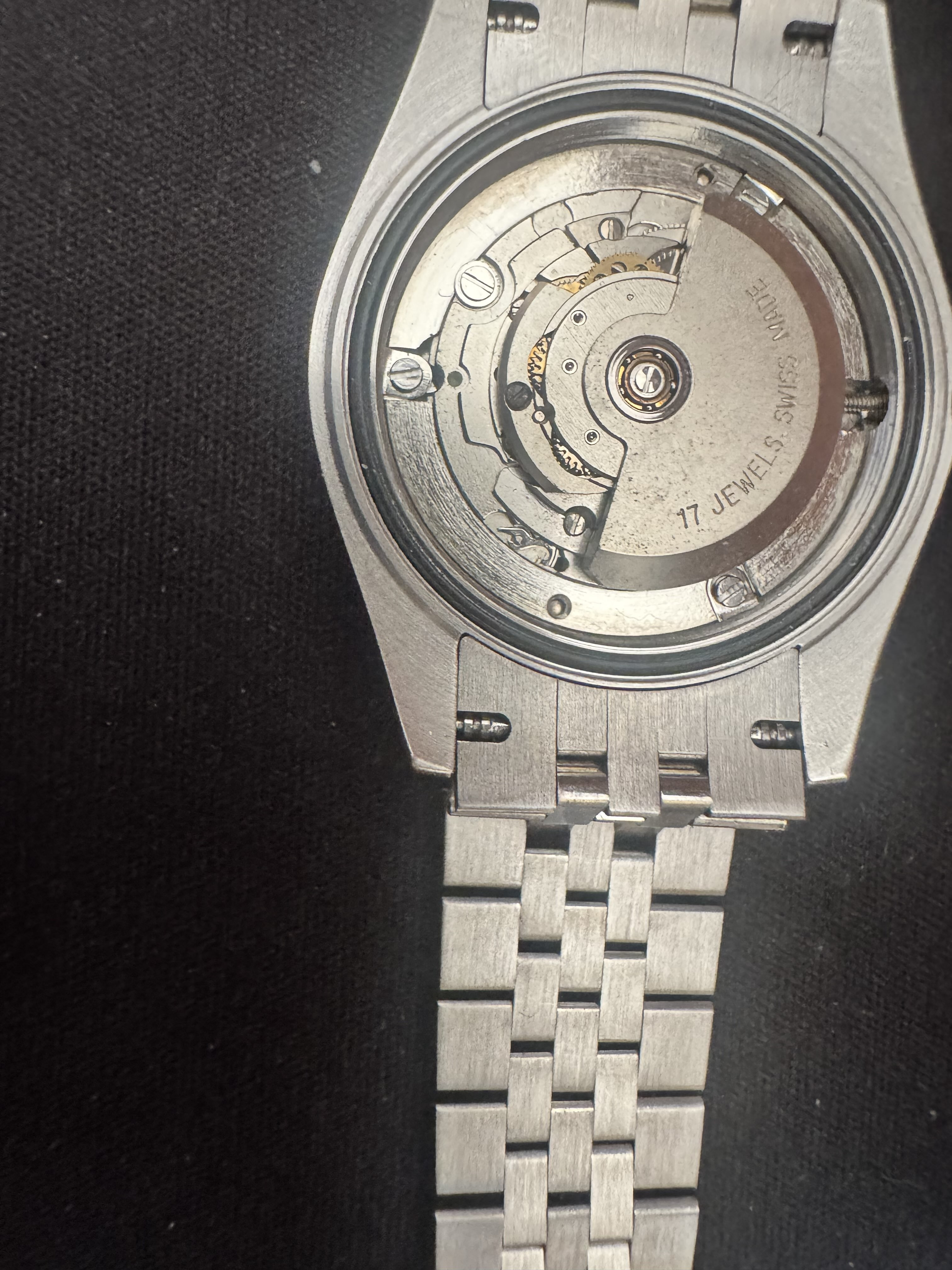

I have question regading DateJust movements for small watches 31 mm. I saw many replicas use cheap 2813 movement , better clones I seen 2688 clone ? Any more info what is used ?
9,587
26,586
Almost always 2824/2836 or something. ive even seen NH35.

I believe that technically it is a 2834-2 movement, but for some reason it is always quoted as 2836.

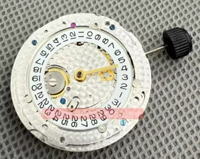

In late January 2024 it was announced that Clean Factory had collaborated with Shanghai movement factory to produce an SH4131 movement that would be exclusive to Clean. This movement has some interesting features... note the updated engraving (purple arrow), and the familiar SH-style fake hairspring stud on the balance bridge (blue arrow) with the regulator arm pointing inwards (red arrow). Also of note is that unlike many reps, the rotor bearing block on this movement is completely filled with ball bearings (orange arrow) -- this should make the rotor run more smoothly (and more quietly). @CTime has posted an excellent part by part comparison of the SH4131 with a gen 4131. From The part by part comparison it appears that the SH4131 is basically a true clone except of the escapement (balance, pallet fork, and escape wheel).
In spring 2024 there was an updated version of the SH4130, SH4131, and SH4132 which were all released with a slightly updated balance bridge that featured outwards facing beat adjustor and regulator arms (like the DD versions of the 413X movements). So identifying the SH vs DD versions of Daytona movements has become more difficult. However, just like the updates to the VR3235 which ditched the balance bridge decoration plate, there's still a way to identify the SH versions from the DD versions: the SH versions have the hairpsring winding counter clockwise, whereas the DD versions have the hairspring winding clockwise. Below is an SH4132 v2 wher you can see the beat adjustor (red arrow) where the hairspring starts, and then winds counter clockwise (orange arrow) through the regulator (green arrow) and spirals inwards to the balance staff.

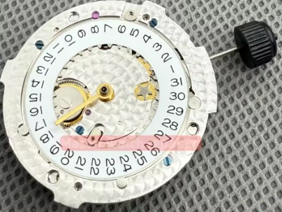

The Dandong 4131 is a new movement (as of May 2024) that has first appeared in the Better Factory (BTF) 12-series Daytonas. This movement has the outward facing beat adjustor (green arrow) and regulator (red arrow) that we typically see on Dandong movements. Also note that like all Dandong movements, the hairspring on this movement is mounted clockwise (orange arrow). The DD4131 also features a completely full ball bearing race to support the rotor (not pictured). Hopefully this movement will be a worthy successor to the DD4130 which has served so well in the 11-series Daytonas. We can see from the pictures that this movement features a gen-like skeletonized escape wheel (blue arrow). It has also been confirmed that this movement (unlike the SH4131) features the gen-like chronenergy geometry of the pallet fork. It's possible (not yet confirmed) that the DD4131 will be able to support a gen balance complete swap, whereas the SH4131 is not compatible with a gen 4131 balance -- this is something to keep in mind for anybody planning a 12-series Daytona franken build.

Thanks for the suggestion. As far as I know all DJ31 and DJ28 reps come with the a clone of the ETA 2671 movement. The ETA 2671 is basically a smaller version of the workhorse 2824 movement. I haven’t worked on many of the Asian clones of this caliber, so I’m not sure if the quality is on the same level as the Asian clones of the 2824; but I suspect that to be the case.
I have a rep DJ31 with something named 2688 pictures attached.
