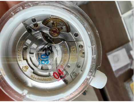

Dogwood, sorry to bother you again. I'm completely lost. I'm being offered this one. What is it? To replace Clean's VR3285? Will it work?
This is an interesting movement and you’re right to be lost since this isn’t one that I have officially documented. This is a Shanghai movement (note counter clockwise coil of hairspring). It’s also a hybrid 31xx + 32xx design (note the small arbor protrusion from the crown intermediate winding wheel). So this movement isn’t a vr3186 because it has a 32xx balance side. But it’s also not an SH3285 because it has a 31xx dial side and keyless works. We don’t have an official name for this movement.
You asked if this would be an adequate replacement for a Clean VR3285. But that’s a hard question since there’s no movement called the VR3285, and even if there were, Clean uses the DD3285 from Dandong. But my guess is that this movement will work in a case designed for a 32xx movement. But it won’t work in a case designed for a 31xx movement.

8,376
23,374
@dogwood
To me that looks like the "fake clean" 3285 movement?
