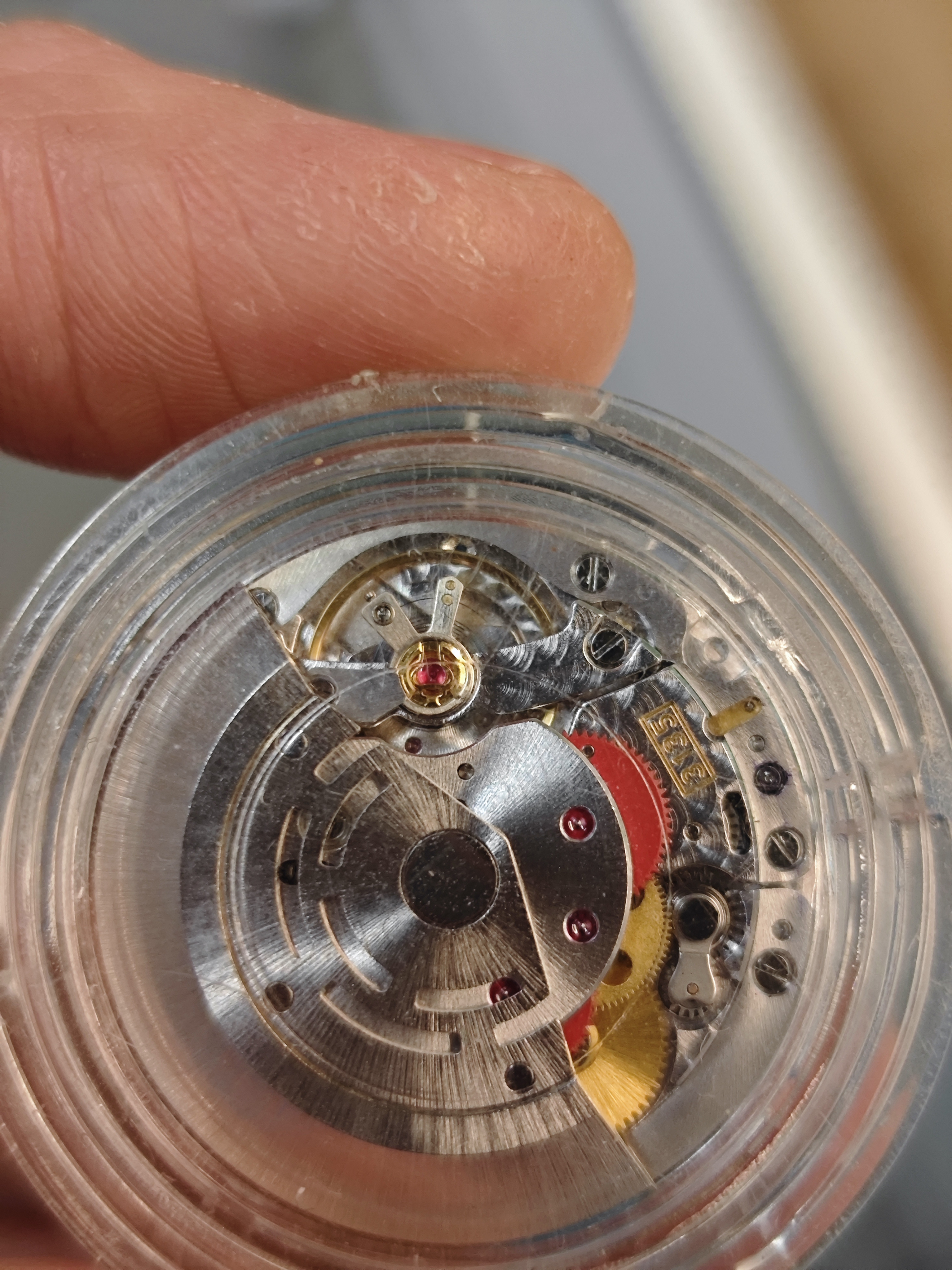

Looks like a Dandong 3135 (vs3135). Note the clockwise coil of the hairspring—a common tell that a clone movement is from Dandong.
Ah thanks i was looking at the levers. Appreciate the answer
