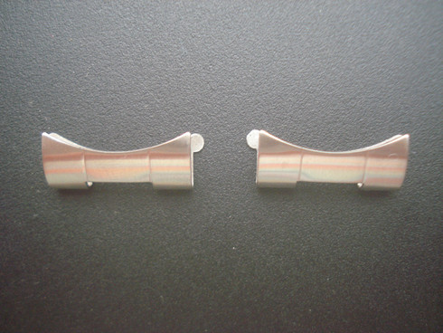

Got the Cousins deliver in just a few days. I was impressed.
Now, the cousins bezel insert does not match well with the domed cousins crystal. About 0.2mm more on the crystal and the assembly does not snap. I kept the over faded cartel insert It grew on me.
Other issue, the fat springbars are too big for the endlinks. Need to figure this out now
There is you best solution. Some people cut them to make the spring bars fit but it makes the holes a bit too fragile and they break.
Reactions: Karbon74
frigg...so much for a budget build :eek: :ROFLMAO:
Raffles has them too
Reactions: C Master

finally kept it on bracelet with the stock endlinks and spring bars... Natos are not for me. I might buy a nice black leather and definitely the Raffles rivets
One question, I removed all adjustable links. But I only had 3. hence one side is longer. Worse the microadjusts are on the shorter side. Any ideas? I am thinking of inversing the bracelet.
EDIT : I reversed the bracelet. It fits good now
