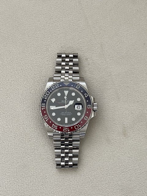

Correct but unfortunately it's not a right science on these Clean watches.
I have two Clean GMT's, both new batch with DD3285.
One of them fits a gen crystal and the lowest gasket that my watchmaker could fit was 2,8mm.
He tried to remove and to set hands better but 2,7mm gasket was always against second hand pinion.
So it has now the gen crystal(right one for GMT) but it's a bit higher than gen because of the 2,8mm gasket.
On the other one(Pepsi that i posted it some days ago) he used a nice stock clean crystal with 2,7mm gasket and as you can see it fits very good (gen like crystal height and correct magnification).
It's weird as it's not common to get that result with that combo but that's it.
The conclusion in my opinion is that there is not a right way to handle crystals on Clean Gmt's as they are not all gen spec measures, the opposite.

Yep it's.
It was blisered.
New model with colorless AR despite it exists also with blue AR.

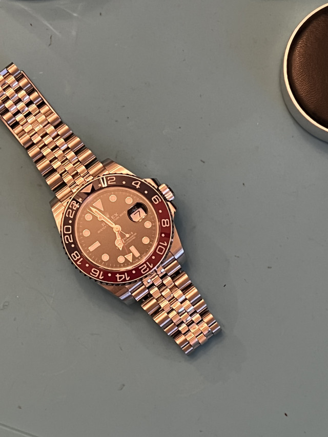

Thanks @Reaps for sharing those pics. Looks like a decent first attempt but I agree, defo looks like a VSF case looking at those CGs. It'll be really interesting to see how / if VSF will improve on this factory (dial print, movement maybe), or whether they can get the new grey dial version out.
