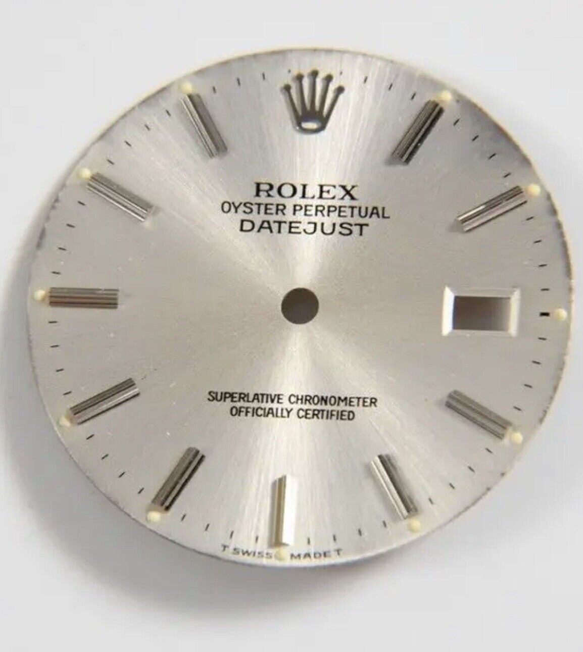

I just bought this 16014 dial on eBay for a bargain and I'm going to do a Raffles build. I've seen on this thread that in some cases lume dots scrape on the inside of the case; do I have to enlarge the rehaut? If so, any good methods for doing this? I do own a Dremel, but I don't know what type of attachement I need to use. Thanks everybody!
Yes, check your dial versus the opening of rehaut. Be careful not to break off the lume plots
If you need to widen the REHAUT, user with a sanding desk/sanding drum.
The information below was pulled right off this thread early on when the thread was started.
“It highly depends on the print of the dial. The raffles case came with a opening of 27,38mm, which is fine if the dial is not printed closely to the edge. The Gen Dials I've used have an diameter of 27,78mm and for this specific one I've opened the rehaut to 27,62 (iirc). Sure, if you grid too much, you have a problem. If you are using an 3135 (clone), the diameter should be 28,50mm, which gives you some backup, but if the rehaut is wider than the dial, I would look a bit weird. tl;dr: I would not do it, if the dial is looking good with the stock width of the case.”
I would sand a little and then check your opening, repeat again etc. etc. if you sand too much off that dial will not fit/seat properly in there and you’ll end up breaking off lume plots for sure in addition to it just looking crazy.
So take your time when you do this. Less is more initially.
For sanding the rehaut should I use higher grit sand paper (400 and up)? I feel like the sanding drum I have on my Dremel is too coarse and might ruin the opening (I guess it's like 80 grit). Thank you and sorry if these questions might be dumb, but I'm a novice in franken builds
It’s not dumb… I’m learning we’re all learning. I’d have to look at the grit that’s on the sanding drum I have. I know it’s not super coarse.
would advise against the 80 grit and only widen as needed. I have the same index dial you do on one of my builds and widening of the rehaut was NOT needed. Lume plots are tight but it fits.
