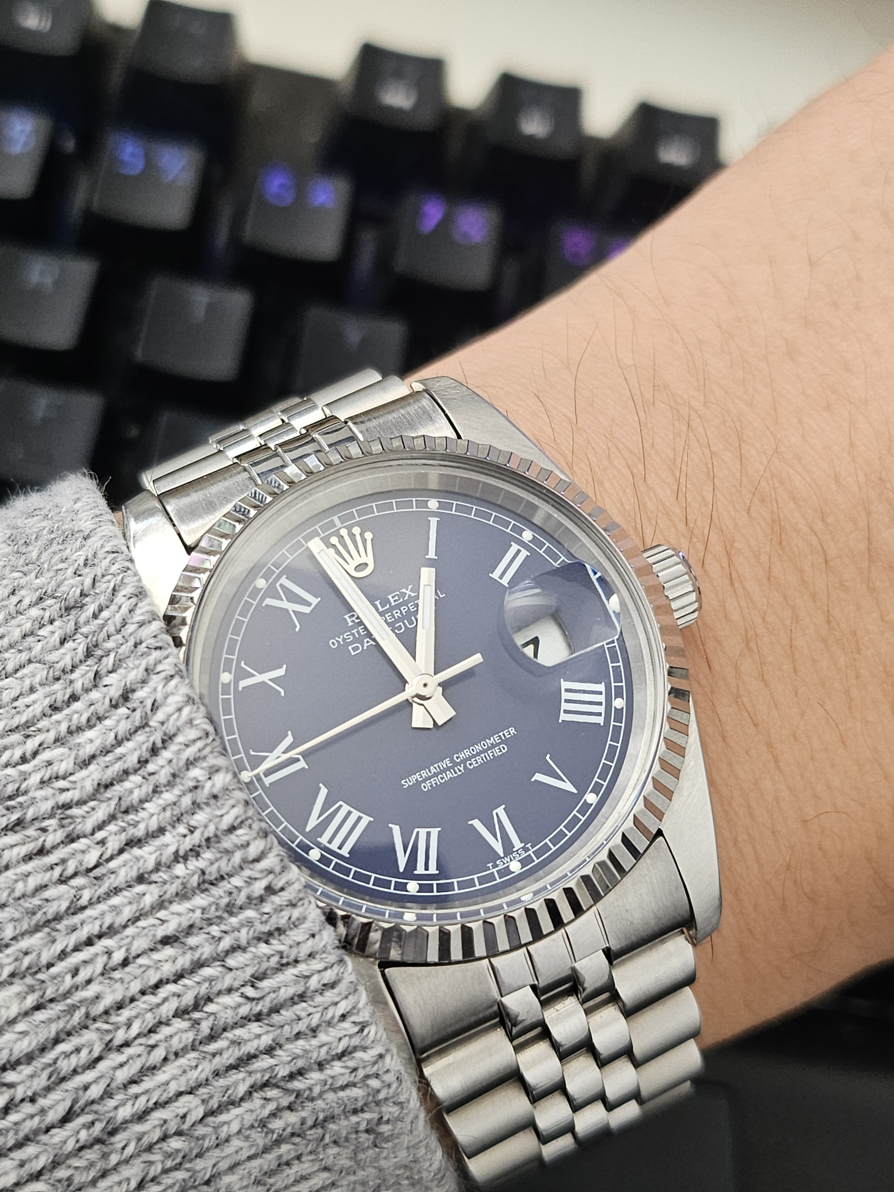

- S. Korean DJ Case
- Italian Jubilee
- Gen Bezel
- Gen Dial
- Gen Crystal (advertised as Gen when I bought it but unclear if it truly is)
- Gen Crown
- ETA 2824
- Swiss Hands
Great job! Where did you buy them if I may ask the Swiss hands for the 2824?
Thanks!

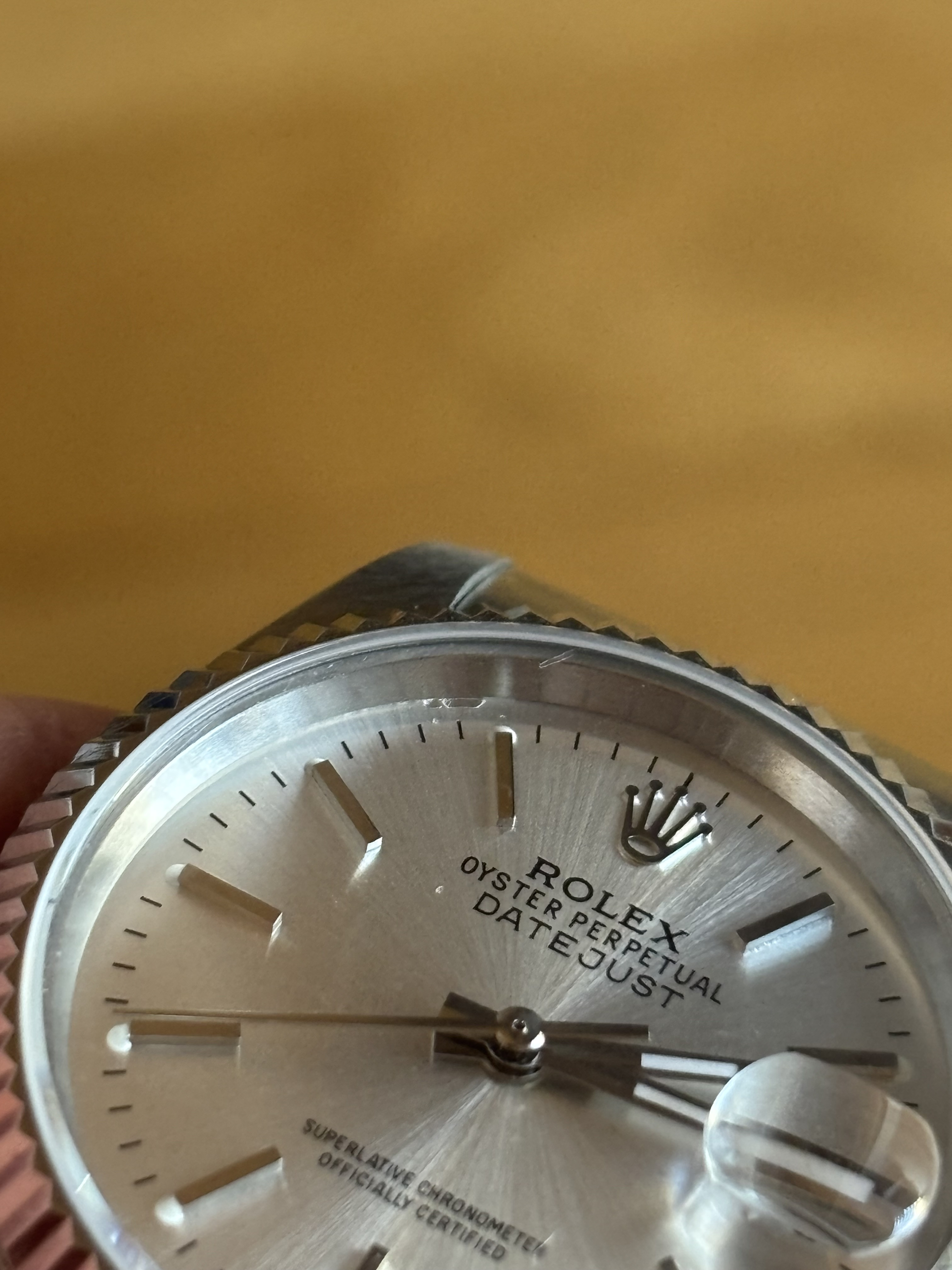

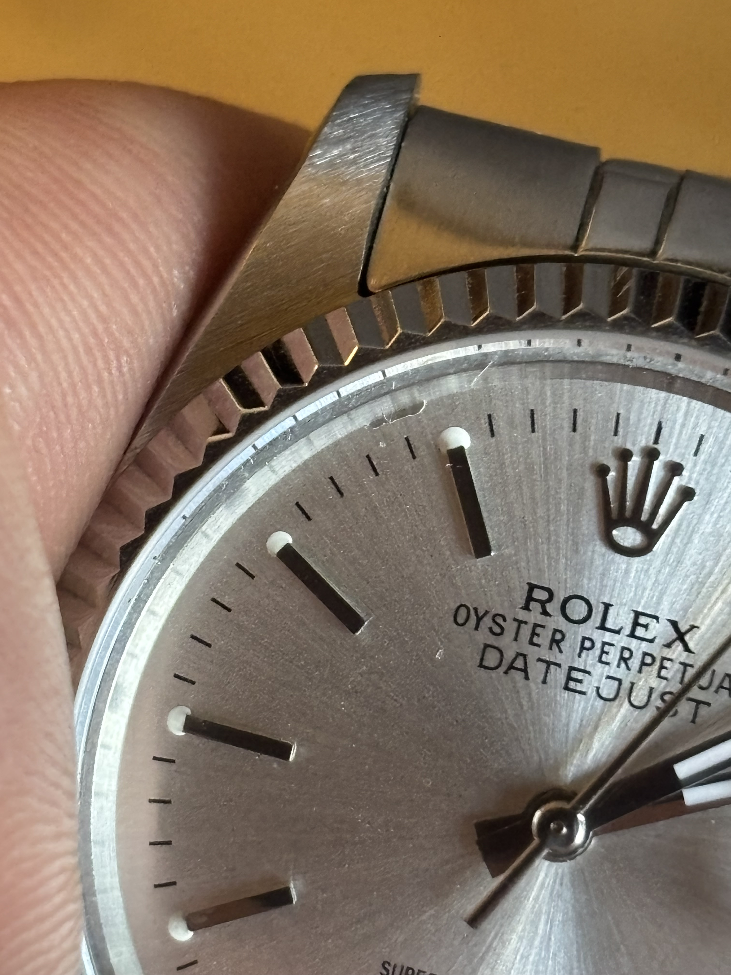

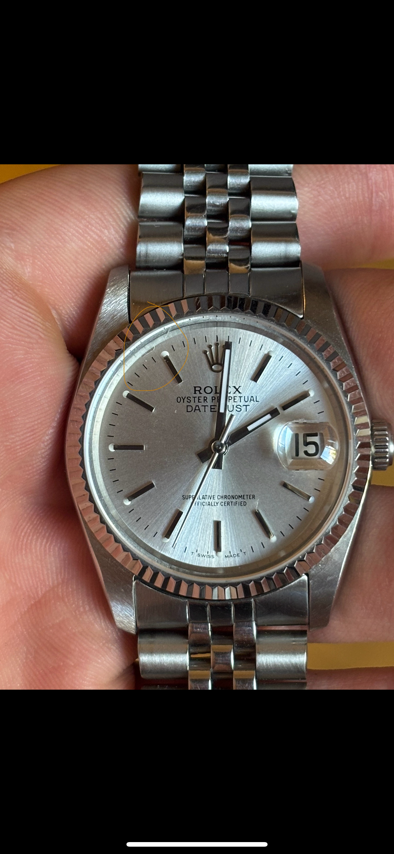

Hello everyone,
I’m having an issue with my dial.I built a watch using parts from Raffles and a PT5000 movement. After a few days, I noticed that the dial was damaged at the outer edge. I replaced it with a new, identical dial, but the same problem occurred again.
I’m unsure what could be causing this. Could anyone give me a hint about what the issue might be? I’d also love to build another watch with a gen dial , but I’m worried that the same problem will happen again. Thanks in advance for your help!

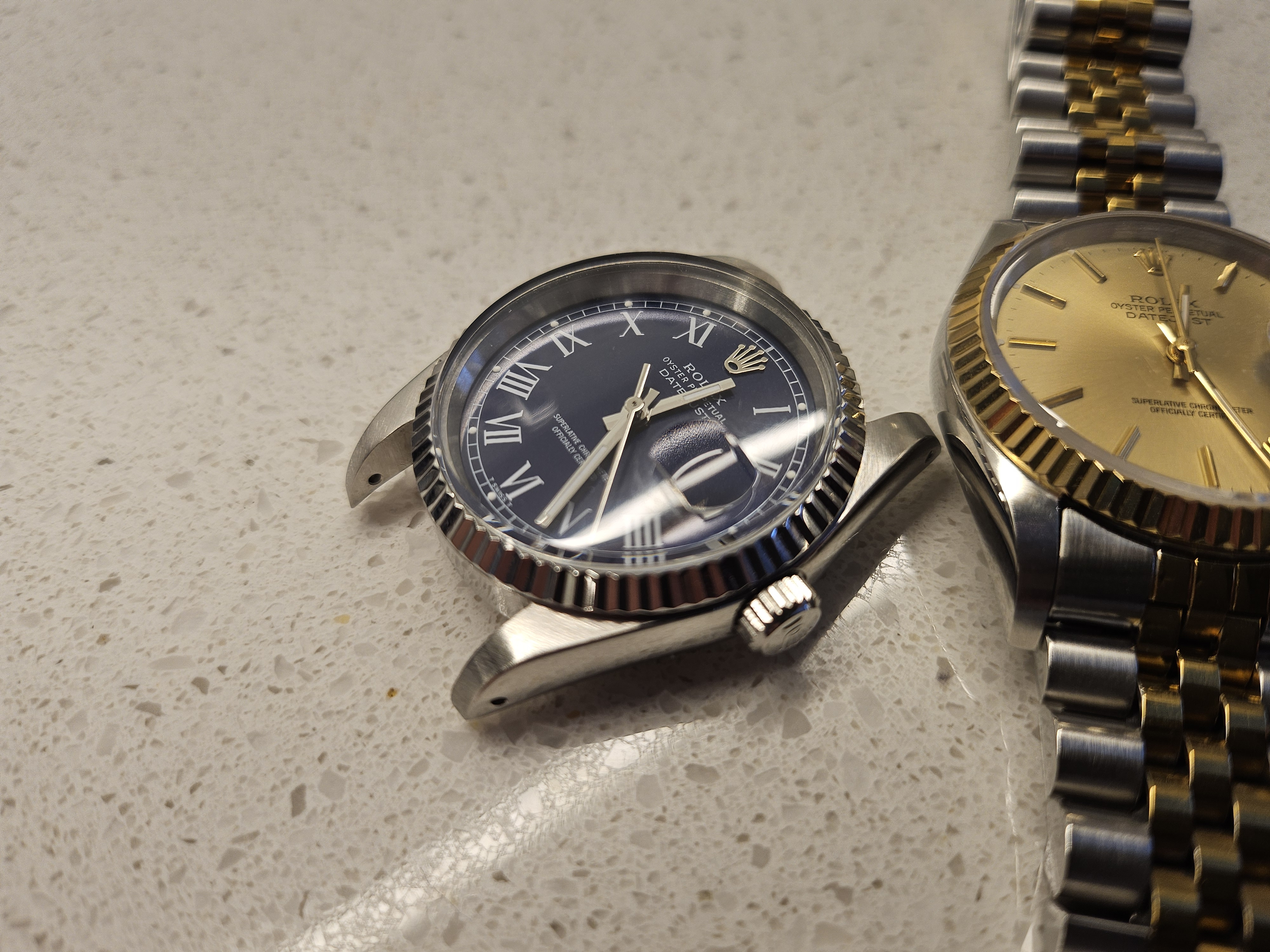

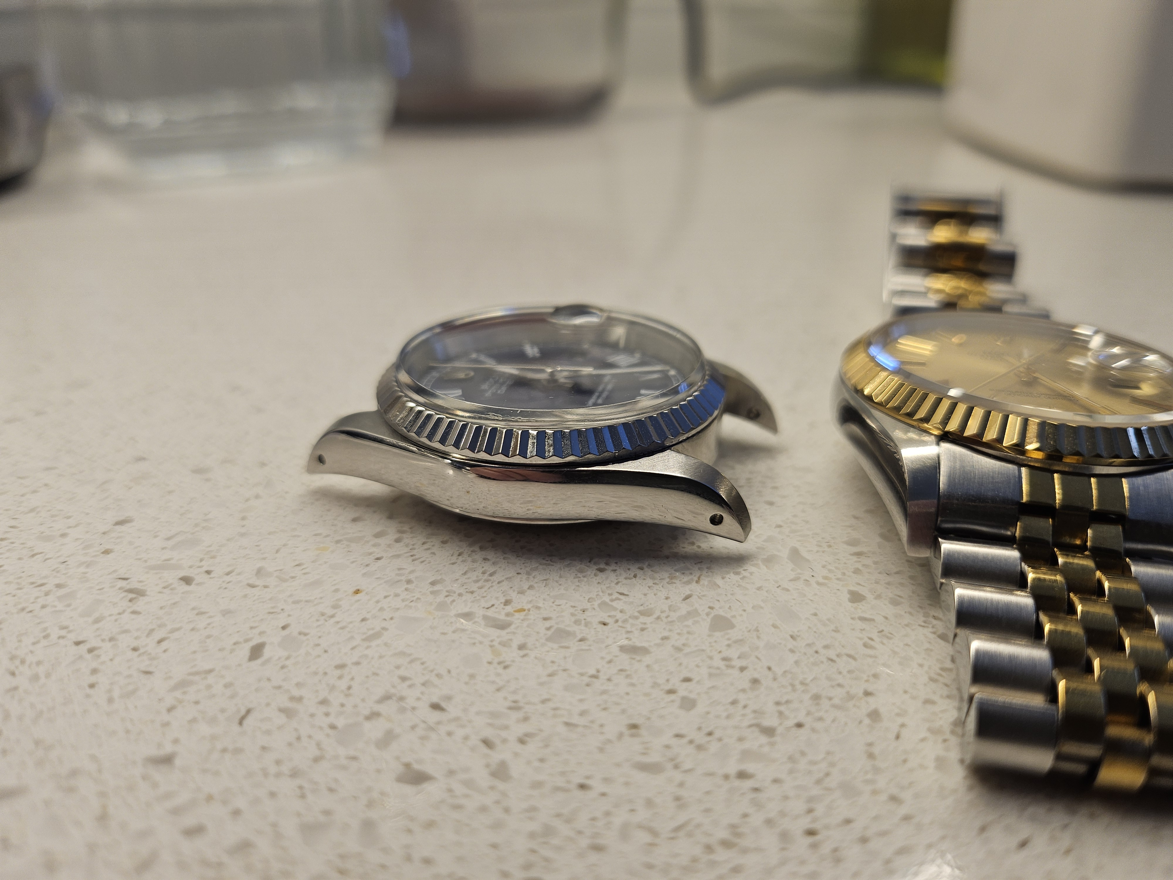

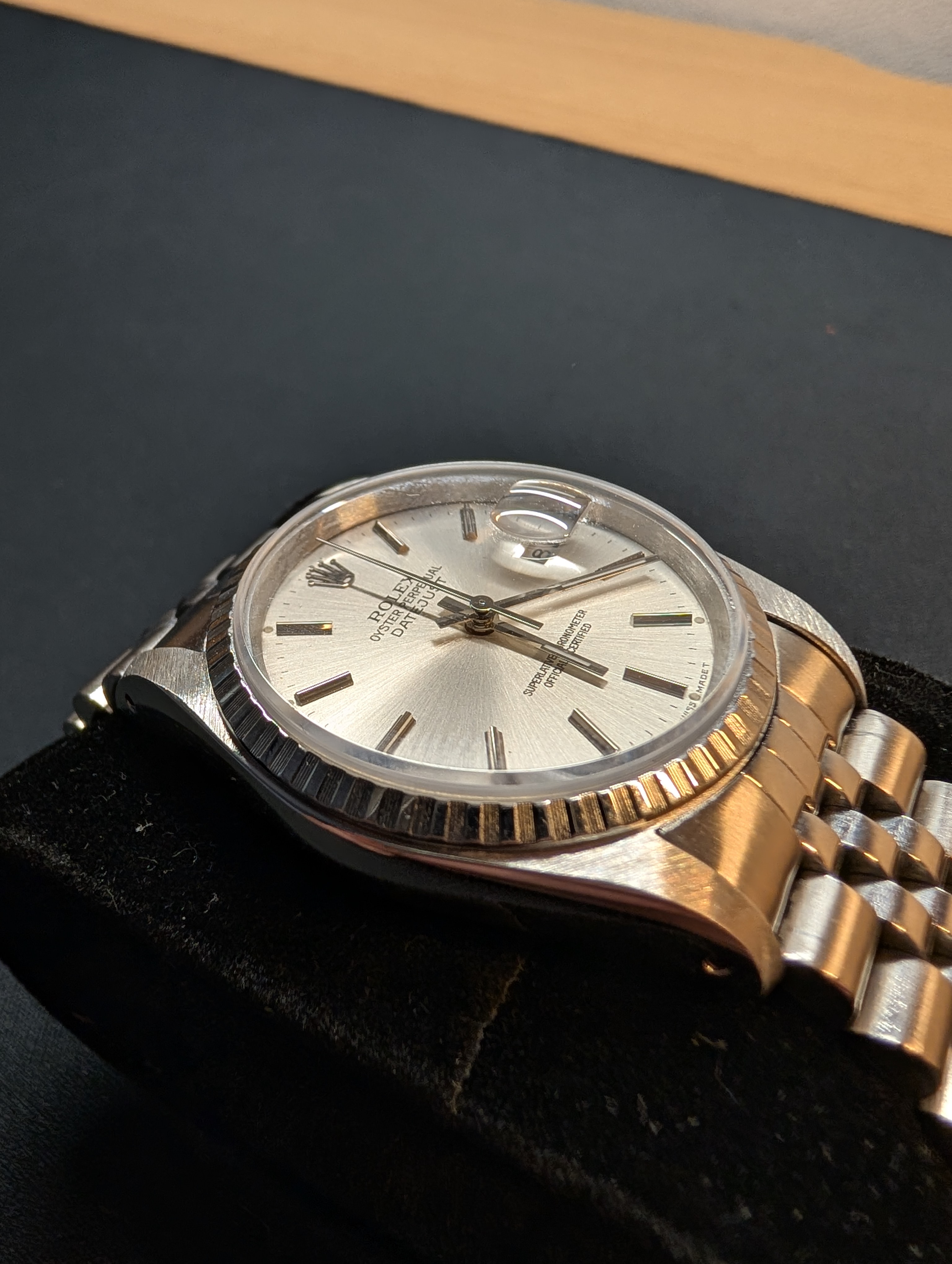

Finally got a deal on an engine turned bezel for less than 110€. I've upgraded the stock Raffles bezel and kept the same sapphire. The next steps are:
  • Change the caseback to a 1016 caseback to clear for the 3135 rotor (tried to shave off the inside with a Dremel, but it still doesn't clear enough)
  • Swap the random Aliexpress jubilee to a Raffles one
  • Swap the crown for a better one (Sillian/Vanbaol, maybe I'll try an Aliexpress one again after my last experience)
  • Upgrade the sapphire (would this one work?)
If anyone has either a 1016 caseback, a Raffles Jubilee or a better crown I'll gladly accept it (I'm located in the EU) :).
