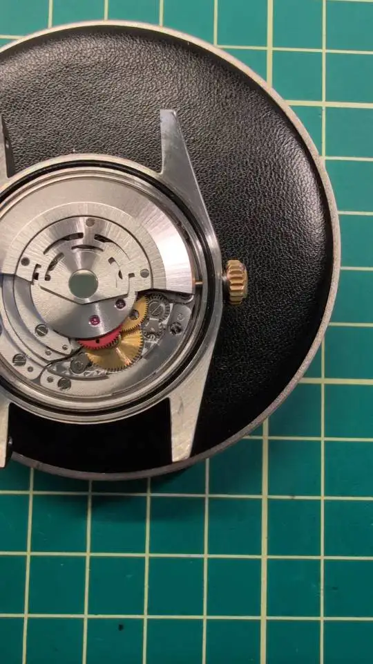

i saw this new Raffles build and was shocked to hear the case is stock. The lugs look thinner and super crisp.
So i emailed Ken, and he confirmed that the new 36mm 2824 cases are updated to have thinner lugs.
Good news to all
Also, Ken says he can now offer a 1016 caseback which fits the 3135 well.
But no one has actually confirmed this yet
I can confirm that my two-tone build has a 1016 caseback and the 3135 rotor clears. It does make it a little bit thicker, but it's barely noticeable. I've bought

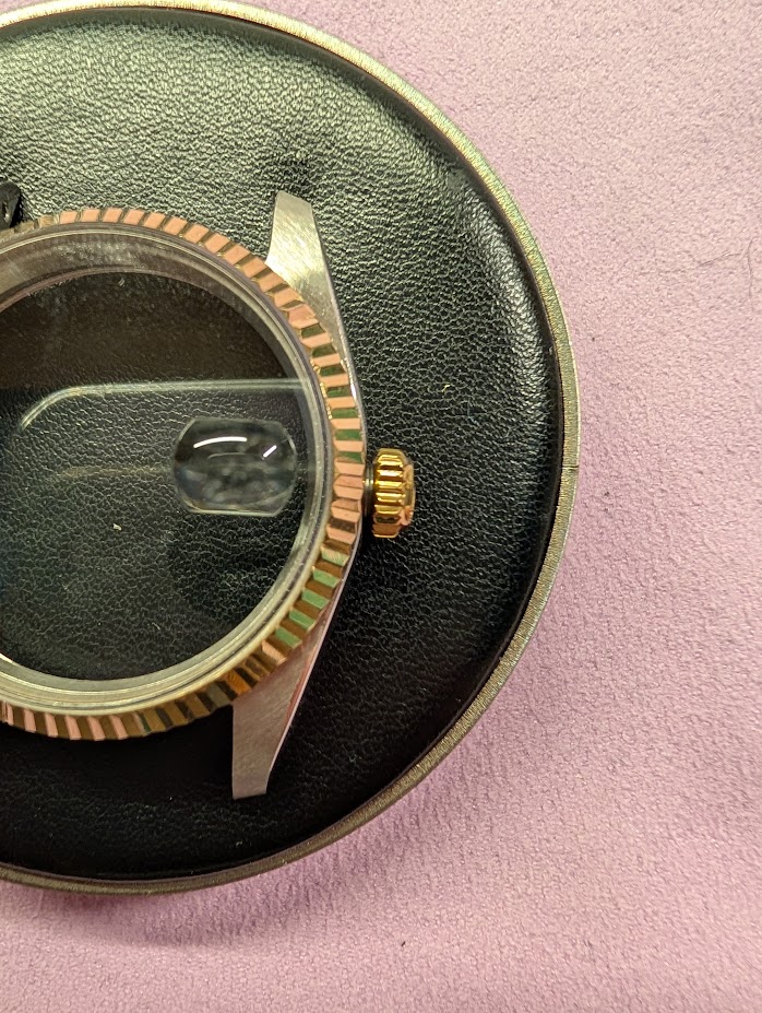

After buying this crown and it sticking out a bit i've decided to replace the 2836 raffles casetube with the one new included one. The crown should be a 24-603-0 with a 24-5300 casetube, am I correct in saying that I need a M2.5×0.25 tap?

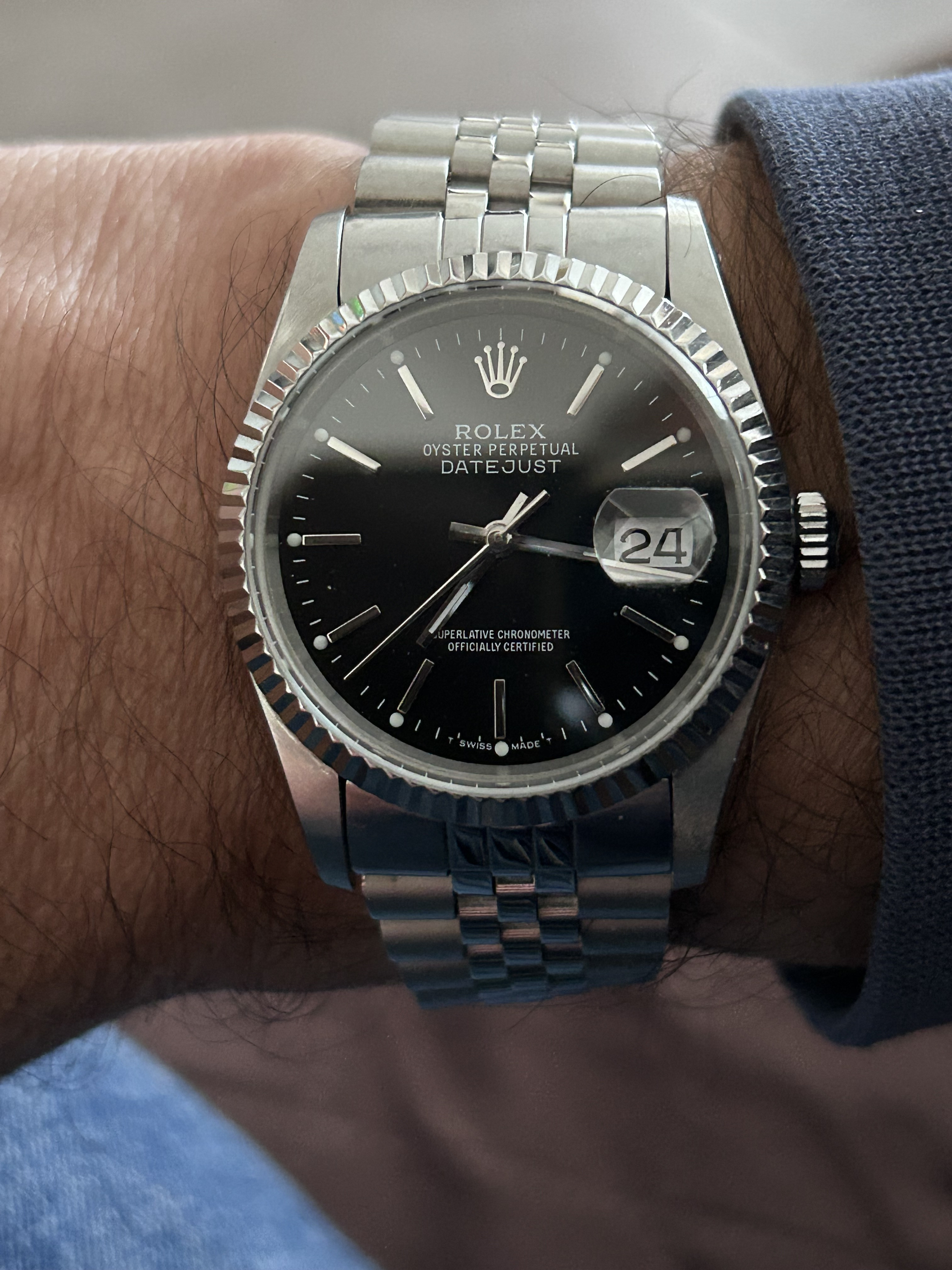

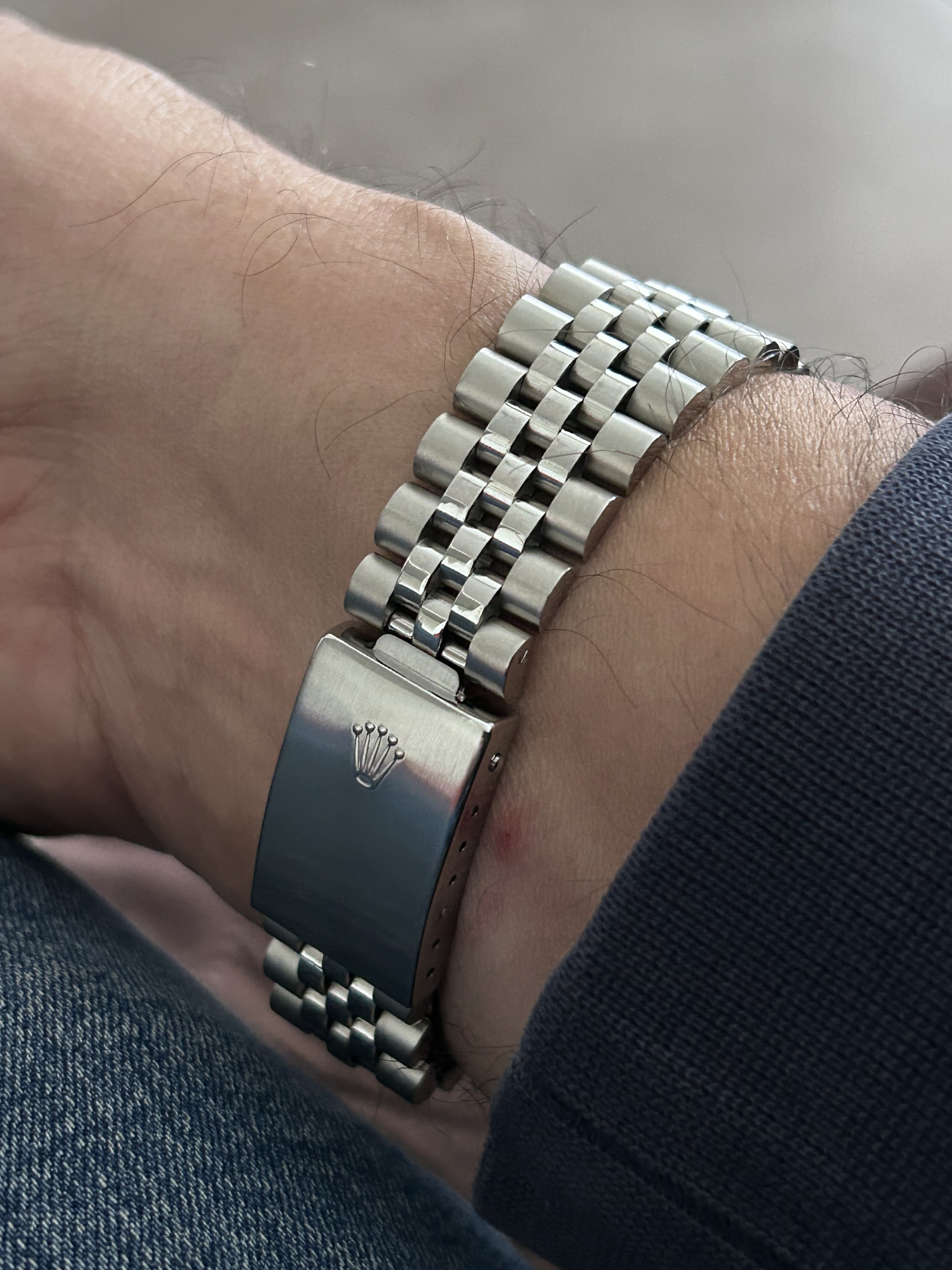

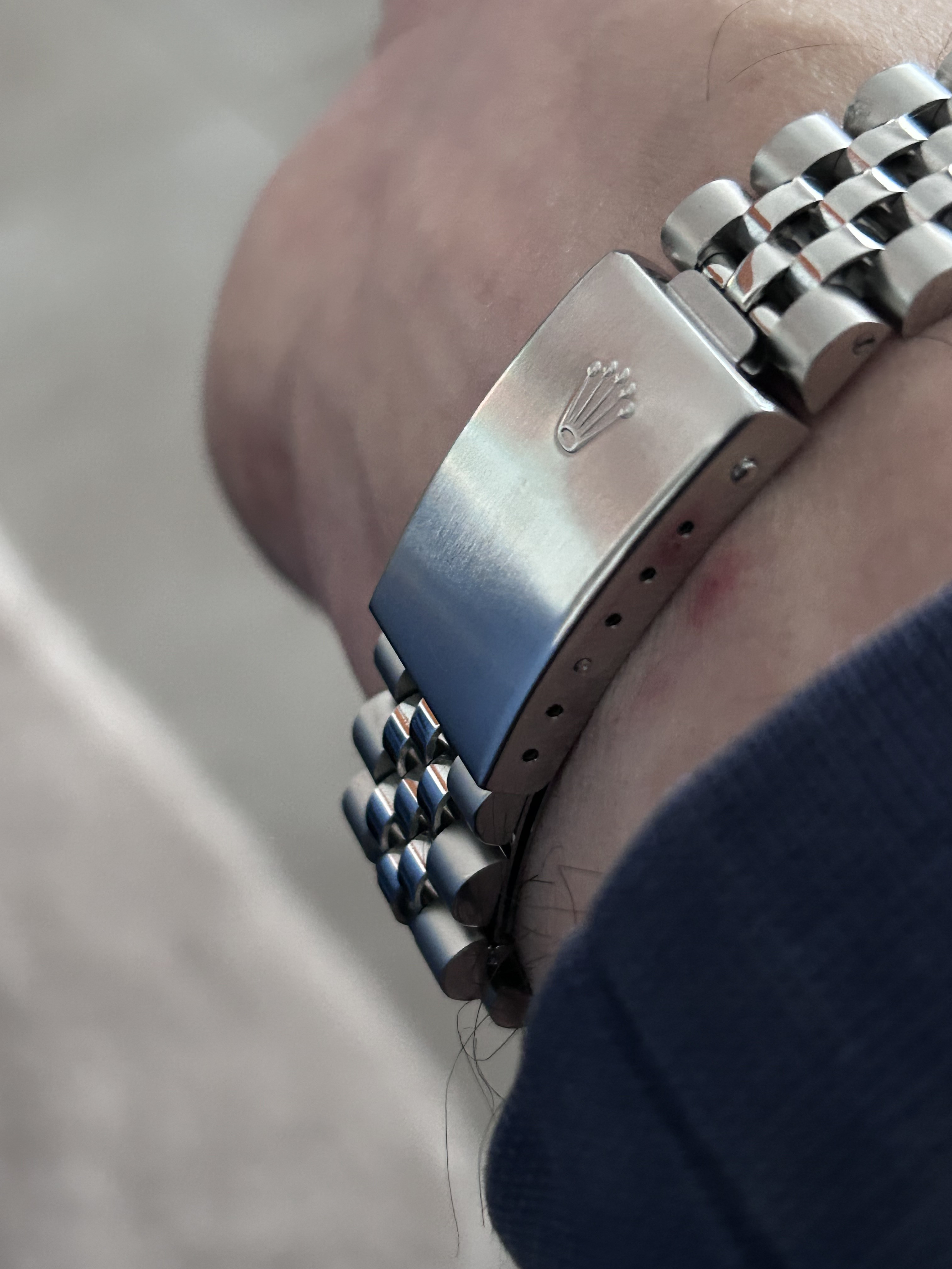

Last update on my 2023 build, new Raffles Jubilee bracelet, clasp purchased separately sanded, modified, polished and satined with GEN adjustment pin. The clasp that came with the bracelet did not have the good quality of the old one, the coronet was too close to the edge so it was replaced. In the future I would like to replace the dial with a GEN always black, now mounted is the Raffles, not bad but not perfect! 😎
