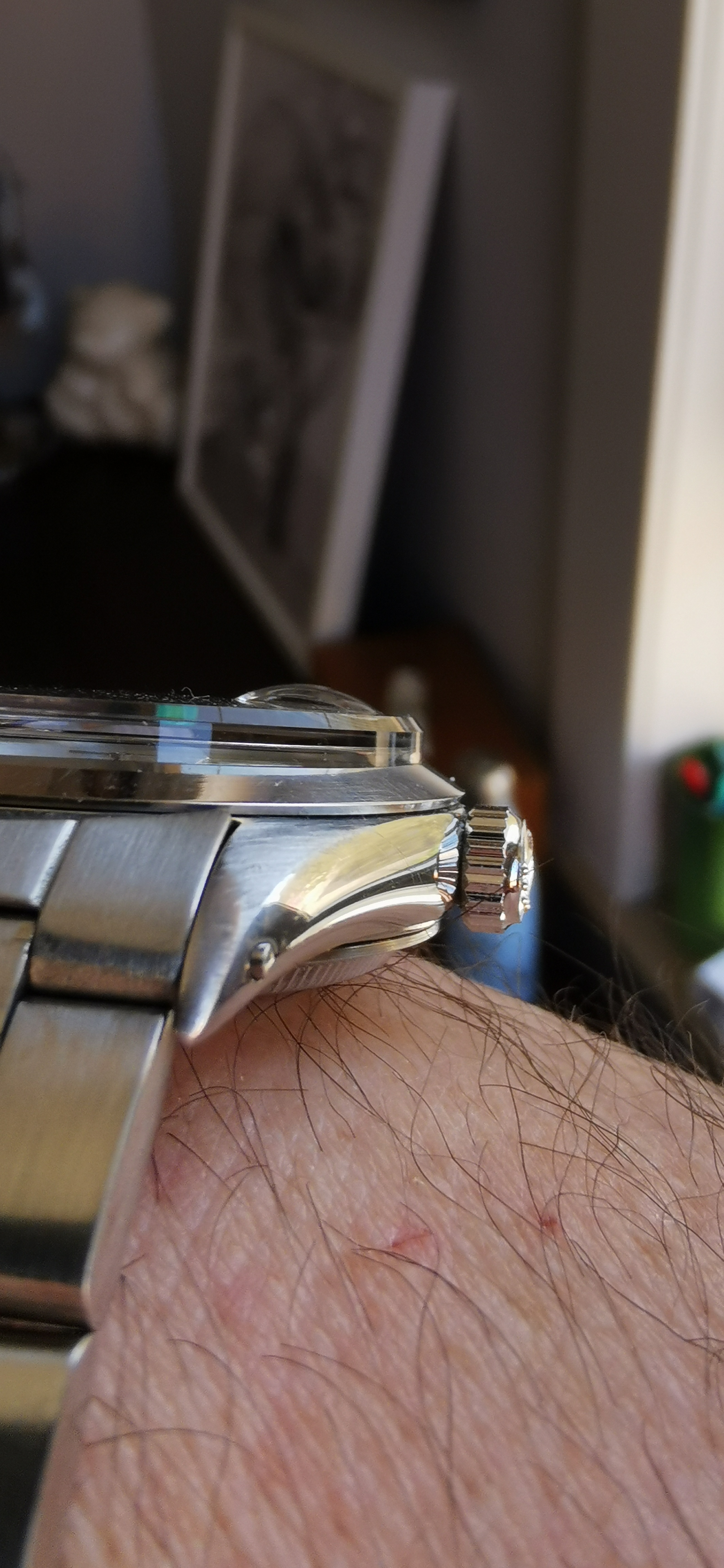

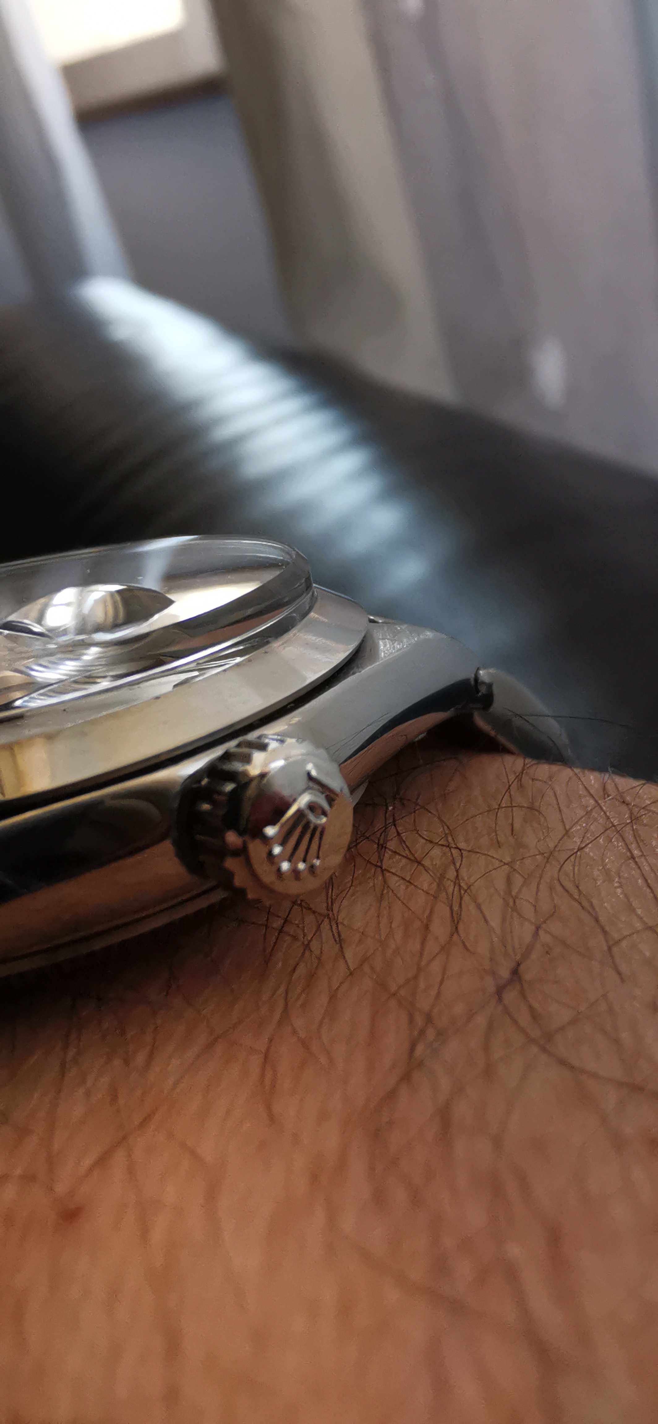

Did a little homework for @Stone P and think this bezel look right, let me know what you think
Smooth bezel, just put a dial (sadly not a datejust 😅) I have and a 118 crystal on a reworked case
