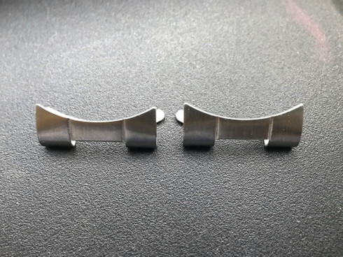

guys. I am now looking at the final assembly and I just saw that the 580 endlinks don't fit at all. I want to put a Raffles Rivet bracelet
Do you know what I need? or should I tinker the 580
1675lover
23/7/22
352
404
Reactions: 316lad and Karbon74
316lad
8/8/23
1,029
2,062
And although Ken is a great guy I had to have two sets off him as both were slightly manufacturing damaged. They looked like some sort of cyborg mouse had had a nibble out of them.
Ken replaced them without quibble but just saying...
Reactions: Karbon74
