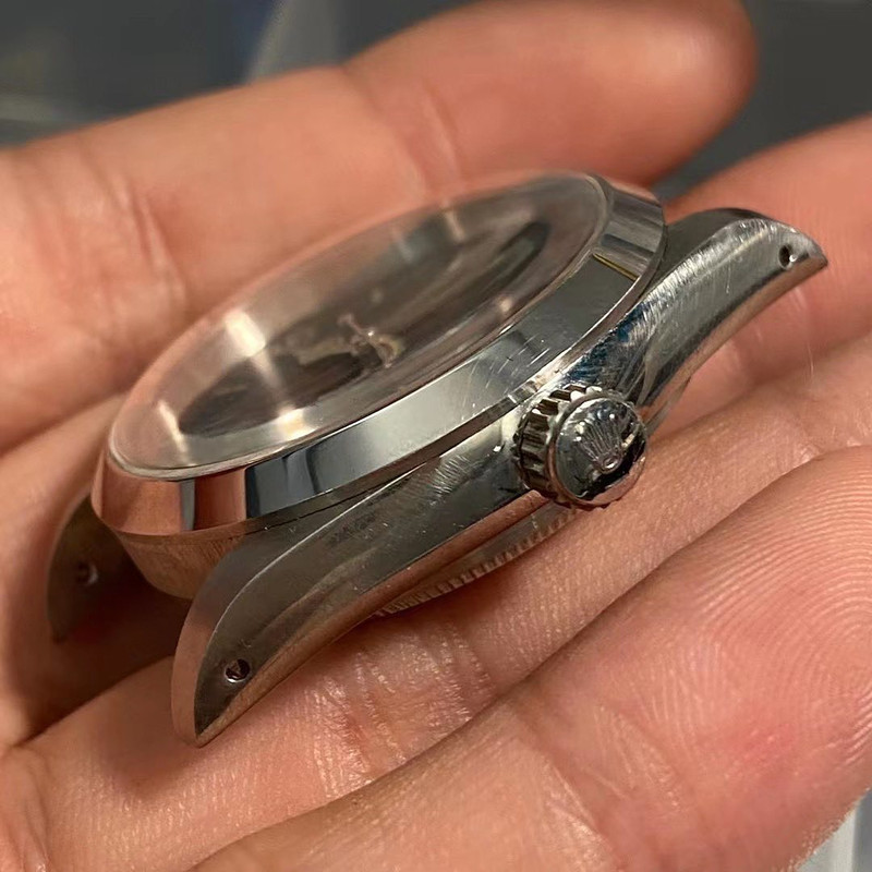

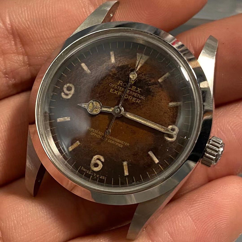

found this on instagram. dude posted it saying the case is from vietnam. but the thick crown and high bezel from raffles gave it away...
anyway the tropical look on it looks fantastic!
and it looks like the new tropical gilt dial from raffles.... sounds like a new project for this year apart from my incoming t21 crystal
