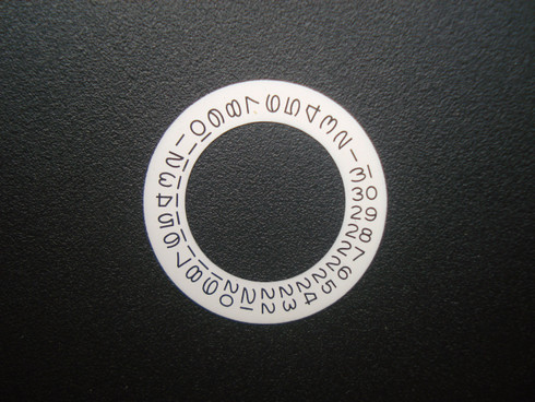

Will the date wheel fit the gen spec date window position if replaced with this?
And it's not important, but I'm curious if the cyclops of the raffles case won't deviate too much from the gen date window position.
matzemedia
22/4/21
474
1,062
As far as I understand: no. The cyclops of the crystal is for the eta position. But I read the description several times and I'am not 100% sure. At the picture the cyclops looks far outside.
I may be wrong, but I THOUGHT that dial apertures and cyclops locations were for the gen position, which is why the DWO are usually offset a millimeter or so to align with the gen position.
I may be understanding this, however. So far, my only builds have been Explorers and Subs without dates. This and a 1680 are going to be my first attempt at DWOs.
