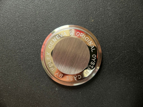

I have a special request. as I do not have a case in hand.
Can someone with a raffles gmt case try and fit a 36mm raffles explorer case back to the mid case?
I am thinking this may also be an alternative for Tudor Subs as well
Raffles offers this case back for a tudor on their 36mm case backs.
It wont fit his submariner cases and there is no actual 36mm tudor that woudl have these engravings.
However I thought if by chance this case back fits the gmt mid case he offers, then we have the beginnings of a gen spec 9401 /94110 build . With Viet Dials, and bezel assemblies , this could be promising. After a lot of crown guard work, that is....
someone give me the good news!!
I've been wondering the same thing. If a suitable case back can be found, making a '1655' out of the Raff GMT might case not be too hard.
