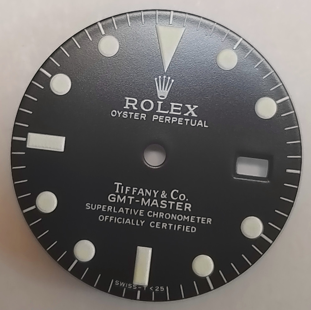

new gmt master dials from raffles just dropped
They look pretty good and have a nice 3Dimensionality to them... have to dig trough some research later if the lettering lines up. THis could be a good choice though i could live without the T&Co. too. Still have a milk case that i debated to sell but it seems we are in the building business again :)
