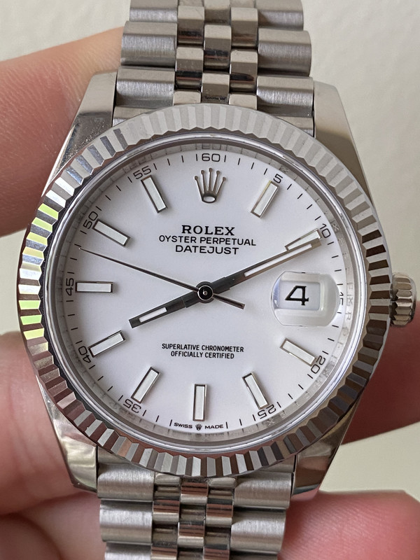

The white dial looks like a joke, compared to gen. I had a gen white dial, and I recall its nice and glossy white color with crisp lettering (see pics). The VSF dial has way too bold lettering IMO and not such a nicely white shine/glow. Looks like two different worlds, not even mentioning the clear difference of white gold indicies on white surface, what seems more obvious than on other dial colors.

The case shape on on the white dial was not as precise as the case on the blue dial (later batch). However, none of both is perfect either... But don’t worry, no rep case is perfect.

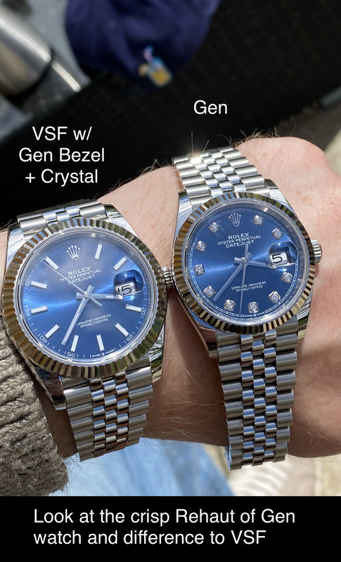

Rehaut
The rehaut is nice compared to other makers, like GMF and ARF, but it’s still not like gen. I noticed on all of my gen watches, that once I like to take a picture of the dial, regardless which angle I’m using, I can always see the rehaut clearly on the pics. While on the reps you always have to try to capture some special angle with special lightning to make the rehaut visible. Look at the pics compared to a gen watch and judge yourself.

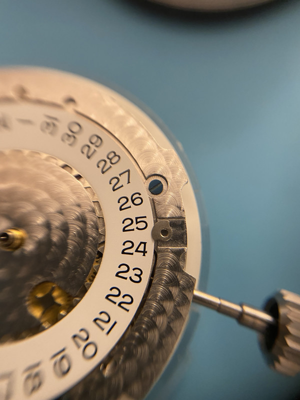

Movement
What shall I say, the Clone VS3235 movement is insane. You have to know, I’m not a fan of the gen 3235 movement. The movement was one of the the reasons, why I sold my gen Datejust a while ago. One of the most annoying things is the rotor noise, the 3235s causes. This is related to its ball bearing rotor construction, while 3135 used jewel based rotor construction, which was smooth and quiet. I simply can’t wear a 10k+ watch that sounds like a cheap ETA fake. Back in time I went into an AD and shaked all their stock watches with new 3235, like SeaDweller, other Datejust, GMT etc. All of them sounded simply cheap and AD thought I’m crazy. Anyway, since then I tried to avoid gen models with new 3235 movement. There is more details on the 3235 which I don’t like, however, if it comes to rep and Franken business, I have to admit that this is a masterpiece. It runs as stable as my gens do, it has 3 days of power reserve, close to zero seconds deviation (probably 2-3 seconds) even without a service and it winds pretty smooth and has smooth time setting as well. 1000% better feeling than ETA based builds achieve (IMO) and ETA has also little rotor noise. So fine for me. But the biggest advantage is, you can easily mount gen hands (without doing a complicated pinion mod), you can easily mount a gen dial, (without creating extra movement rings) and you can install a gen 3235 date disc (without glueing an overlay or stuff like that). This alone makes it worth buying a VSF DJ because for the price of previous modding costs, you can nearly get a full watch where you can install all parts on your own. That’s so great and I will never give these away.
Here is some pics of the movement compared to my gen movement.

The VSF crystals are nice, no doubt. And many of you think, that it’s not worth buying a gen crystal anymore. But I can tell you, it’s still not gen and wrong. Magnification seems a bit above 2.5 (this is what Rolex uses). Means, date looks always slightly bigger than on gen. Not that obvious, but visible once you have a gen next to it. If you install a lower gasket, you might be able to solve but then this might cause a wrong bezel vs crystal heights. However, biggest issue IMO is the blurred lense once you look at the date from a sharp angle. I figured out, that this was not only the case on both of my VSF Datejusts, but also on my VSF Hulk. So I guess it’s a „normal“ VSF thing. Took some pics so you can see comparison to gen. Gen has a clear view, even from a sharp angle. VSF has blurred lines.
Ok, enough about the pros and cons of VSF and let’s start with my Franken:
As you have seen from the pics above, I did already mount the gen bezel with gen crystal for trial purposes on my blue 126300. Hence, I won’t go into further details of gen bezel and crystal because the differences should be obvious now.

Next was the Date Disc. Again, one more thing I don’t like on the new 3235s. With the old 3135 movements, there was one screw that was adjustable to lift the date disc easily and remove. However, the new 3235 plate pretends to have such an adjustable part (see pics) but in fact you can’t move it. Thus, you have to lift the date disc and press the it through the upper left corner which will bent it slightly to fit through. The new one has then to be pressed in again in the same way. This construction is definitely made to cause a lot of scratches in the future and I don’t understand why Rolex changed it like that… Anyway, once installed the gen date disc fits perfectly.

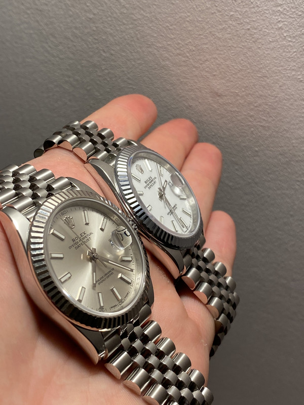

And some more comparison pics against my stock VSF white dial 126334 with ARF fixed links only.
