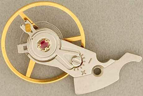

1) Shock housing of the ETA has three recesses that are 120 degrees apart. 2) The regulator markings have an engraved vee appearance to them almost like a furrow in a field.
3) The shock spring on the ruby has sharper points than on the clone.

1) Shock housing of the clone has one single recess.
2) The regulator markings have a cast square appearance to them.
3) The shock spring on the ruby has more rounded points than on the genuine ETA.
