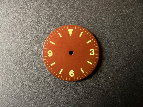

I have had this idea for a minuite but wanted to see what some of the dial makers in here think about it.
raffles now offers sterile dials. My thought is to buy a few of them. do some tropical air brush work on the dial and then apply a modified decal dial over top of the air brush work to create a unique tropical dial
Some of you have been following my thread on tropical dials and the main issue I have , even with using candy paints is that it is difficult to do without overspray on the text.
example of my tropical dial air brush work.
cool on the wrist but sketch under macro.
IF I was better at lume. I would just do a negative relief gilt dial , apply the decal. air brush the tropical effect and then wash off the decal to reveal the neg gilt and then clear and lume. but I wonder how difficult it would be to wash away the decal and not wash away the paint. or will the paint prevent the decal stencil from washing off.
did a test colour sample on a blank raffles sent to me when we were developing the tropical dials.
or an easier method would be : I would start with blanks but my lume work isnt pro so buying this dial with the lume done seems ideal.
buy a few of these unbranded dials
air brush unique tropical fades onto the dial surface.
apply gilt print decal dial (film or filmless ) over top the paint work.
then you get a clean looking tropical dial without overspray onto the print.
can you get a nice gold color print on a decal ? I know its not neg relief but we can have it all , can we.
as long as the paint on the decal was similar or close to the paint color used on the dial for the chapter ring markers.
My call out to any dial maker out there... who would be interested in working together on this.
if you can print off a sheet of gold print decals for the explorer I will buy some of these unbranded dials, air brush fades into them and send them to you so you can print and apply the decal on top of the dial. I will pay for the materials, prints and time , and of course you get a tropical dial for your troubles. who doesn't want to add a tropical dial explorer to their collection??
HMU if you are interested or we can group work this project and see what we come up with.
feedback welcome

This must be my favorite thread, as there's nothing more desirable than a nice gilt dial for vintage lovers.
But unfortunately, you won't achieve an impressive gilt with foil. It would create a positive relief, and if you applied a thick enough clear to make the surface flat enough so no relief exists, the extra thick clear coat won't make the metallic parts "pop" more. It's really the slightly imperfect reflections of actual brass against the contrasting background that create the warm, holographic effect. A negative relief enhances it that much more.
Abandon the foil idea but please join in on the never ending quest for a perfect gilt!
Your weathering techniques are very impressive, and those subtleties always carry over to somewhat similar situations. But once you fall into the gilt rabbit hole, you'll never be satisfied by foil or metallic paint.
What about Raffles making some brass blanks with a white base for lume already applied? Just a thin coat of industrial epoxy or UV solder mask so it's much more resistant to chemicals when you need reapply the toner transfer for a 3rd try?

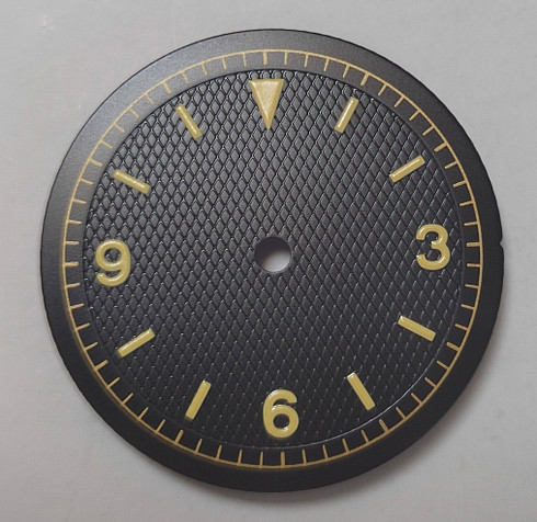

I love a challenge, trying to see if there's a good gold foil decal paper out there.
Although laser engraving or pad printing might be better.
Just put gold leaf onto the dial before you put your decal on the dial, Bart Cordell was doing it and it's pretty cheap to do.
