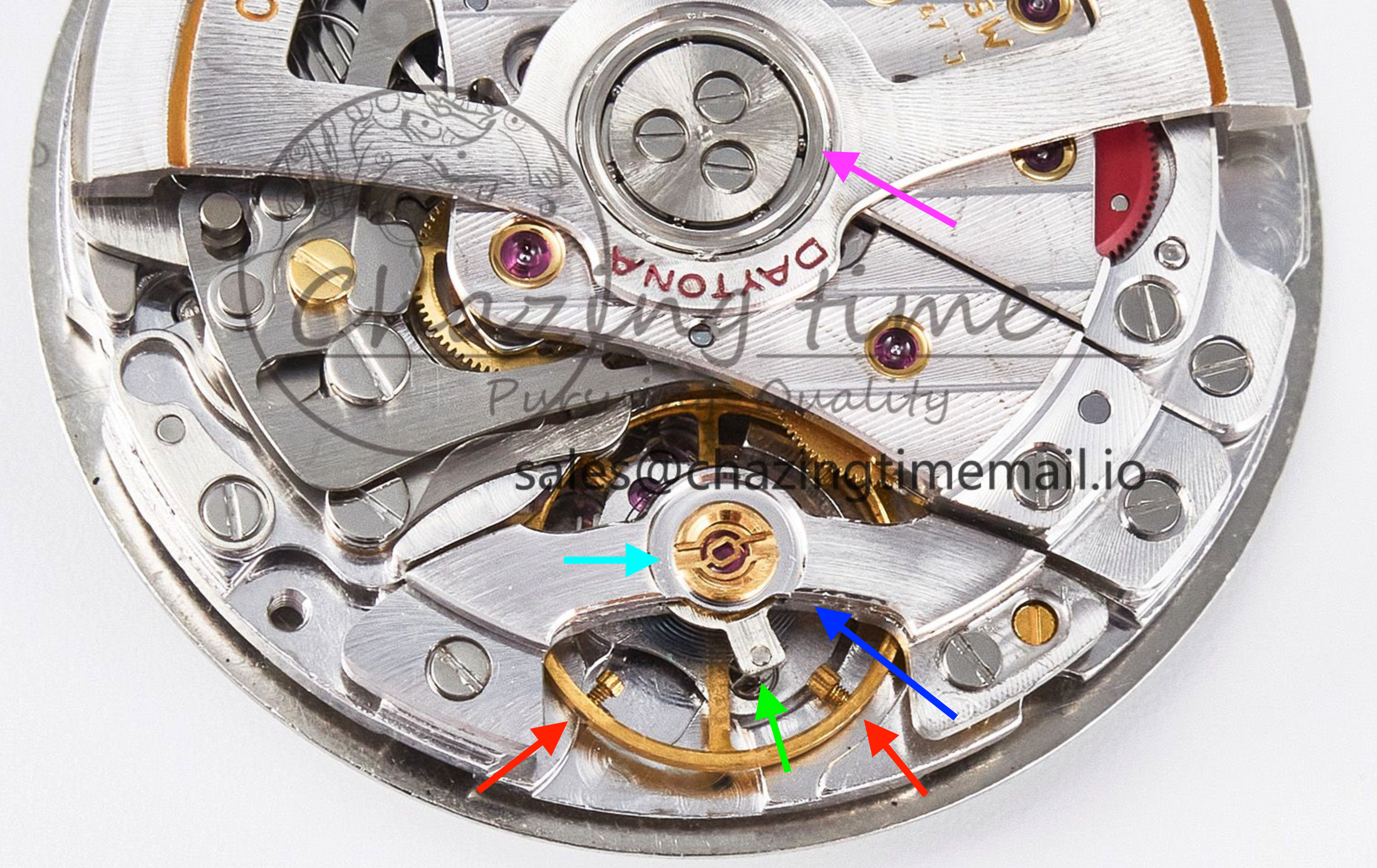

Shanghai 4130
In June 2023 Shanghai Movement factory released a 4130 clone movement. As of January 2024 there is no long term reliability information about the SH4130 but there were some initial issues with chronograph hands not resetting properly. This movement is mostly a true clone, although the balance bridge, pallet fork, and escape wheel are not gen spec (it's possible that other parts are non-gen spec too).

7750
This is an Asian clone of an ETA 7750 movement. The reason that this movement isn’t great for the Daytona is because it is thicker than the 4130 movement, so the movement is often slimmed down (and thus made less reliable) to fit inside a 12.4mm thick Daytona case. Furthermore, the Daytona has its small seconds at 6 o’clock, but this is not the default position for the small seconds complication on the 7750 movement; various additional wheels need to be added to the top of the 7750 movement to get everything into the correct position. This complication adds stress to the movement and reduces reliability. With the clone 4130 widely available, it's a good idea to avoid Daytonas with the 7750 movement.
The 7750 can be identified by the single screw securing the rotor (red arrow), and the balance cock (green arrow) vs. the balance bridge see on the 4130.
