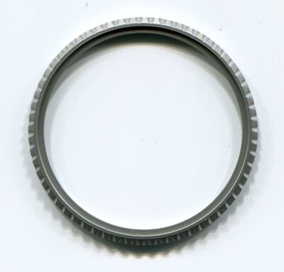

I purchased a clark bezel.
I will see when I get it next week.
I purchased that before. It was perfect. I polished as it came “dull”. Came out great.
Reactions: trash3939
Would it be possible to go with buffing only the surface?
I will try it when it arrives next week.
