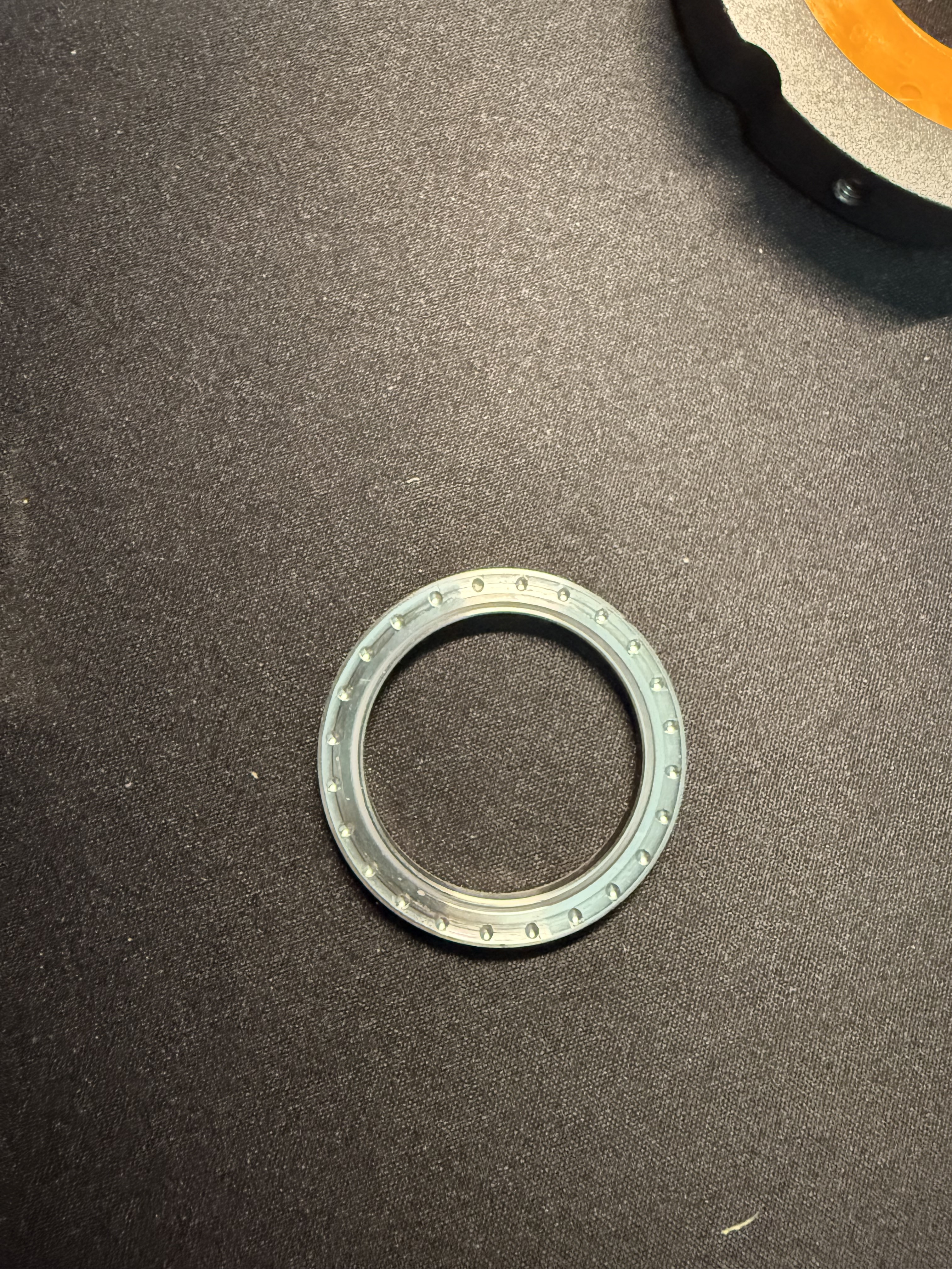

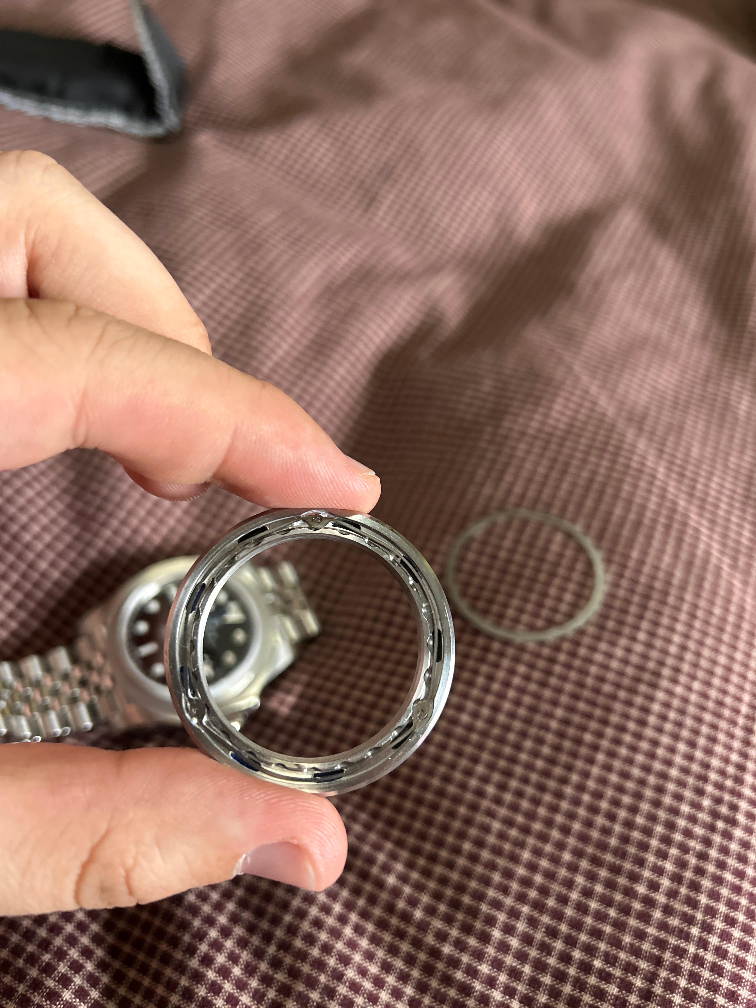

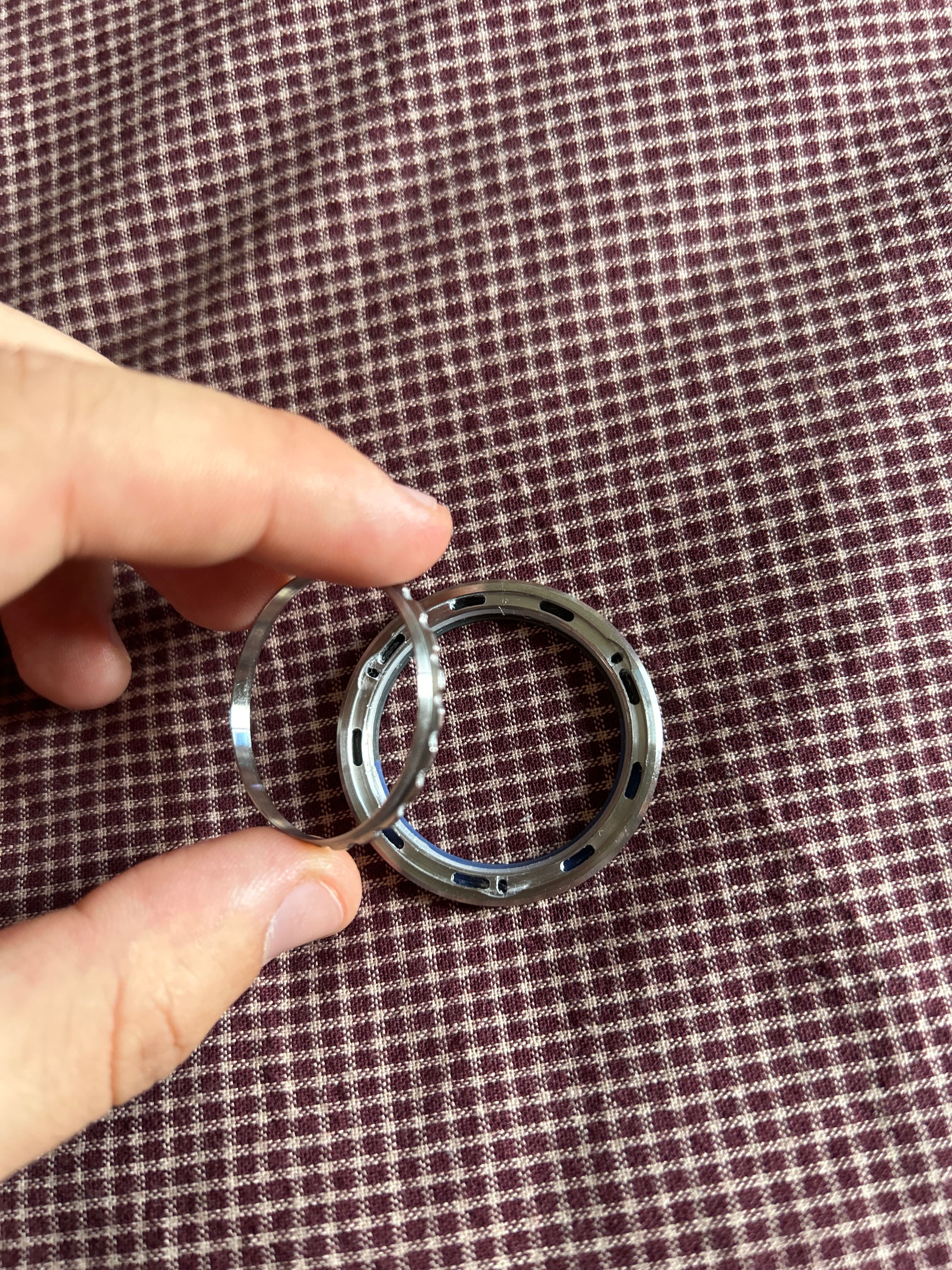

Hello, I have made a mistake. I changed the bezel gasket for another one that fit, this one was too thick and I had a hard time fitting it into the watch case. Once in the box, seeing that it was almost impossible for me to crack the bezel, I took it out again... and the piece with the slots that is above the glass joint got stuck under pressure and now I don't know how to separate it from the bezel. The only thing that has occurred to me is to take off the ceramic and from there try to use force even if the bezel joint weighs on me, I have more. I have put the entire bezel in hot water and then used the hairdryer but the ceramic does not come off, I am going to try boiling water and then hairdryer. Any advice? xd . I put photos. thanks in advance 🙏🏼
Skrewdriver from underneath to remove insert
Man, I tried yesterday with the tweezers tool for the parts of the watch movement, I didn't care if they broke the tips and it didn't work, I read your message and I took the thinnest link screwdriver I have and pried it...
Thanks a lot man, you save me 🙏🏼
Great to hear it worked:)

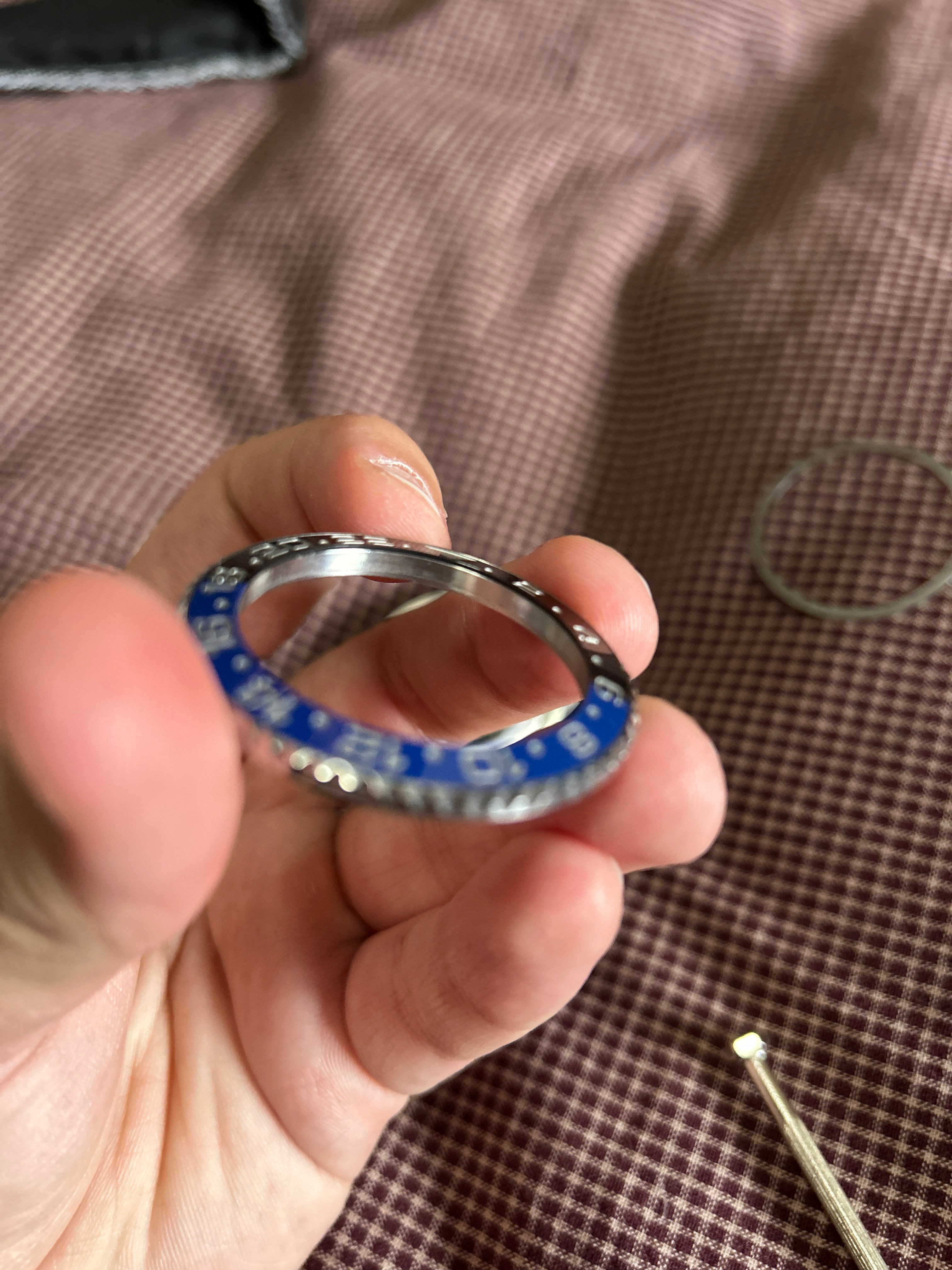

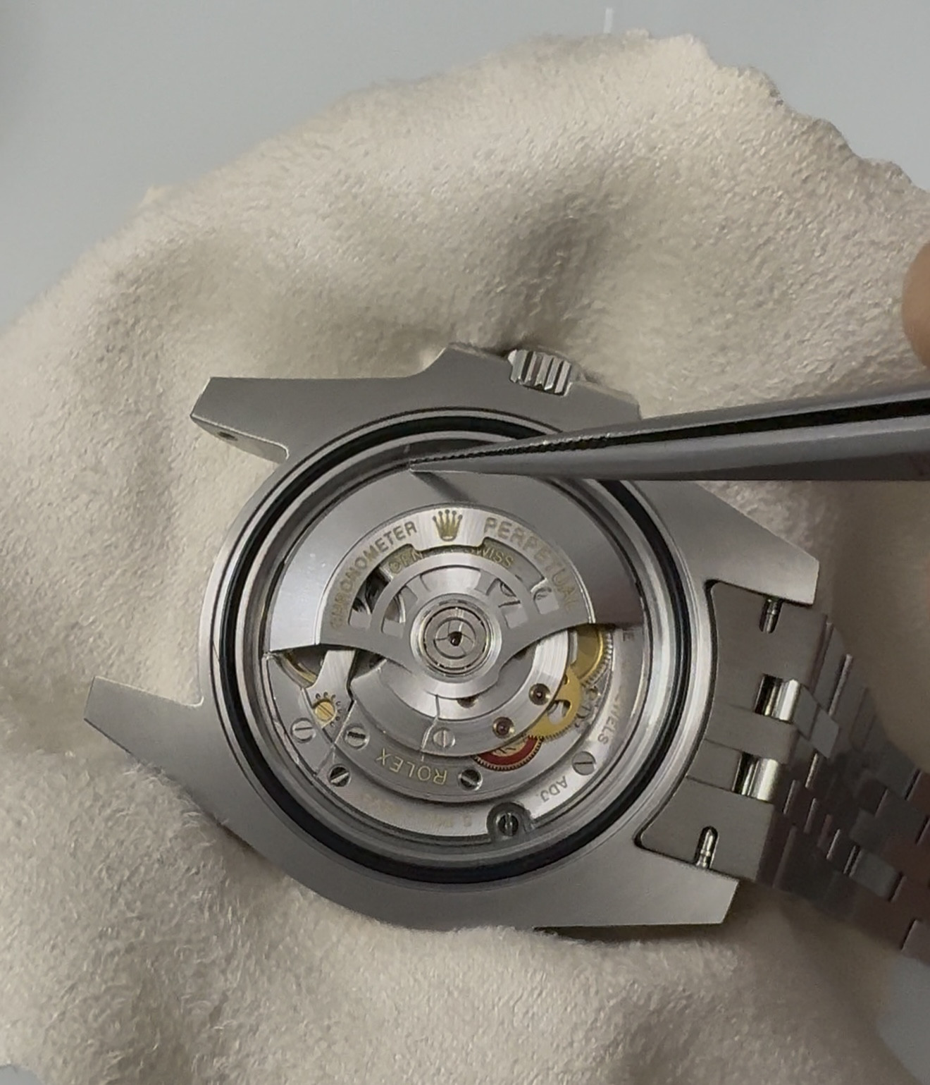

Hello everyone I have a problem I have a clean Pepsi v 3 appeno I thought so until I took off the bezel because the ceramic bezel came out a little from the steel bezel and here I found the surprise I state that the movement inside is very well done the ci turino and ok the ceramic bezel is not of perfect colour............ I'll put some photos to let you see what I'm talking about
<img src="https://images.clickpix.org/2OFbaX.jpeg" alt="2OFbaX.jpeg" border="0">
<img src="https://images.clickpix.org/2OFxpi.jpeg" alt="2OFxpi.jpeg" border="0">
You got a "VSF", not a CLEAN GMT Master. You should have stickend to Trusted Dealer of RWI to get what you pay for.
Although its a good watch, you got the not-genspec bezel type and mostly important not the DanDong 3285 movement but the VR3186.

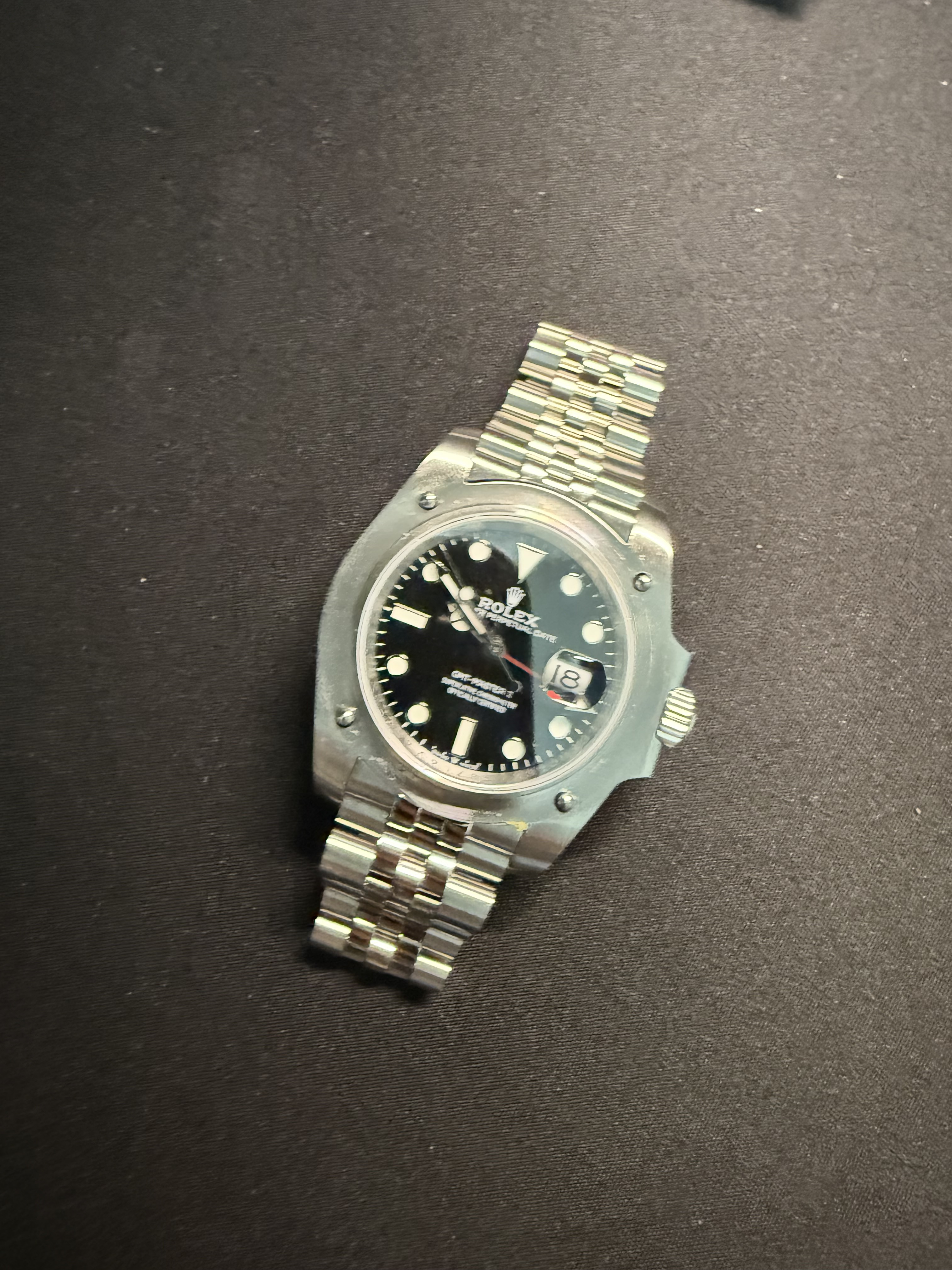

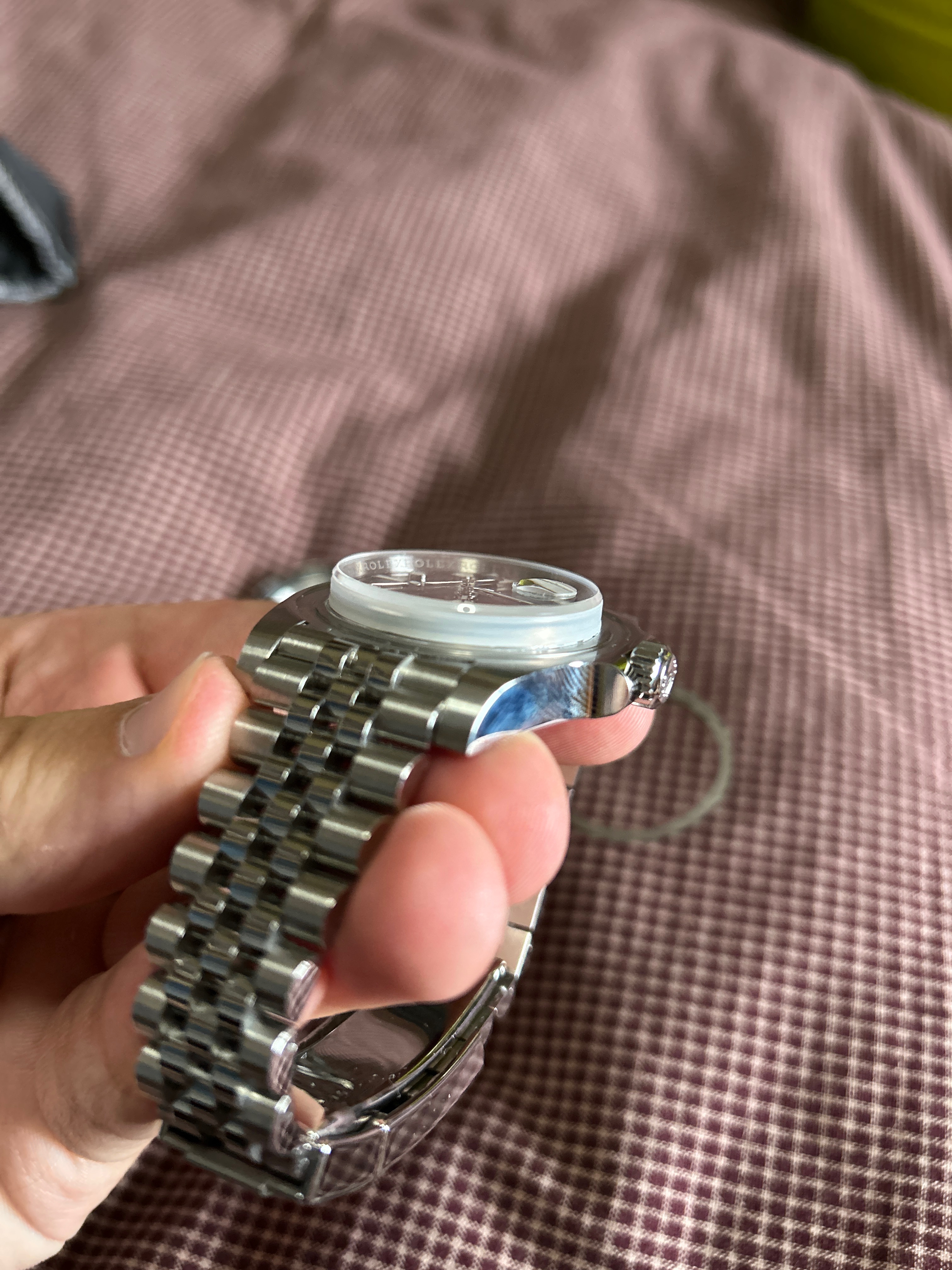

I'm not even sure it's vsf when I took off the bezel and the glass also came off and I put it back just by pushing it with my fingers and the bezel is strange it seems lower I'm attaching these two photos for you to see tonight I'll do more the movement it seems to be the clean one mhaa

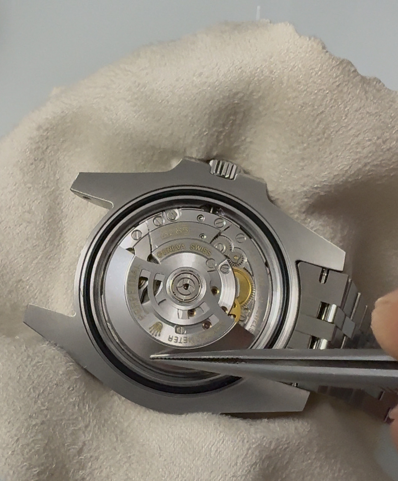

I dont see the balance wheel, you cover it. It could also be a VR3285.
@KJ2020 maybe can help. AFAIK the "VSF" (GSC) is the only gmt master with this bezel.
A pic showing the balance assembly completely visible is always best when trying to ID a movement. However as @derjenigewelcher stated, VSF (GSF) is the only factory using the Rollerball bezel.
A different type of rep GMT bezel - The Rollerball!
That is an SH/VR3285 - you can tell by the triangular hole in the rotor screw head, and the tiny setting wheel pivot in the train bridge. This is a hybrid movement, the setting wheel is a carryover from the 3186 part.
The DD3285 and gen have a different setting wheel configuration with a much larger gear post visible through the hole in the train bridge. See pic of gen below.
So apparently VSF has begun using the SH/VR3285 despite TD ads still listing the VR3186. Your watch is not from CLEAN and only CLEAN uses the best available DD3285.

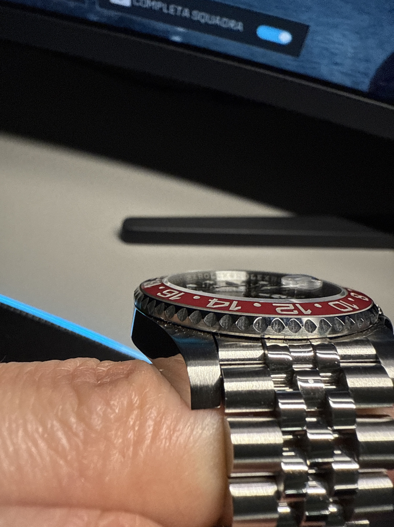

Okk so you say it's a VSF but now I have a problem I should change the ring for he this one that mounts now is strange I mean it's lower in fact the ceramic bezel protrudes as you can see from the previously posted photo where can I find it ?? And which one is compatible ?? Thank you...
