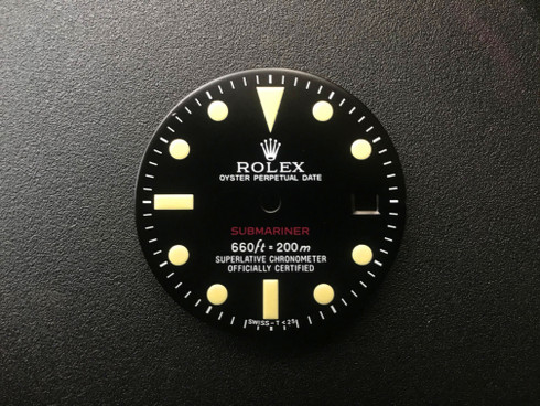

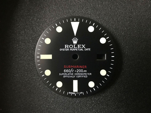

Good question and I can provide some insight here. Let's take a look at the 1680 specifically as an example just for fun.
What's the difference between those two? Well, that first one with the more yellow lume has a date window spaced to be compatible with a 2824 or NH35 movement. The second one is more interesting, and has a gen date wheel position. You do have to install a gen datewheel over the top of your stock datewheel with hypo cement or dial dots (seriously dial dots actually work fine). Now, you do have to make sure your magnifier is correct on the crystal, which may mean getting a gen spec crystal or one that works with an NH or 2824 movement. Case in point, the following image. Guess which is gen spec, and which is the non-gen spec date position? Both use "vintage" style silver datewheels. The open 6/9 is a bit of a giveaway however!
What crystal you pick depends completely on which datewheel position you pick! The NH one is simply a modified Tiger Concepts watch with the crystal in position for the NH movement (non-gen spec date window position).
