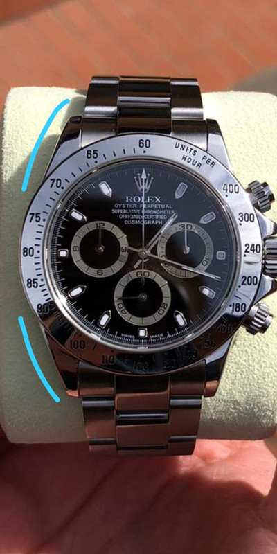

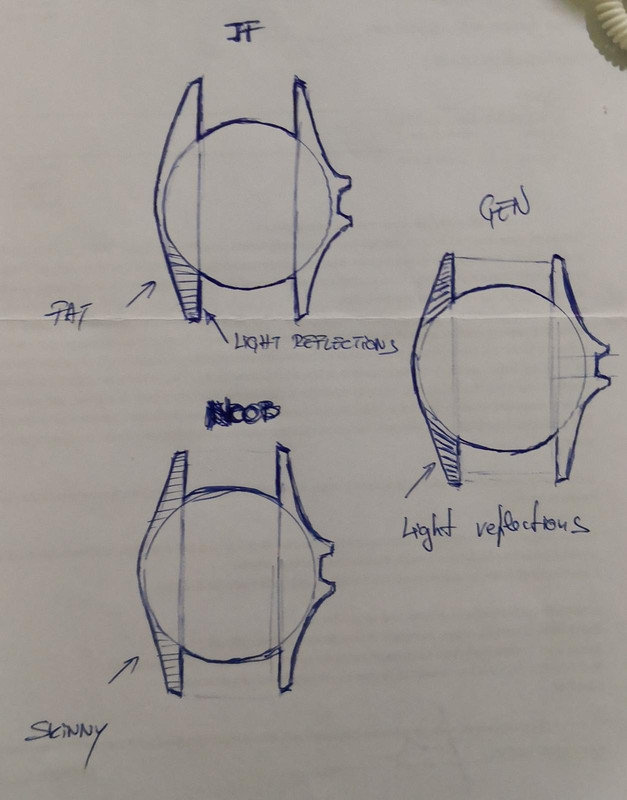

Swiss Maiden Here are all the things wrong about noob daytonas regarding case and bracelet IMO :
I've been studying daytona cases since the 7750 days. I'm not saying i'm an expert but i've seen a couple of gens and i was able to spot some very subtle differences that make the GEN a GEN.
What i mean is that when you look at a gen case or bracelet you may recognize it's gen ( premium looking and feeling ) but may fail to point out what exactly makes it feel that way .

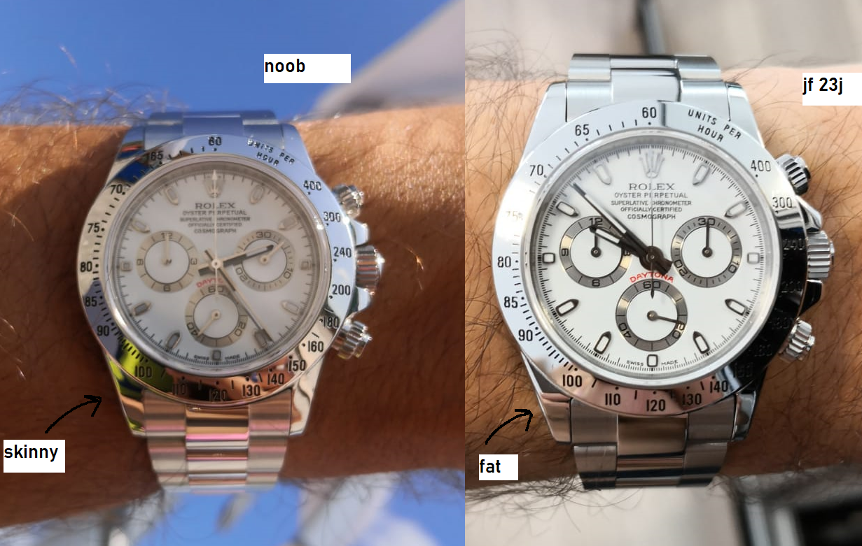

1. Lugs are wrong ( case profile is wrong as well )
Gen profile is more rounded , fatter if you will . Especially on the left side .
Now let's see the noob case , older models :
pre-order-daytona-116520-904l-ss-case-noob-1-1-best-edition-white-dial-on-904l-ss-bracelet-sa4130.jpg
See how the lugs look slimmer , less fat . I've exagerated the lines to point out what is wrong with the noob case .
Not a disaster but i can see it on every noob case i see ( at least before v3 - haven't seen that many v3 )

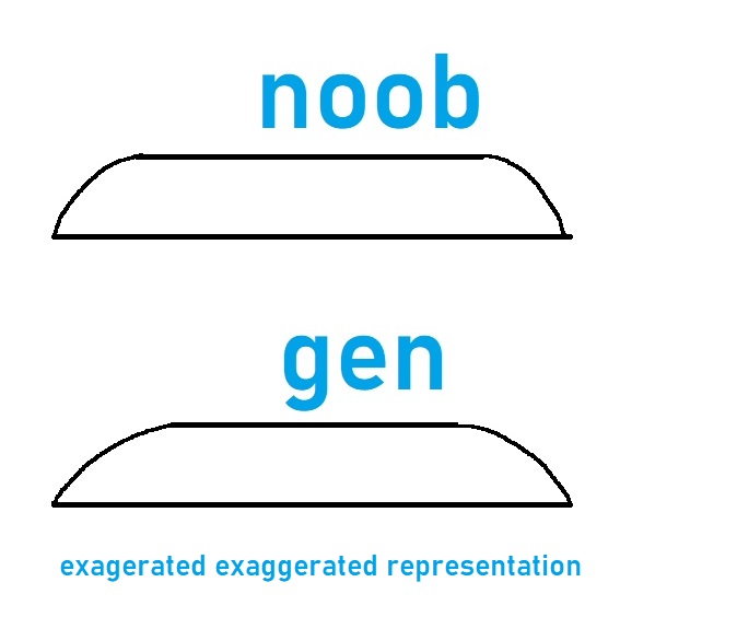

I think the domed side of the case should have been more domed if you will .
JF 23j case was the only case that almost nailed the lugs and the case domed side :

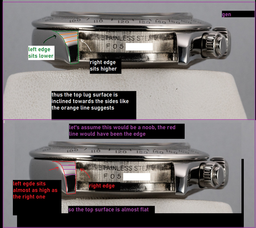

2. Lug top surface inclination .
The gen case seen from the side differs from noob very much .
This is a rough representation just for you to get the ideea.
Now this not only makes the noob look diff from when viewed from the side but it makes it reflec light diff too :

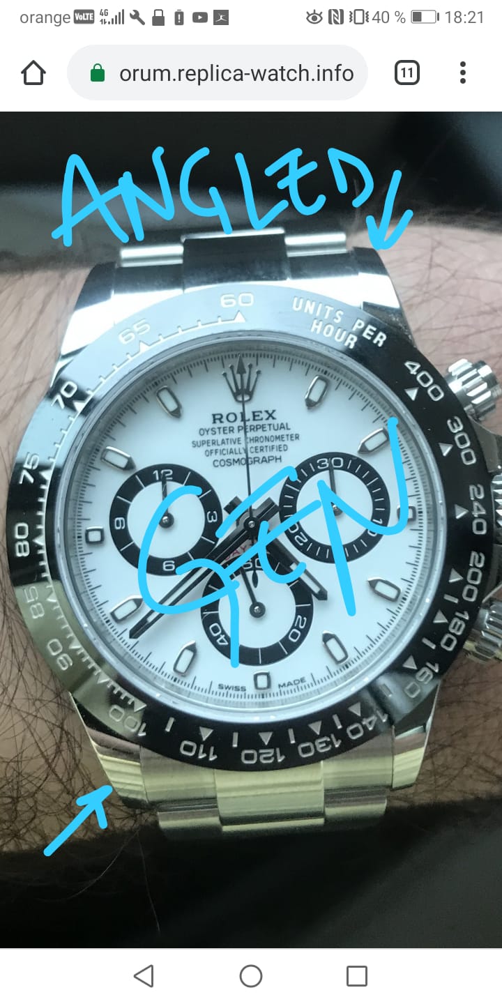

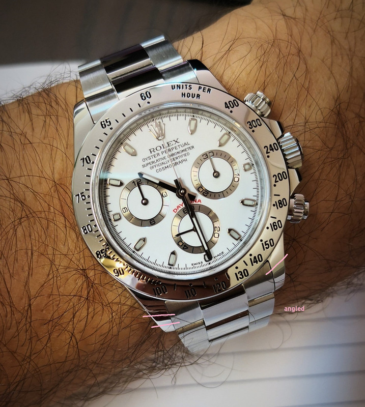

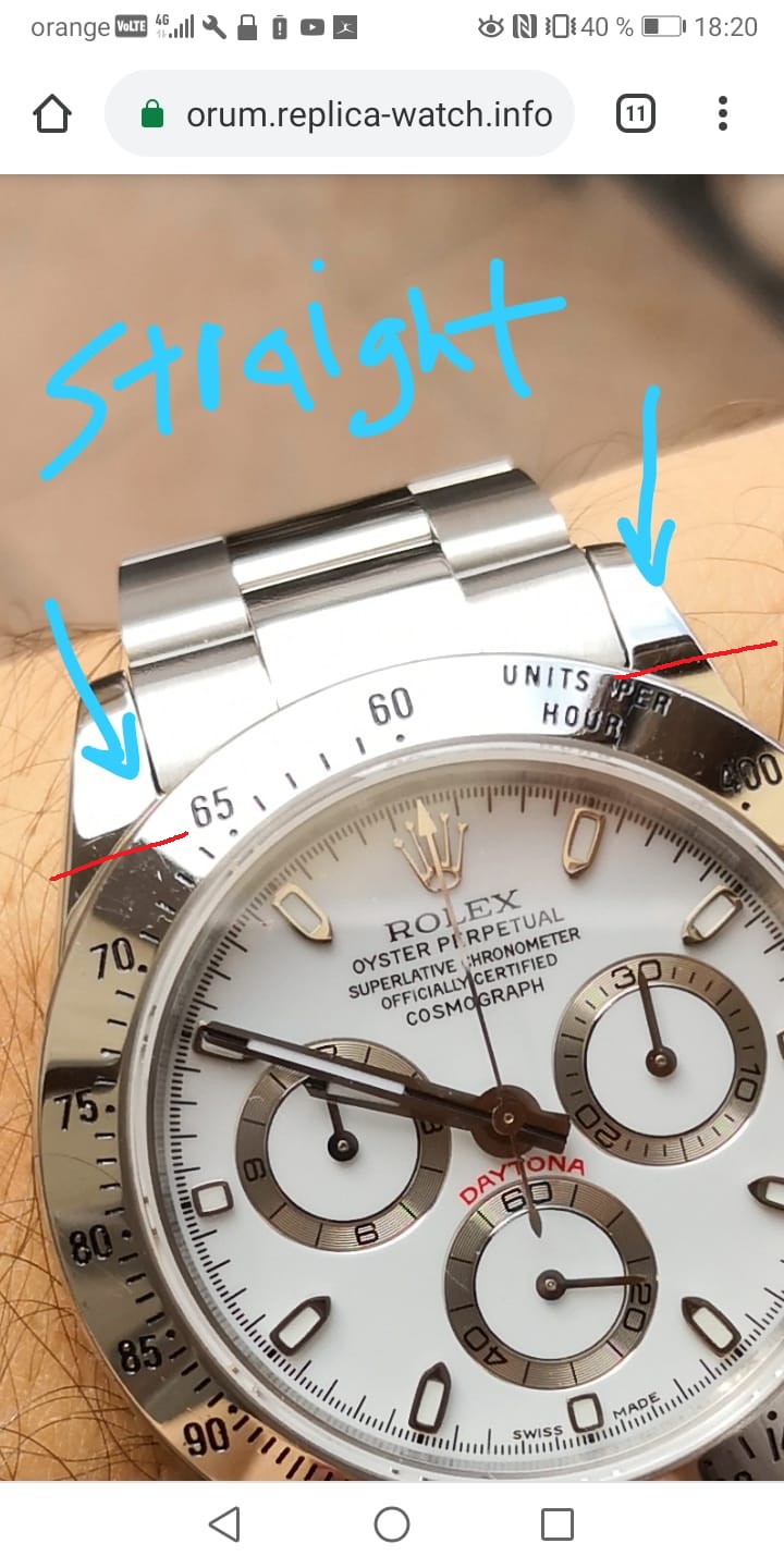

Se how the gen reflects light ? :
You can see the light is angled especially when you get near the bezel. On the new ceramic case this is more obvious than than on the older simply because rolex has managed to make the top lug surface more flat !

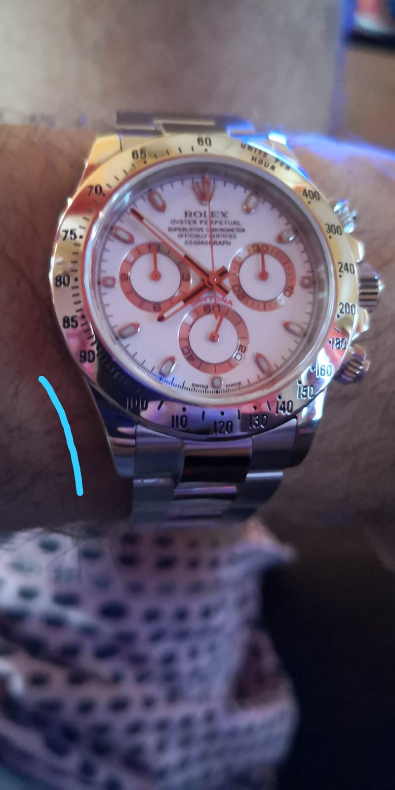

Now here is a noob case :
See how the lugs reflect images in a straight line . Not angled towards the sides like the gen has.

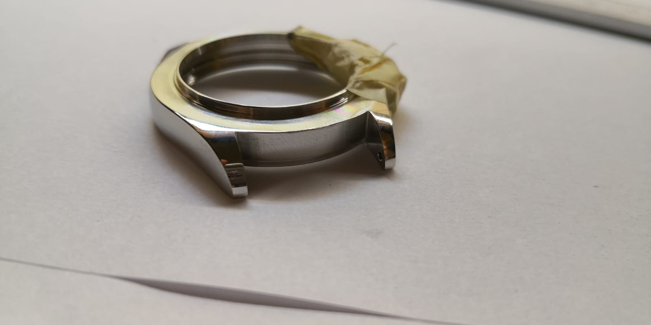

This can be corrected . Here is a noob case modded by me :
Lug top surface is flat enaugh and light is reflected in an inclined fashion similar to the gen . Lugs are still too skinny though . Because noob lacks that side belly , domed part.

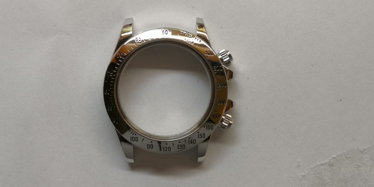

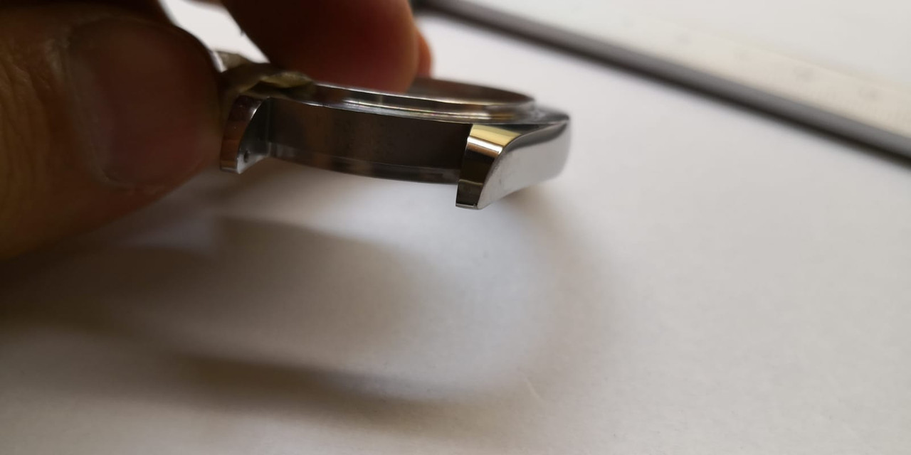

3. Lug tips :
Noob lug tips are flat , at least on my example. i don't have any older photos to proove this cause now mine is modded but here is a Jf case having the same issue :
now here is my modified noob :
if you don't belive that's how lug tips are supposed to be please feel free to check daytona videos online .

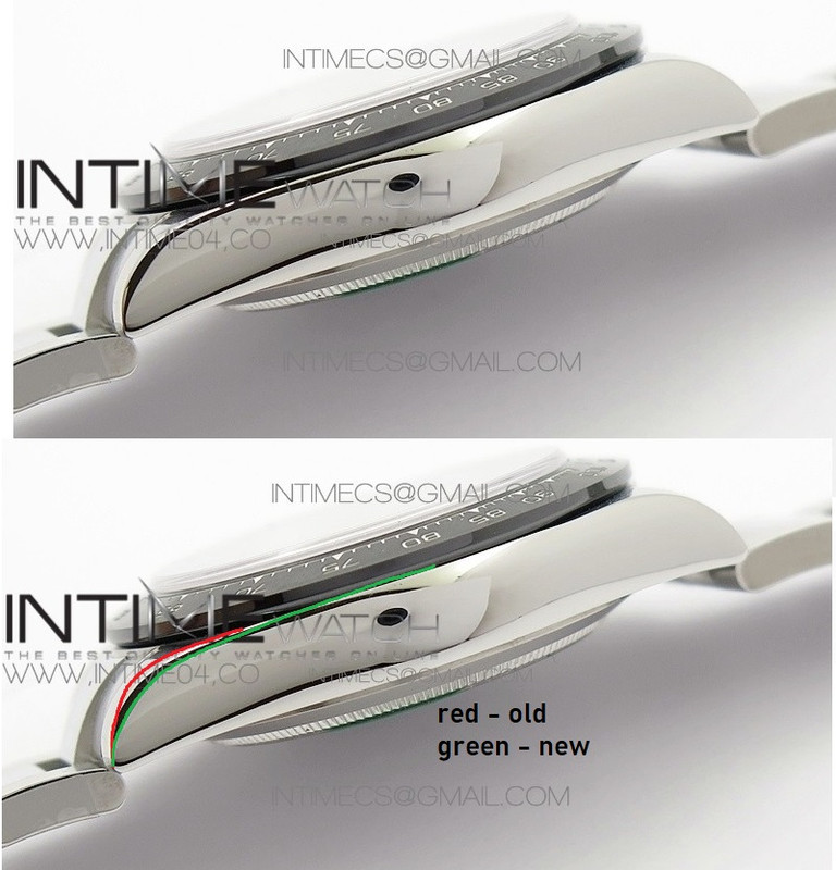

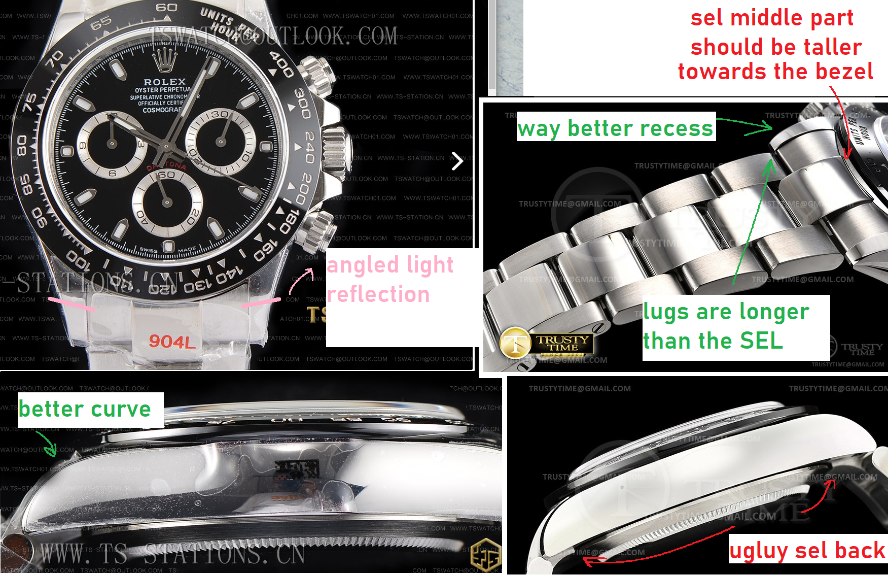

Now we come to the part where i stated that the v3 case has been impoved .
The new v3 case looks to have the side of the case more similar to the gen one . The light reflected on the lugs also appears to be more inclined especially near the bezel.
This may be a hit or miss depending on QC however. I've seen some that are not as good .
Side profile looks better :
Still wrong - lug tips :

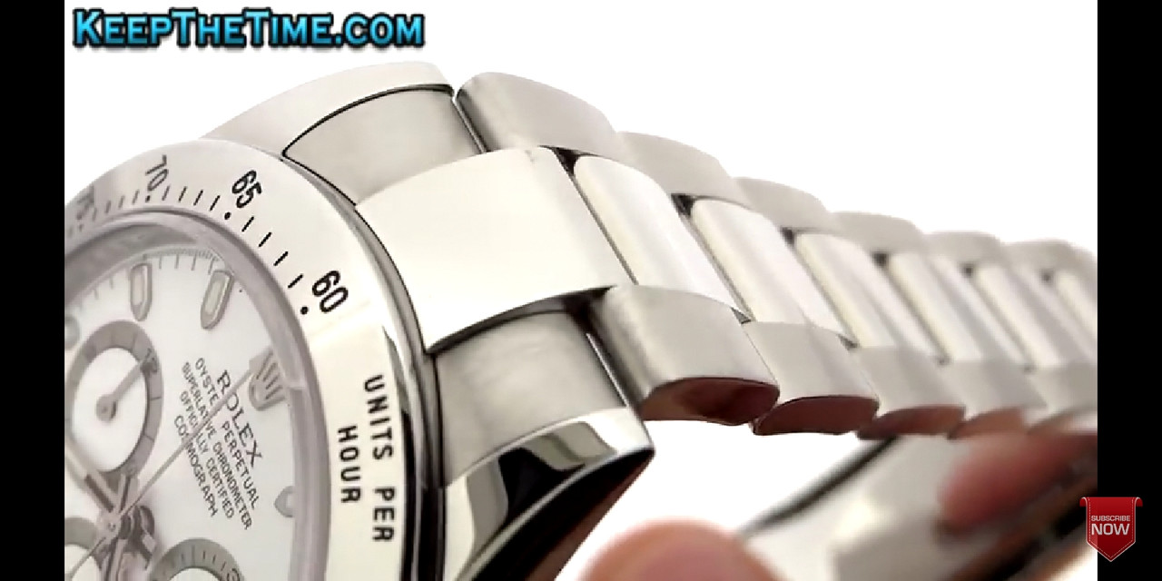

Let's move on to the bracelet.
IMO ARF is defenetly better .
Better links, better clasp , better screws, better everything .
But the SEL is a bit narrower than the noob one so it will most probably fit with gaps .

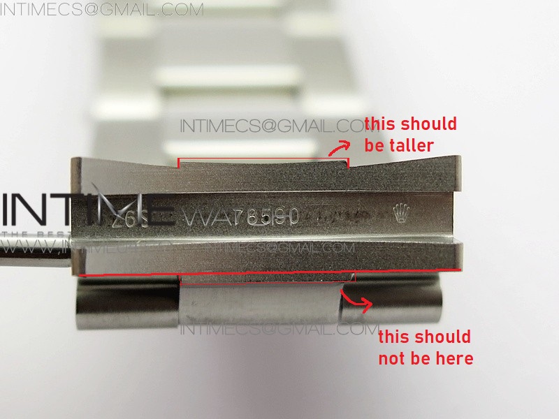

1. Noob sel has the wrong shape !!
badly buit :
2. The SEL ( 1 milled piece ) should have had a diff shape on the back .
The noob one mimics the shape of the older 3 piece endlink.
Now here is a gen SEL back :
Now here is a 3 piece old model endlink :
This old one is what noob has copied but instead of making it a 3 piece , they made it a SEL ( solid end link )

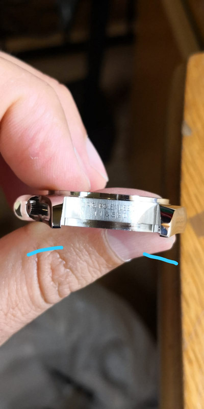

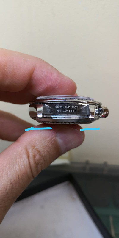

I can take some pictures with my iPhone 11 if you need some macro shot of the V3? I honestly think the lugs are thin on the V3.
please do . the lugs are still too skinny yes but the top part looks to be better . At least from the few pics i've seen.
have ordered one myself . so i should be able to properly review it once i'll have it .
Note there are 2 different watches here, I tried to get some angles on the top lugs.

I forgot to mention that the SEL recess i a big improvement on the V3.
On all older versions the SEL used to sit flush with the lugs. Or the recess was minimal .
Another minus of the older versions imo was that the sel was almost the same lenght as the lugs . Which was wrong.
On gens the sel is a tad shorter than the lugs .
now here is the v3 recess and more :
lol at a 1st glance i thought one was gen.
- lugs are still skinny yes but as i said i think the case has been improved. light reflection is much closer now

Here is a mess of pictures :)
Spatiumtemporis
7/8/16
2,597
800
watchsorz here are my comments regarding your 2 watches :
1st pic :
- minimal sel gap ! sel fitment is a dream ! on both sides and case side .
- dial coronet has defenetly been improved ! very close to the real deal !
- lugs are skinny still
- lug top surface looks better but still not perfect
2nd pic :
- sel recess - wow !
- sel middle part - too low near the bezel ! :facepalm: - not dependent on QC sadly
3rd pic :
- sel middle part too low - more obvious
- bracelet links look to be rounded - a big plus here !
- crystal height looks spot on to me
4th, 5th pic ;
- screws wish they were arf :)
- clasp is not great but not bad either :
minus - flip lock does not align with the clasp body
plus - the edges look smoother
- finger groove looks to be the correct size
6th - i wish that watch were mine :)
- links have smooth edges - confirmed , great news

gen case gap :
watch-club-rolex-cosmograph-daytona-box-and-certificate-ref-116520-year-2009-4479-5.jpg
some gen clasps :
watch-club-rolex-cosmograph-daytona-box-and-certificate-ref-116520-year-2009-4479-6.jpg
i wouldn't worry too much about that . I would have modified the fliplock to get that gap on a sub clasp :) :)
