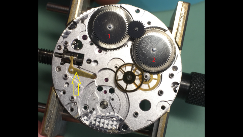

The two barrels but be carefull as they look to be the same but they aren't. It seems like one of them have no clutch system so if they are mixed up the autowinding can possibly overwind and break the mainspring or gears. I'll just be on the safe side and mark them with 1 and 2 small x-marks where it can't be seen.
The yellow arrow is the balance stop it had more of the chinese motor oil under it. Yuck!!!
