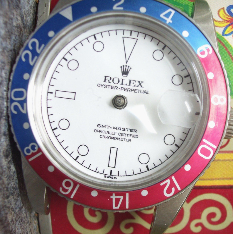

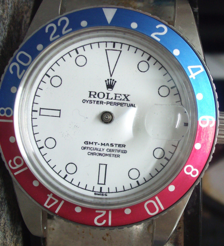

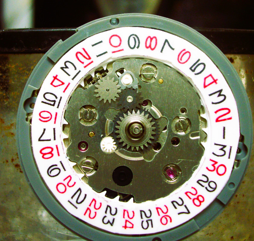

Again, thanks to everyone for the feedback! My last dial transfer was a disappointment for sure, but I tossed it a case for motivation anyway. No date wheel, no sweep hand... just needed some an extra push to stay on track. The feedback is helpful there too. Gave me a few more ideas to try out and needed the reminder to keep heat/pressure higher up on the list with toner transfer. And finally, to remind myself that a shit lume job at the start, will stay as a shit lume all the way through.
Here's a picture for everyone's amusement, but I still think it's another success for finding out what doesn't work!

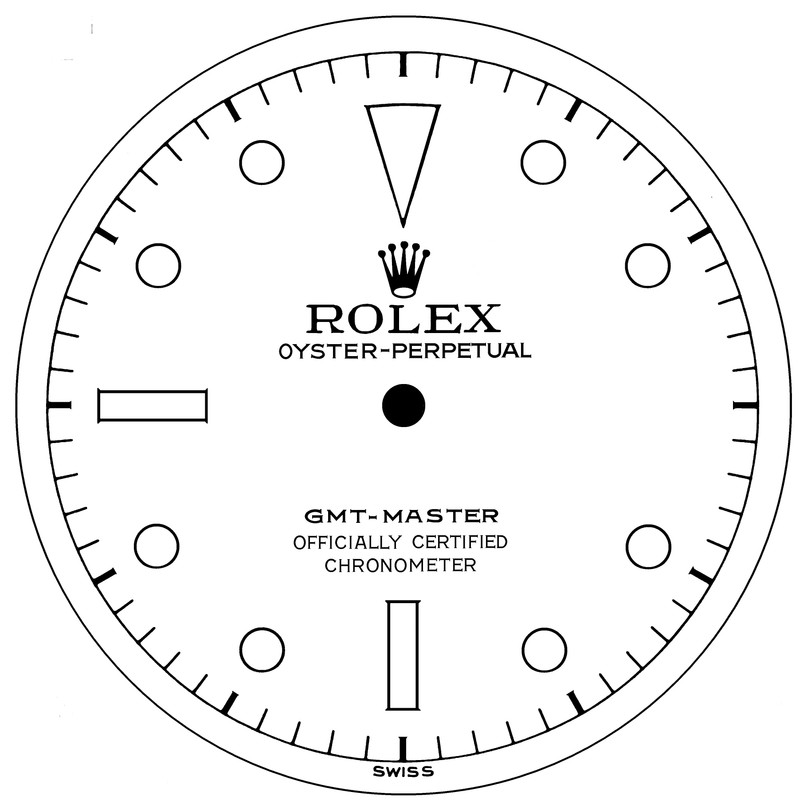

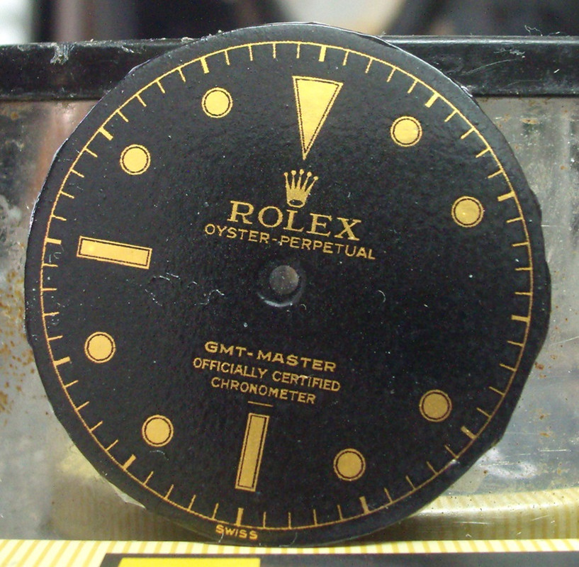

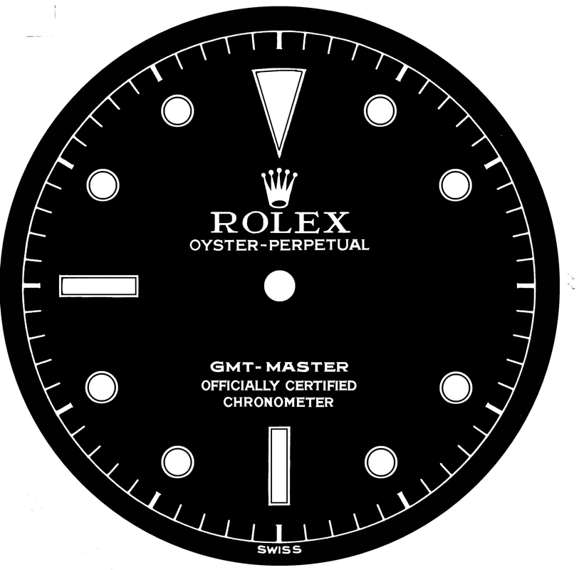

Haven't decided whether to do an albino or gilt dial for my budget 6542, so re-drew both. Would prefer the gilt, but the albino would be easier.

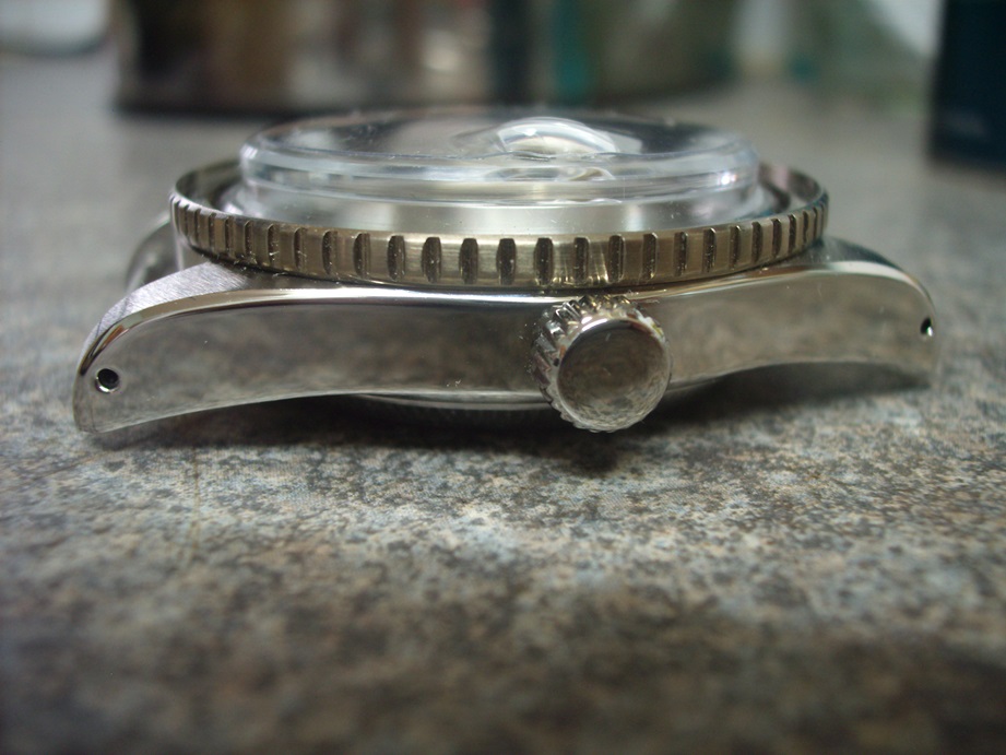

Cheapo Nh34 case turned up for the build. Need to put more of a bevelled angle on the bottom of the bezel ring. It was a 120 click uni bezel but I took the spring and pin out when I took it off to brass the ring.
38.5 wide
15 thick
47 tall
