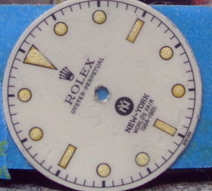

My first attempt. Not on water-slide decal paper, but another process.
I printed the design on to glossy photo paper, then cut out the dial to size and put it into a laminator pouch and put the pouch through the laminator. Once it had cooled, I peeled the laminator film from the photo paper. The ink had transferred from the paper to the to the transparent laminator film (I'm guessing it adhered to the thin layer of adhesive on the inside of the pouch.
I sprayed a layer of white rattle-can radiator enamel to a blank dial and then placed the film on the dial (using the paint as adhesive)
Once the paint had dried and the film was glued to the dial I scuffed/keyed the surface with a scotchbrite pad, then skimmed the surface with epoxy glue/resin, then sanded when dry.
I then lumed the dial (badly, also a first attempt) then lacquered over it with rattle can clear.
My printer needs it's heads aligning and some of the print is a bit fuzzy on the left.
I decided to make up a random 'commemorative' dial, and chose the NY World's Fair of '64. I also shoved a 'big crown' on the case, because that's all I had hanging around.

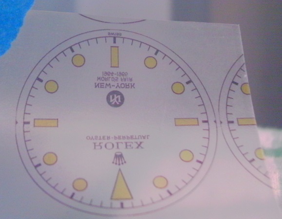

Second attempt
Same process, but with a dark print
Printed on glossy photo paper
Placed in laminator pouch
Laminated
Cut to size
Film peeled away from paper
Gold blank dial (painted with Rustoleum gold)
Clear coated when dry.
Dial then lightly dusted with Rusto gold to act as adhesive
Printed film placed on dial.
Finished dial :

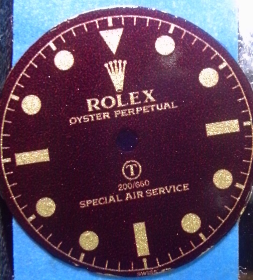

Third attempt.
Another 'doesn't actually exist IRL' one based on a Milsub.
The bleed-through from the still tacky white base gave a nice patina and blue hue, almost like radium damage.

Remade the 'World's Fair' dial, printing orange where the lume goes to see if it'd come through underneath lume to give a dated look:
Not really :
The film was also glued down with epoxy, but the black stayed black and not turn green.

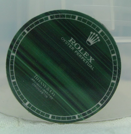

Malachite :

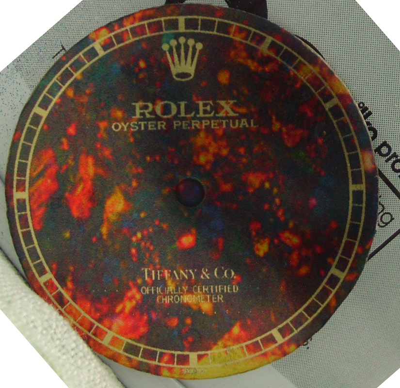

...and opal :

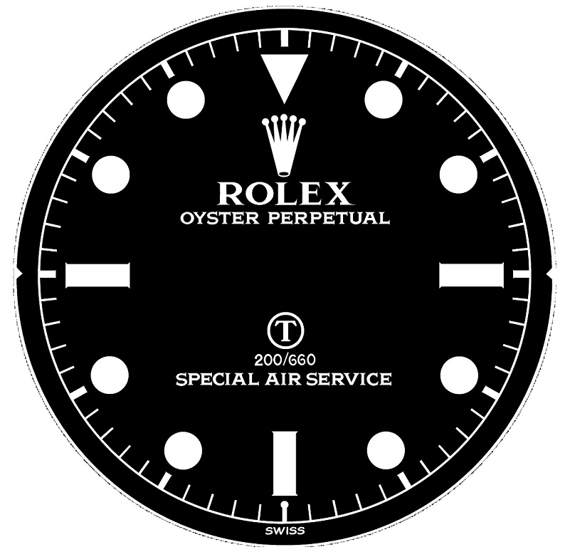

For those of you using the film free method, what make and model of laser printer are you using? What program are you printing with? Settings all around? I have been test printing on plain paper with an Adobe Illustrator file exported as a PDF and printed at the highest quality settings out of Adobe Acrobat. That has yielded the best results for me. However, the resolution does not appear to be good enough with my Brother HL-2280 DW laser printer, despite numerous attempts printing different types of image file (PDF, AI, PNG, TIF), using different programs (Illustrator, Photoshop, Acrobat), and adjusting every setting for the printer and program that I can find.
Below is an example. Early 1016 dial. Chapter ring is 26 mm across, which I believe is gen spec. Any help or advice would be greatly appreciated.

GenuineFool
I just checked the specs of your printer and it can print up to 2400/600ppp ... the 600ppi could be part of the problem as your design seems to be OK
I draw my decal dials using Illustrator >>> export files to TIFF >>> print using Photoshop on professional copier that prints up to 1200/1200ppi ... without any interpolation
I've tried to interpolate up to 2400/2400 but the results were so so
