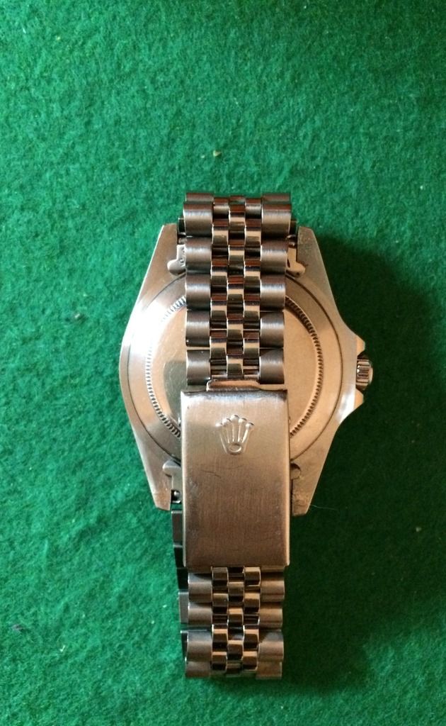

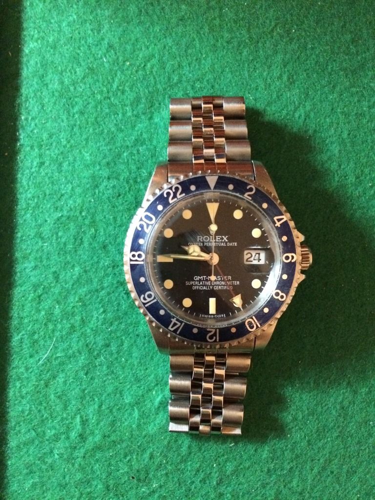

And here it is with the jubilee! I like it much better now than with the normal oyster bracelet. The bracelet came from esslinger and I put a rolex branded clasp on it! The end links fit the bars perfect and I think it completes the blueberry!

Man that combo looks good! The small inner links of the bracelet tie in with the bezel teeth and both parts look like they were made for each other. Congrats on an even better looking piece!

Thanks buddy! The bracelet is one of the nicest jubilees I've had. It wasn't to pricey either! Great quality for $28! Add the clasp and bam! Lol

Incredible deal on the jubilee!
You may also want to keep your eyes open for a vintage style clasp where the crown is forward on the front edge of the clasp. It will make it even more period correct for the vintage look you are aiming for.
