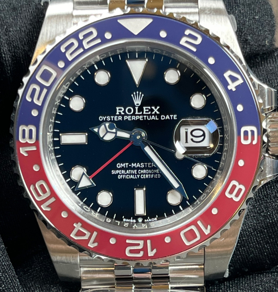

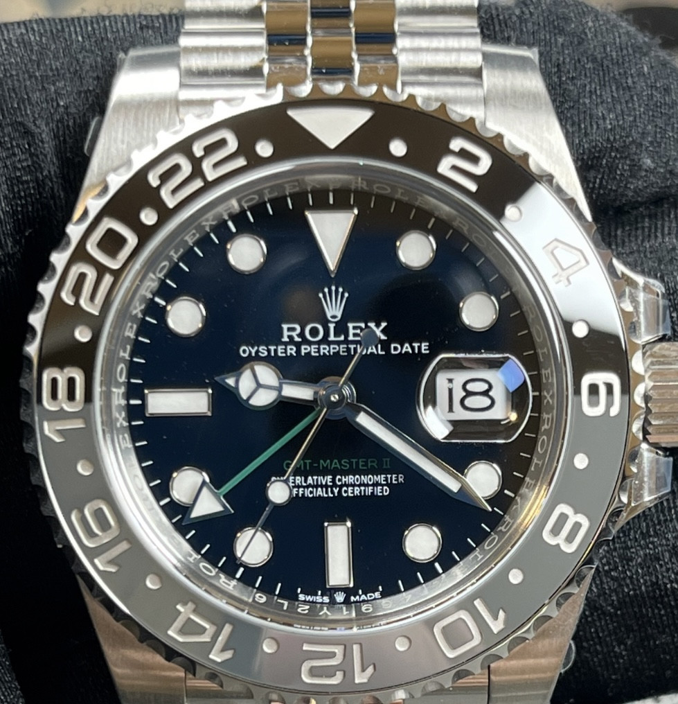

I have two GMT’s on order. I know that most of you probably doesn’t care about index/rehaut alignment but I do and both these watches have the dial/movement a bit turned anti clockwise.
Now to my question:
Is it possible to open the caseback, loosen the movement screws and turn the whole movement and dial a bit clockwise so that everything lines up?

Yes it’s possible an very easy to manage
Thank you. If I need to turn the crystal a bit to too align with the datewheel, do I need to remove the crystal first and place it correctly or can it be turned when in place?

I’m almost 100% sure it’s the dial (movement) that are shifted a bit because the crown lines up with the bezel and rehaut letters horizontally.
I don’t think it should be a problem to fix it, I have fixed small things before and opened watches but had to make sure that it was possible with this model also.
For me it doesn’t have to be perfect bc as you say some gens can be a little bit off as well and since im probably going to have to shift the crystal I will install a deep crystal instead.
I think this is the best route, the Pepsi are a gift for my dad’s birthday so I don’t have the time to wait for a new batch to arrive.
I’ll post some pictures when I get them.

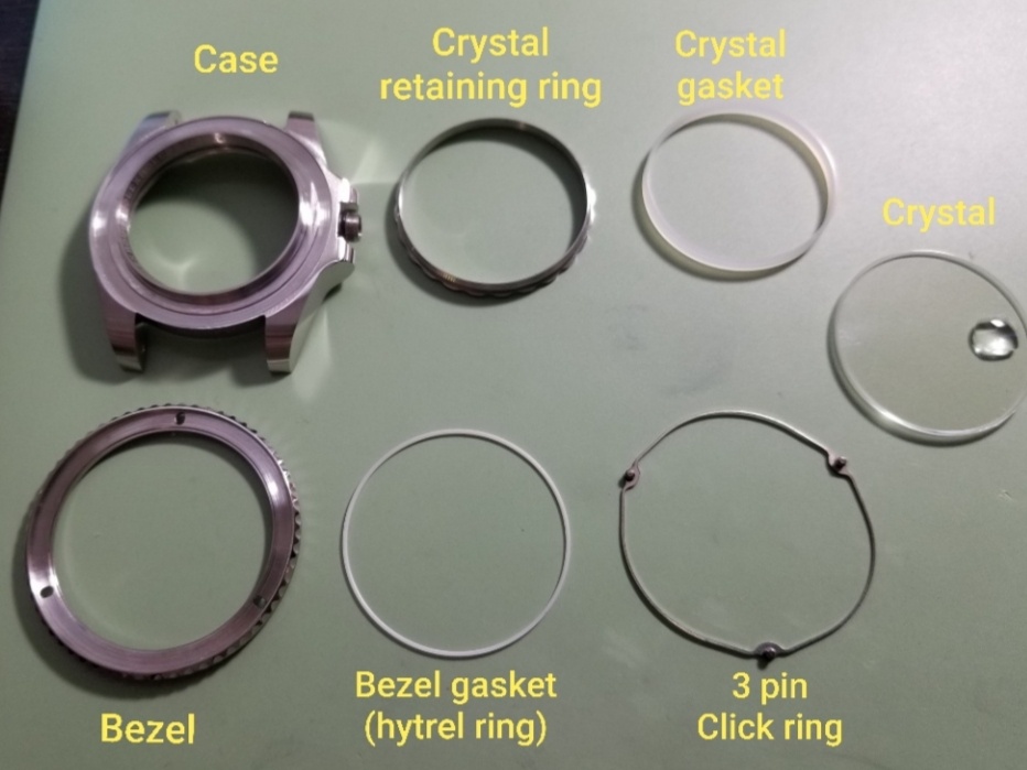

Here' are some good links I got from @KJ2020:
It's detailed and saved my ass on a Sub. In the first link, he uses a GMT as an example. All credit, photos and links were either written by him or sent to me by him. Since you're going to give it a shot, I'd give these a read. The bezel insert can and will break under certain circumstances as well as turning the hytrel ring into Swiss Cheese (pun intended with Swiss).
Here's a parts breakdown from a GMT that he shared with me (Thanks KJ)
I hope this helps.

Assuming a movement's stem hole is perfectly centered in the tube, rotating the movement away from that position for a cosmetic benefit is never a recommended action. It will force the stem to move (bend) from its natural position in the tube. Depending on how much the stem is bent, it can become more difficult to move in or out of the movement. It can also break from stress, and it can alter the position angle of the crown, making it harder to thread it closed and wearing down the thread grooves on both the crown and the tube.
Having said that, doing this "fix" is not uncommon and it can help the 60 minute dial tic to become better aligned with the rehaut crown. However, this fix is far more easily accomplished on a smaller diameter movement (ETA, DG, etc.) than a 31xx or 32xx. The reason for this is that a smaller diameter movement means a longer stem which makes a slight bend more possible and less detrimental in the ways I described.
The much larger diameter true clone movements fit nearly flush to the inside of the case and the stem is far shorter. You will find that it is very difficult to rotate these movements at all, and when you release your forced rotation the stem will force the movement right back to its original position. You can rotate it and hold it rotated (with significant effort), tighten down the screws, then let go. But then you will most likely find that operating the stem has become more difficult as well as threading the crown. The stem will bind unnaturally with keyless parts, creating unnecessary pressure and wear.
I have long since abandoned trying to rotate true clone movements from their naturally centered positions with regard to stem hole, tube and stem. It is not worth it. Not to mention it will throw off the relationship of the dial to the insert, the cyclops and the LEC. It's best not to try to rotate a true clone movement unless the stem hole happens to not be centered from the factory.

All right, I see. Thank you for this explanation. Since i don´t have the watches in my hand yet I can´t look what´s and why it´s a bit crooked. Maybe it can´t even be seen in real life without this massive zoom in and I´ve seen gens with this to even if its rare.
But from what I can see from the pictures at least it looks like the crown, bezel, crystal (date sits a bit high in date window) and rehaut are all pretty straight but the movement is turned. Can this be because the stem is too long and thats why the movement has been turned?
I´ll have to investigate them when they arrive and in worse case sell them to someone who isn´t as fussy as me about these things :)
