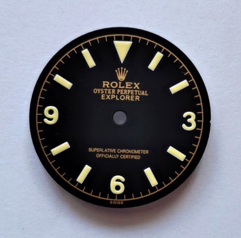

Well.. I think my 'patina' went too far..
* gave the dial a light coat of Mr Hobby 'Mr Super Clear Matt' (lacquer) and let it dry for a few hours.
* Took a role of blue painters tape and made a tinfoil pocket inside.
* 405nm LED UV Light (~6w used for curing 3D prints)
~11 hour later (7pm to 6am).. I had this:
I wanted just a small amount of discoloration... not a pink dial :)
Do I keep going.. see if it ends up full tropical? Or leave it as is? I bought this dial to mess around with... what should my next move be?
I think you should try another test to see
1) Is the lacquer causing the pink?
2) Will the pink turn eventually turn to brown?
Perhaps you have a spare or junk dial to test so these results aren't destoyed?
I 100% think the lacquer is causing the color change.. and that was my goal, to find out what type of lacquer would create a nice soft 'age' first (i was going for yellow/brown... not pinks and reds :D).
The expert I asked (Mr Chat GPT) said that using 405nm UV would be slower than 365nm UV... but I think he was drunk because we colored up real-quick.
I have more dials incoming so I'm going full send on this one (still under the UV now).
To answer another question...
*I did not cover the Lume, just hit it with the Mr Clear... which is weird because the lume is still as green/yellow as the original dial. (again, maybe it is the dial turning.. and ChatGPT led me astray). I really wanted that lume to darken.

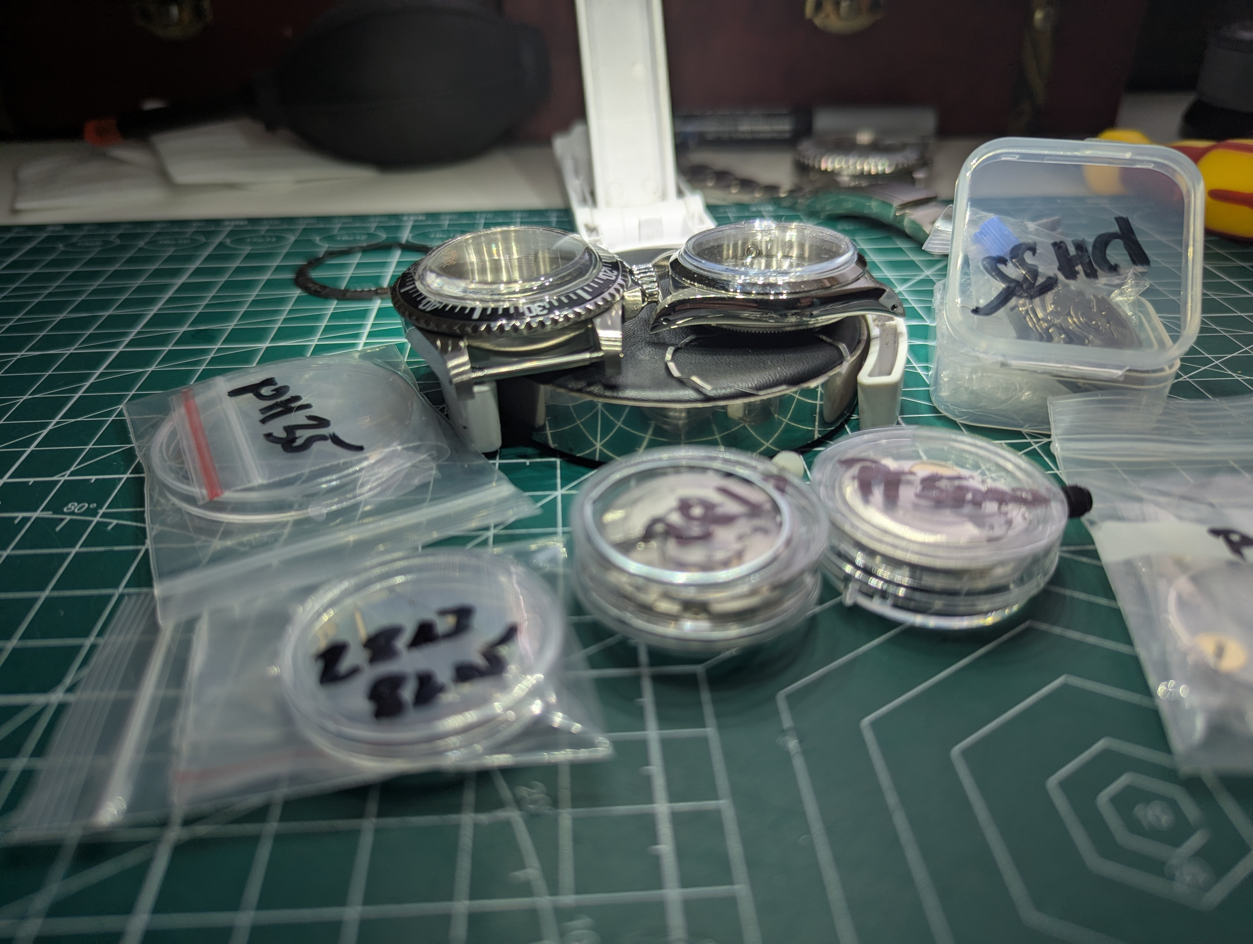

Back in late April, I had the crazy idea to build a display in my office showing the history/hits of the Explorer line (my daily is a GEN 114270). I think Ken is tired of my questions... but I have learned a TON.
6350 = NH35
Albino 1016 = SELLITA SW220 (i got brave and removed the day/date by swapping out the setting lever)
Space-Dweller = PT5000
1016 Tropic = $12 2824-clone 21600bph (that is keeping SHOCKING good time)
Now I'm just messing with spare dials, waiting for some more parts to mess with :)

anyone tried applying lacquer on a black 1016 dial + UV light burning?
here's what i did - sprayed lacquer, chuck the dials under UV for 2 days
but nothing happened!
left - raffles dial from 2-3 years ago, note that the coronet is crap compared to the current version he sells
right - yuki dial, 12 o clock triangle did not melt under the UV; it was an experiment i did with paints to add some layers to the ever tiny teeny thin lume
side note the lacquer adds a very nice glossy layer on the dial.
if he ever sells a black gilt dial, i'll probably get one to swap out my current yuki dial (not pictured here)
