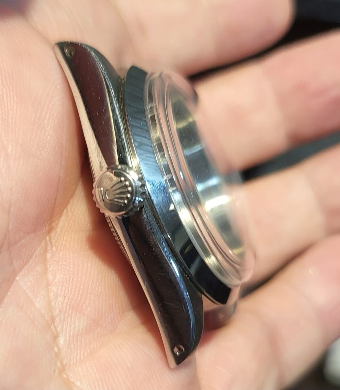

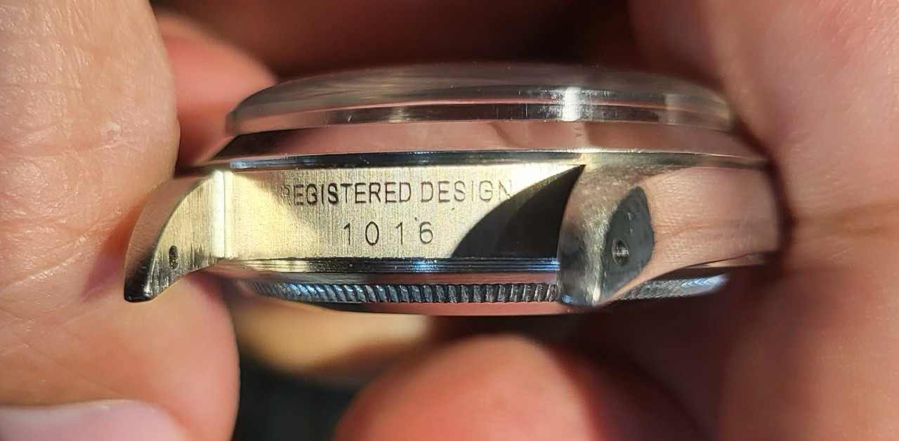

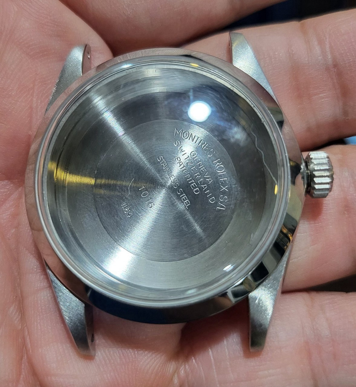

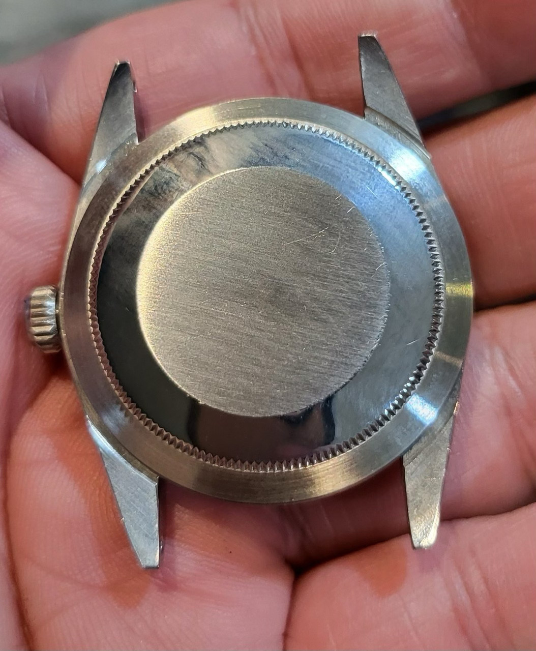

Beautiful build. Really. I have a question. How did you secure the movement to the case? Thank you. Very beautiful watch! A masterpiece.
Many thanks for the kind words I really appreciate the feedback ,
the movement was secured using an adaptor ring form Helenarou, then it was secured using standard eta movement clamps,
I had to finesse the clamps a little with a file but otherwise a direct fit.
I’ve used one previously on my gen spec 5513 case and it worked well there also
