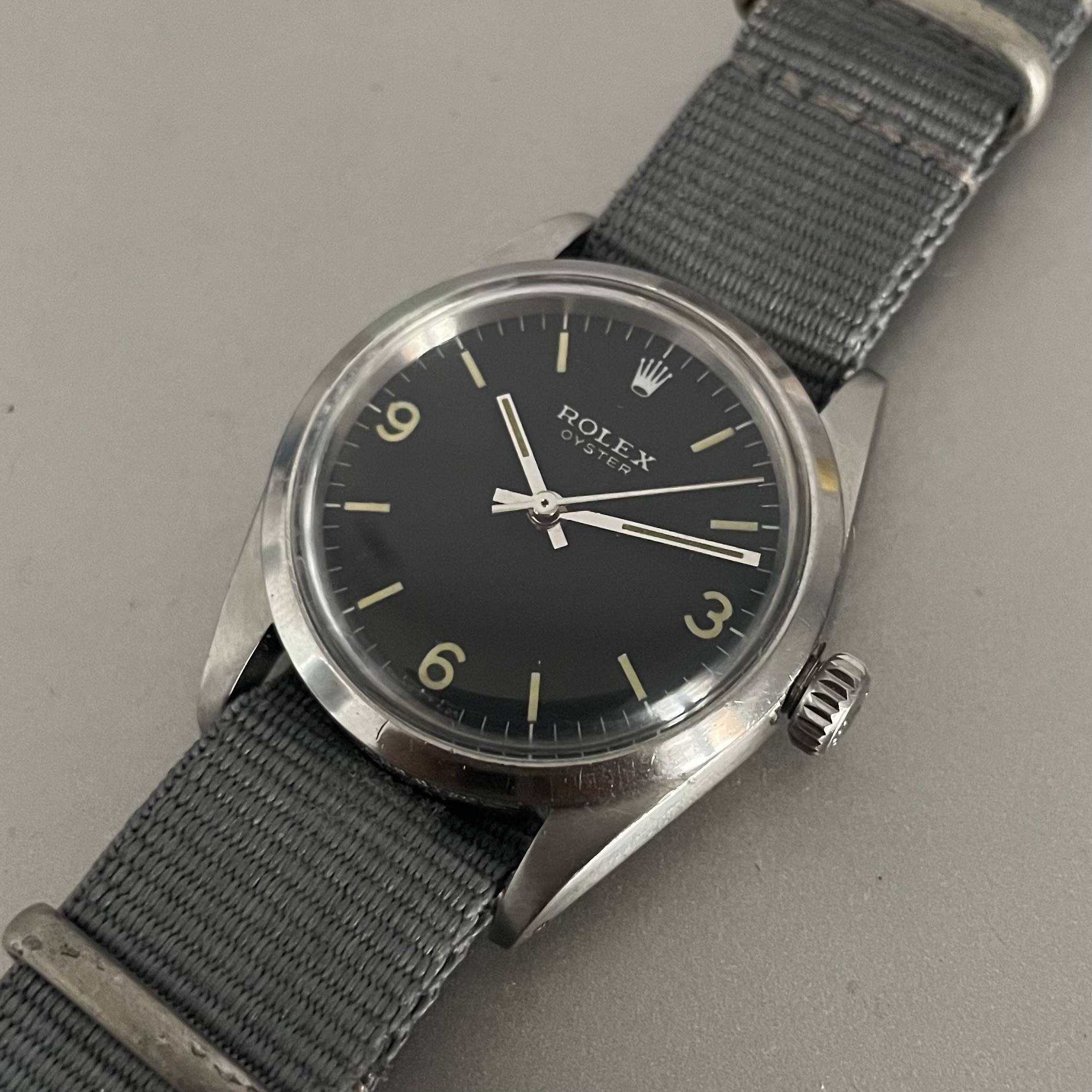

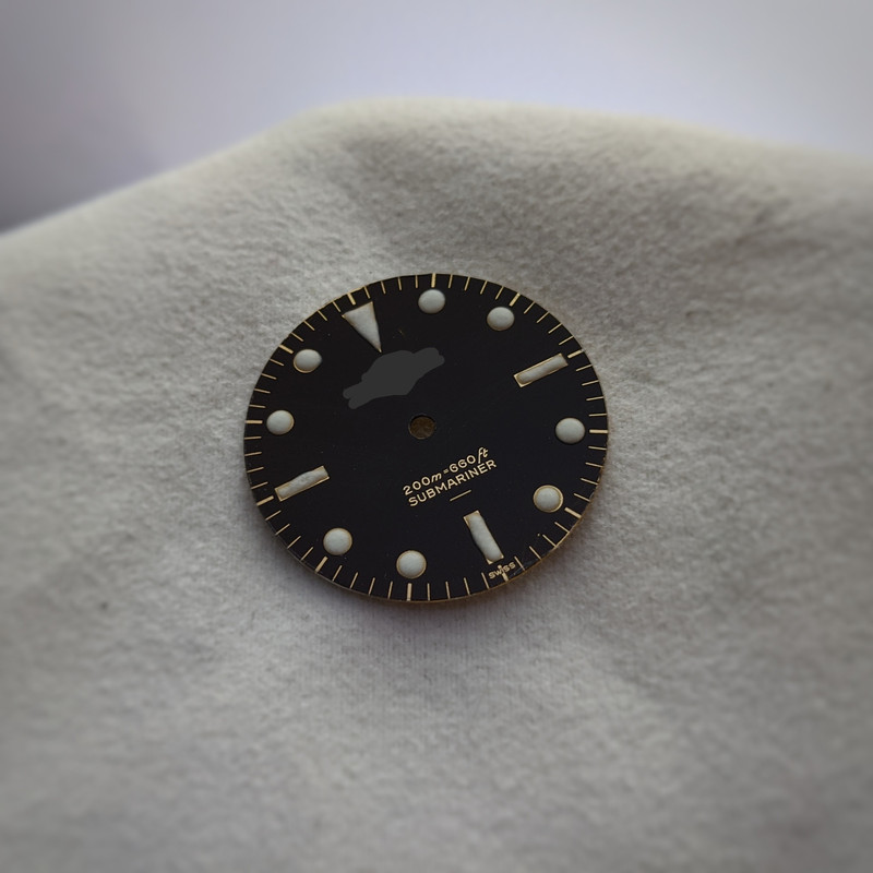

Nope dear sir. I did everything myself from preping and modding the dial to the art in MAC and creating the dial myself via decals. ;)
Nicely done. Have you made many dials? any gilt examples?
Be honest.
