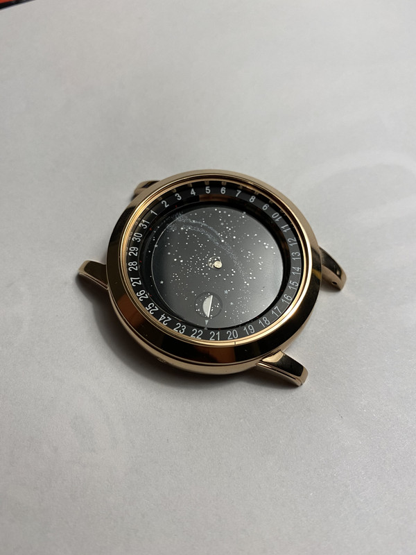

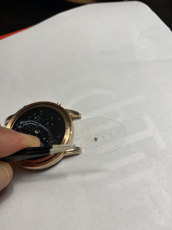

So here is what i've experienced from this watch. It's front loaded and the bezel looks pretty impossible to open without scratching the case, because there is no "lip" to put in a tool and open it.
But if you get it opened, here is what needs to be done:
The hands are removed in the picture, pretend they are still there :)

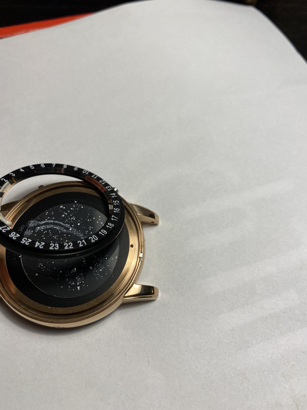

The rehaut bezel can be removed easily, just lift it:

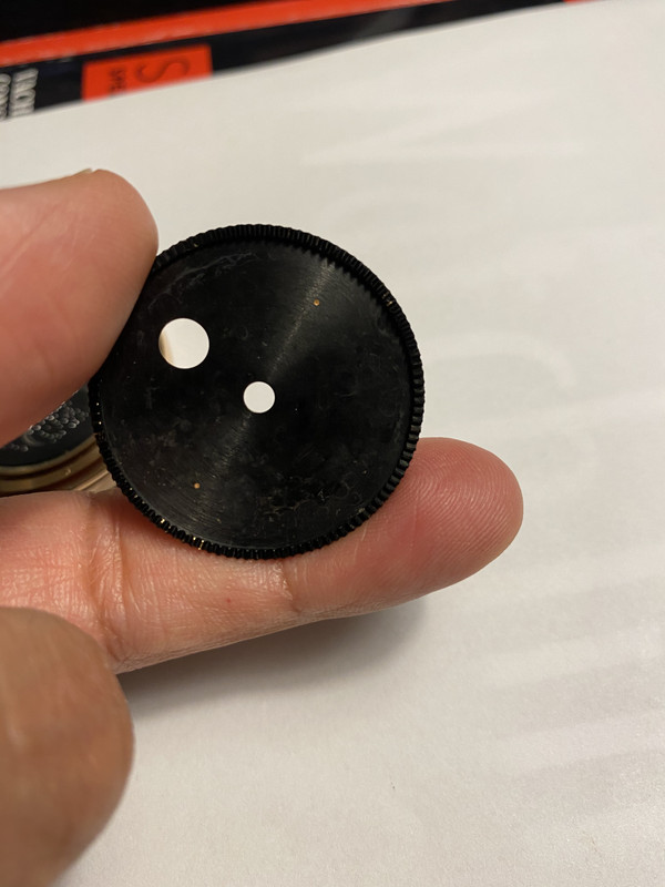

Then you have to remove the moving seconds hand disk, which is also easy. It's just fixated on a central pinion on the hand stack:
Then you remove the hands and paint them white like the gen. They are kind of greyish on the gen.

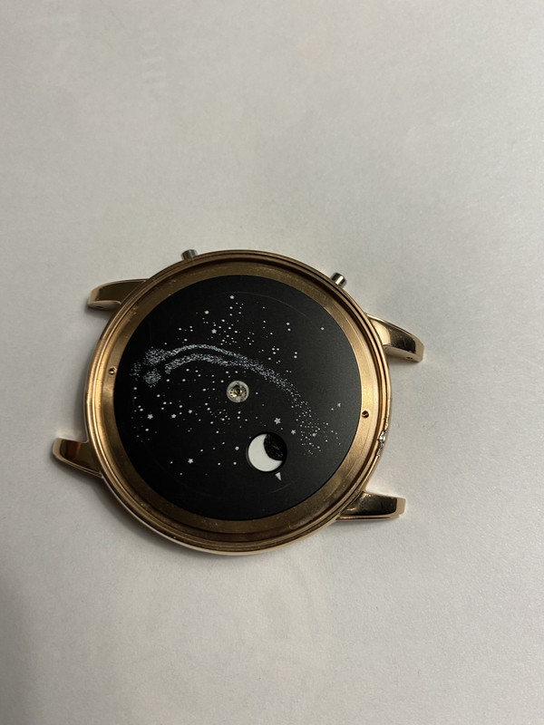

Next part is to lift the main disk, it lies loose in between the hands and can just be lifted when the hands are removed:
This disk needs to be modded. First of all painted more stars and secondly lacquer it like described by Dr Fun Socks , so that it becomes shiny like the gen. Both are a bit tricky. Painting more stars could maybe be done with a needle.

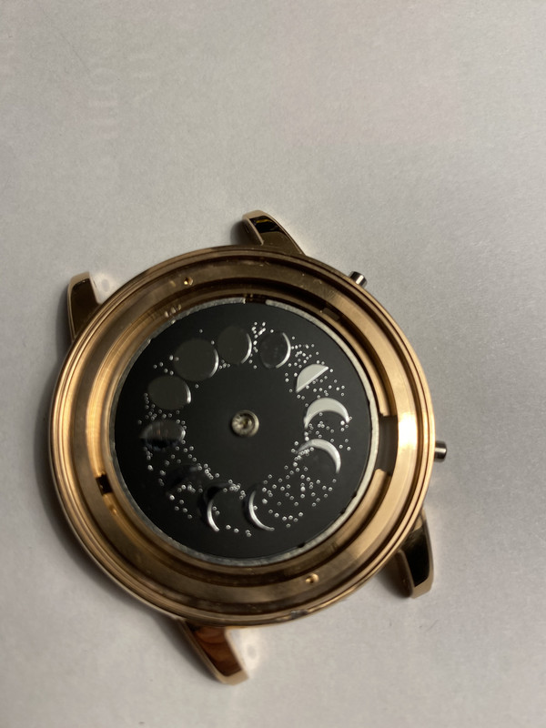

Beneath you find the moon phase disk. It has wrong shape and color of the moons:

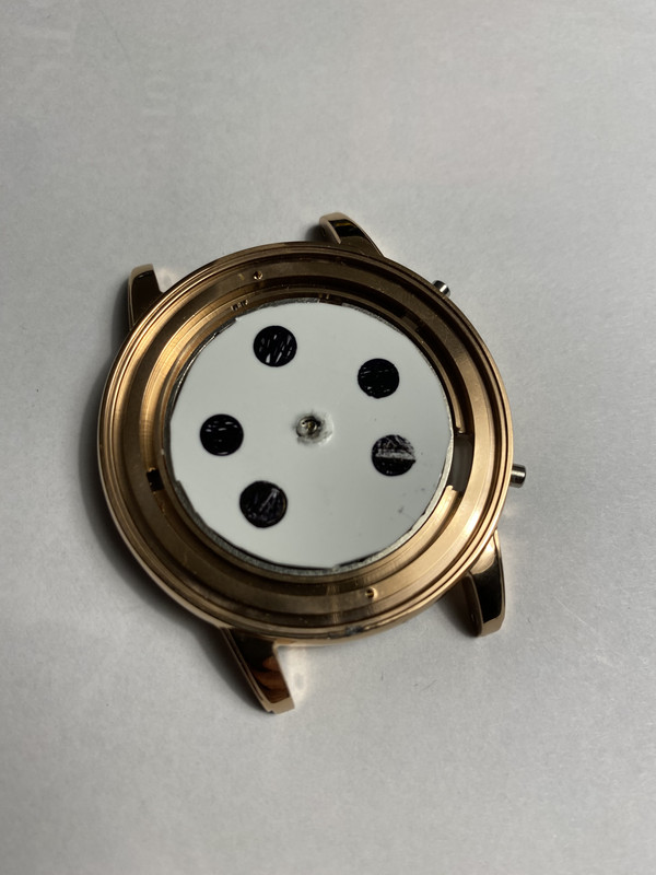

It should instead be attached a white layer on it with black circles the size of the opening in the main disk:
So that it looks like this when the main disk is turned around on top of the moon phase disk:
This part could be done using a printer and photo paper.
These are the mods that needs to be done for this watch to be a really great rep, which is very similar to the gen!
I can see and plan what needs to be done, but unfortunately i don't possess the skills required to open the bezel properly, paint the stars on the main disk and lacquer it shiny. The moon phase layer i could make by printing on photo paper.

White decal paper could be used to make the 5 black moons and adhere that to the moon disk. Thereby we can solve all three flaws.
He also gave me the idea that one could buy a bezel opening tool to avoid scratching the case when opening a bezel without a "lip". That could give access to removing the moving seconds disk and the other mods.

Yeah, I also thought about transfer paper. I have some custom dial project for which I will use that but it does not really work on 3D surfaces.
I see in your screen that the disk is flat, I was under the impression that the star were in 3D on gen.
I kind of see little shadows for every star on the official website : https://static.patek.com/images/arti...102P_001_6.jpg
Maybe those are shadow from the second layer of star.
Right now, I cannot send anything since most post office are closed but it should get better around mid-may or early june.
The tricky part would be the gear wheel under the disk, I would need the exact measurement to get it right so that it can rotate.
From what I can see, sticking another disk on top of original one is also out of question, even if I can get down to 0.5 mm thickness it will be too much.
https://imgur.com/a/lUECk8P If you want to get an idea. I killed them by trying to paint with different techniques.
In the gen the stars are printed on a sapphire disc. The bottom of the disk is black (or blue). So you have this effect like the stars are "elevated" because of the sapphire disc and cast a shadow.
I see. The main disk is not in 3D, but the moon phase disk is.
I can see that. I think it will be better to do it with decal paper. Can be near impossible to paint by hand i think.
I don't think there's much space to make a new disk. But a decal layer on top of the moon disk could be possible, as it's smaller than the main disk.
But it's a lot of work to get this right.
