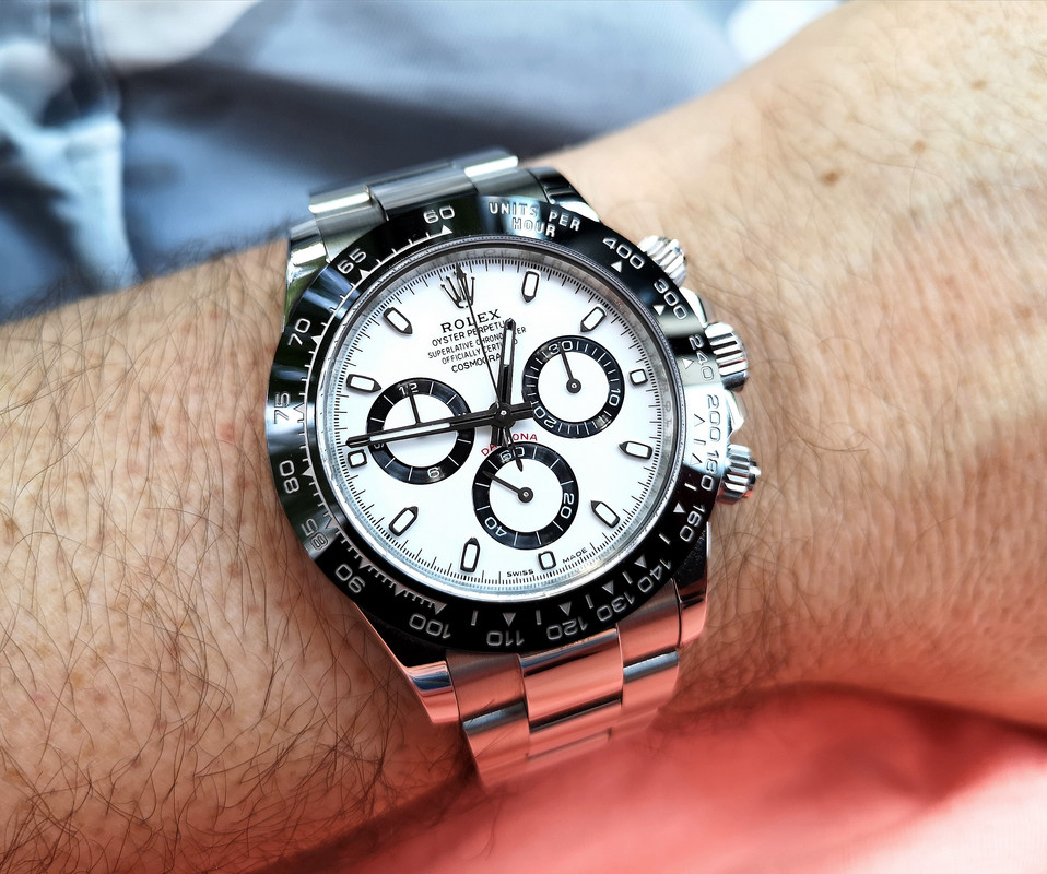

why you didnt put the Ceramic bezel which is more suitable for that dial ?
Because I prefer the 116520 and the minor difference in font spacing for ROLEX doesn't bother me one bit. It's like I worry someone's running around with a chart of the 28+ dial variations of the 116520 :xd:
Go gen dial for €2000 only to have the font spacing 0.5mm closer, nah. that's borderline
of course you are happy and that is what counts, but since you are showing off in a forum you might be prone to being asked. Of the 28 iterations you showed only one looked very similar to the dial of your watch and it's the only one with ceramic bezel...
All other 27 of them with steel bezel have a totally different font for ROLEX
But again, you are happy and that's what counts..
PS: ARF dials cost a tenth of a gen
I think you misread my tonality, I simply wanted to explain my thought process.
I get that it’s only the ceramic dial that’s 1:1, my point is that someone would have to have memorised all the variations to notice that or have the chart at hand to compare. It’s not a real life applicable scenario.
ARF dial would require case work and also moving the dial feet both of which are quite the challenge for the possible reward.
We are all different, I choose not to worry about minuscule stuff like if the R is above the T 0,5mm to the left or right. With that being said I have the utmost respect for those who have the energy to do so.
