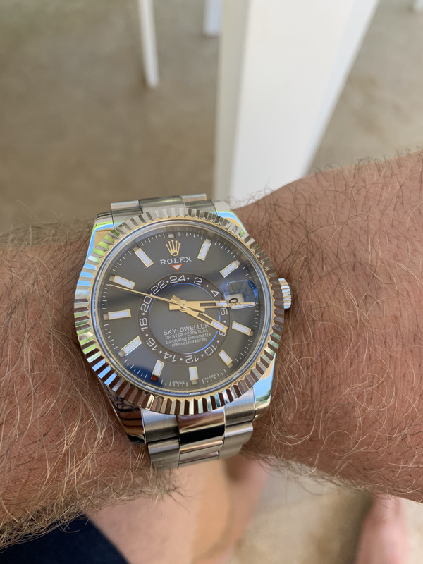

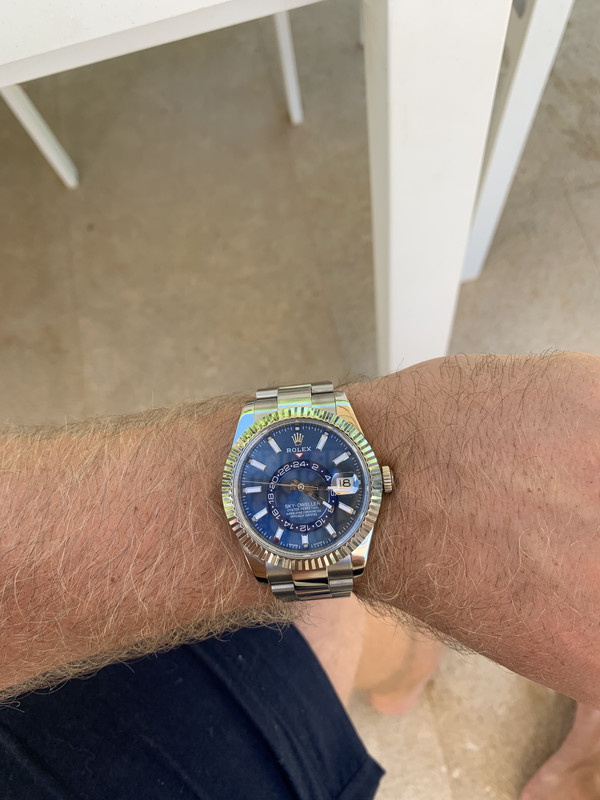

Hello every body, I just get my Sky Dweller from PT... I’m disappointed because the letter SKY Dweller on the dial is not aligned not parallel!!!
i valid the QC but I did’t see it ....
KJ2020 need help !!! Can I open the watch and fix it ?
Somebody have the same problem?
the watch stay beautiful but now I see it every time...
thanks

I'm confident that can be fixed pretty easily bro. I haven't had my Noob apart yet but I'm sure its a two piece dial like the previous version. Those versions have a month indicator transparency attached. I got rid of that and made one that rotates. Then just used dial dots to attach the inner dial. So however the Noob is set up, I'm sure it is able to be fixed.

Thanks bro... is there a thread with a tuto to open it ?
take care

It's a 2813 base watch so open the caseback, release the stem with it in the winding position and remove the movement tabs. Remove the hands and dial and see how the middle dial piece is attached. It's possible its glued onto the back of the outer dial with a transparency overtop the GMT wheel. If so, the inner dial would need to be sliced away, realigned and reglued. Take care not to nick the visible part of the transparency if present. The inner dial also may just be attached with dial dots (double-sided tape mini squares or circles).
You need to hold the stem release button down to re-insert the stem.

Whooo!!! Maybe I would ask to my smith
