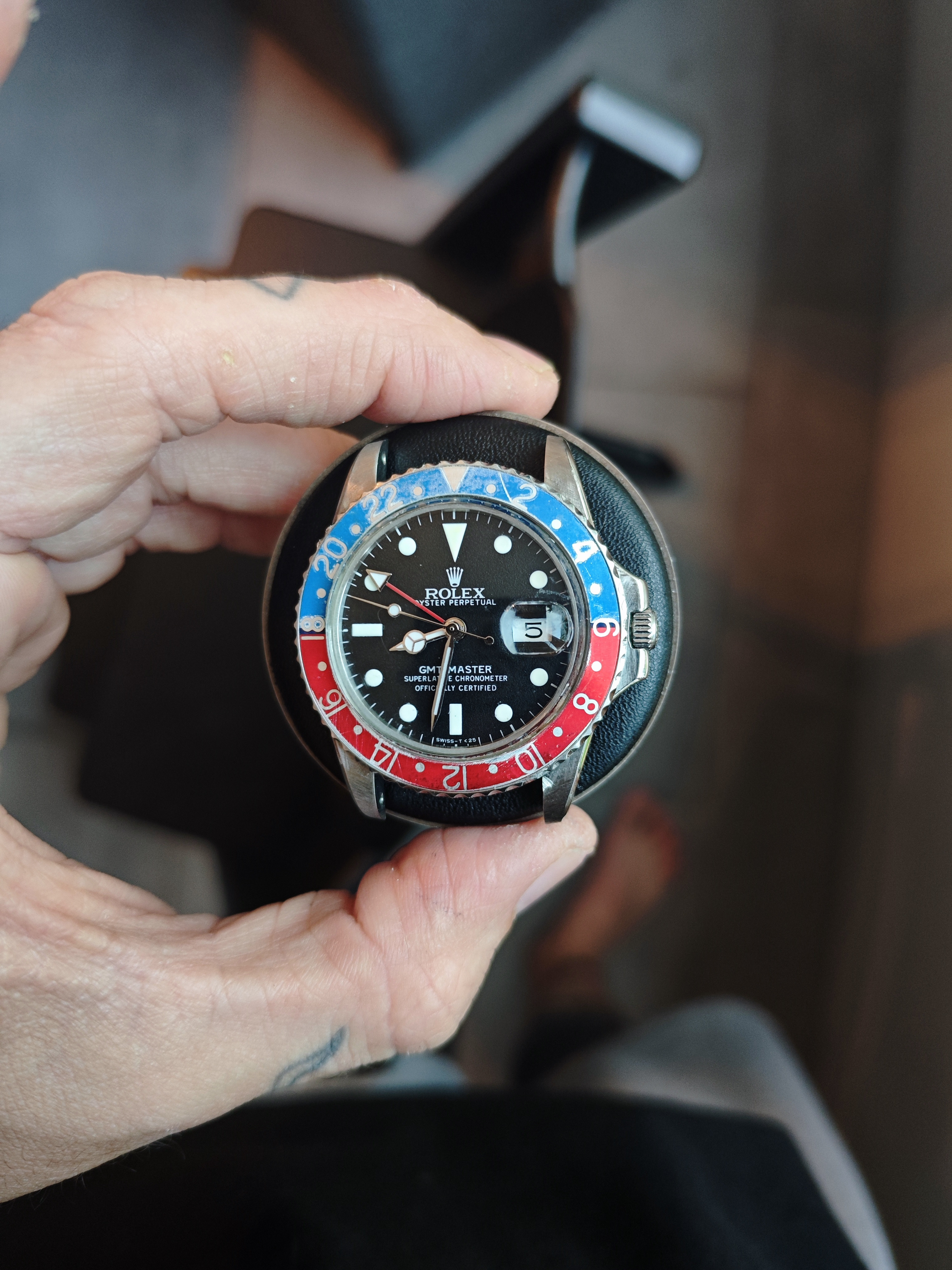

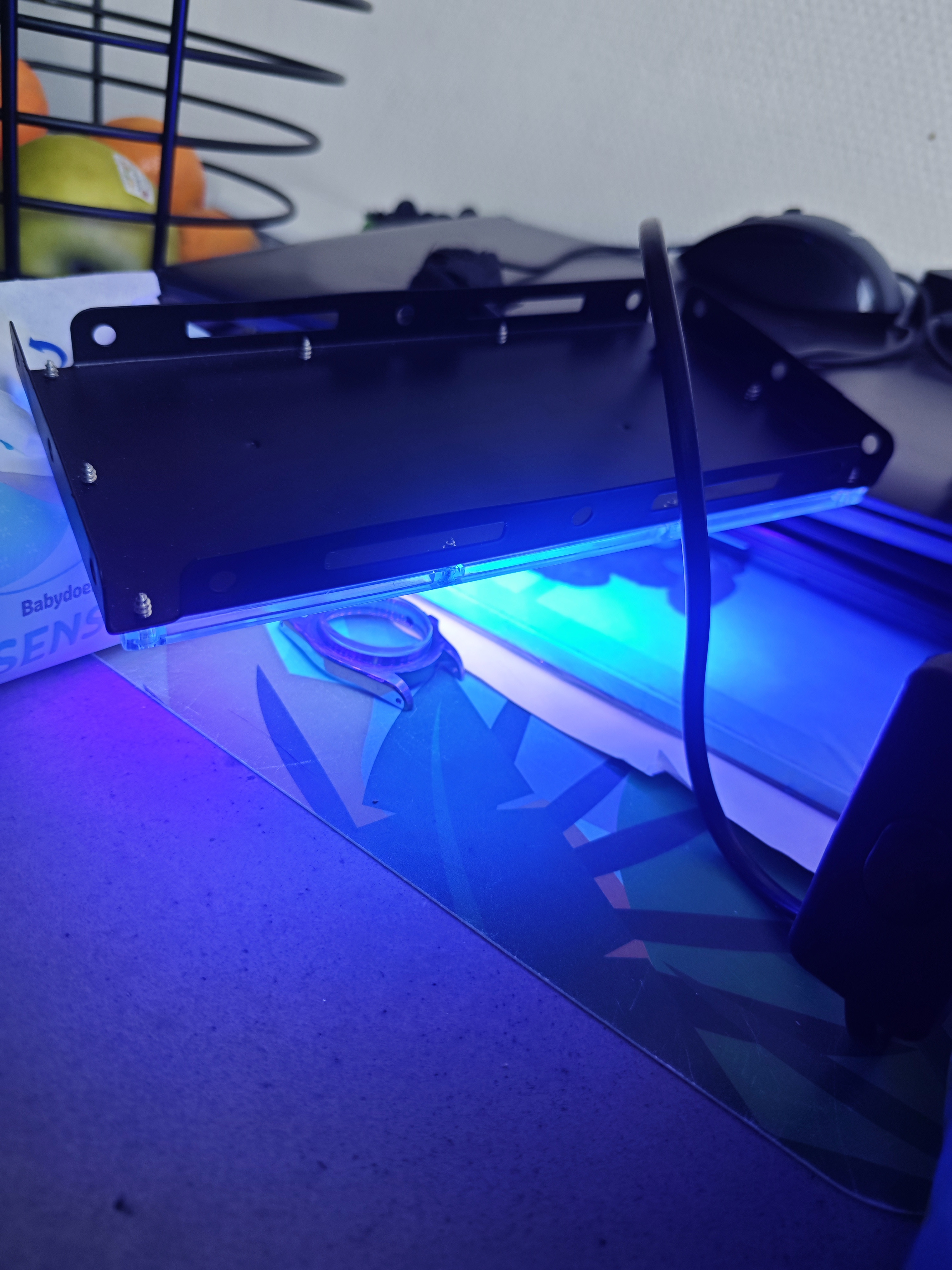

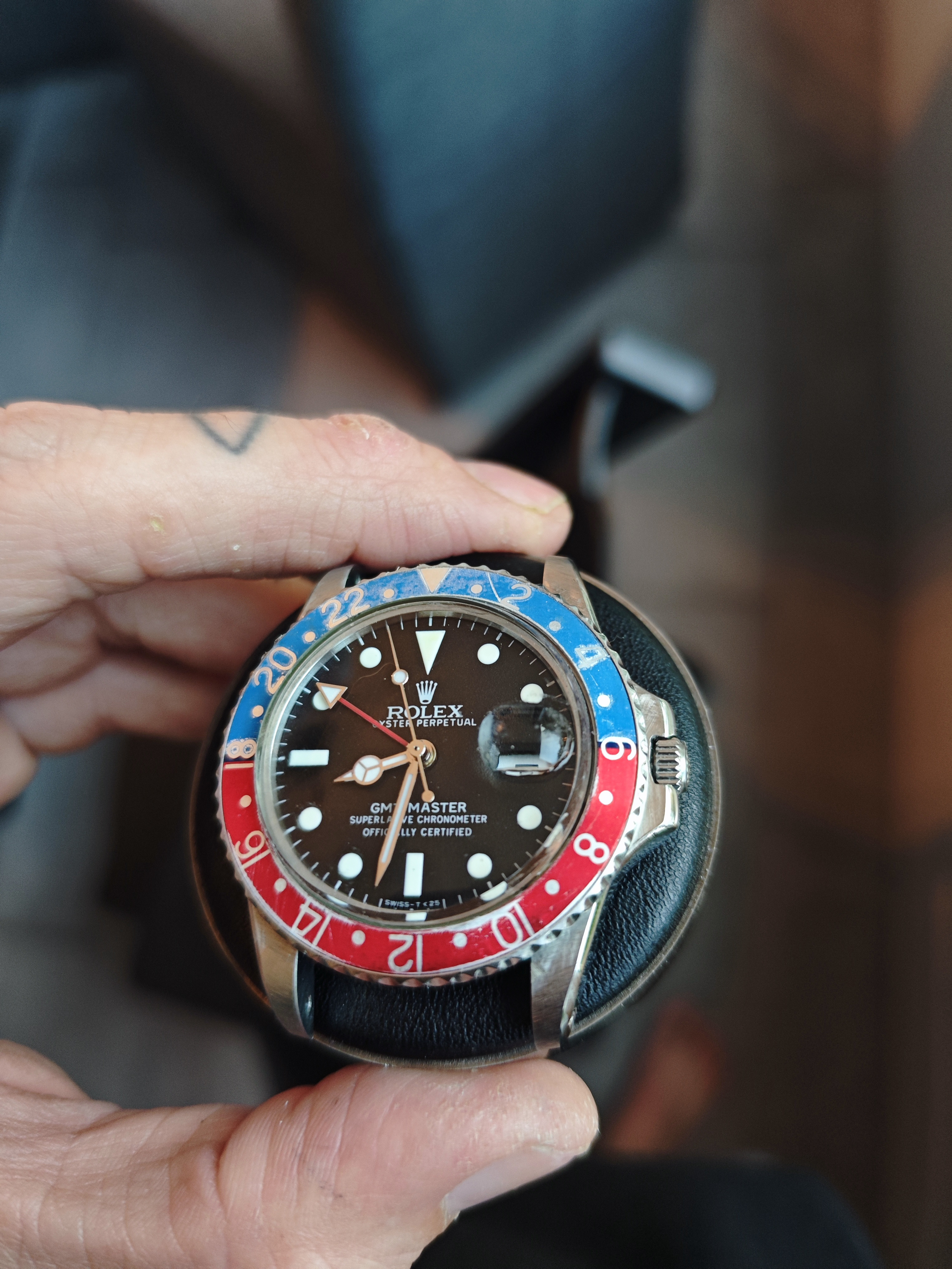

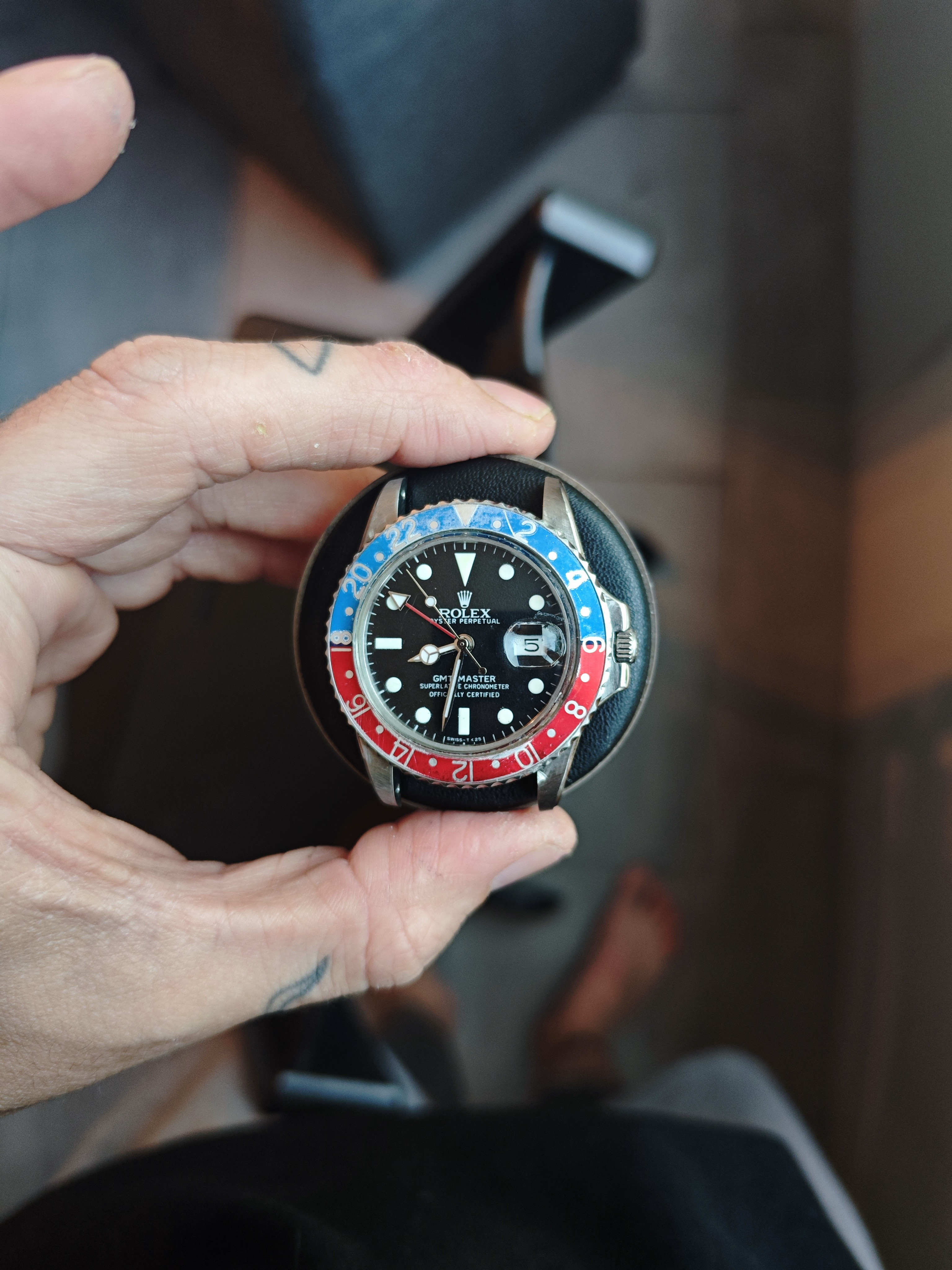

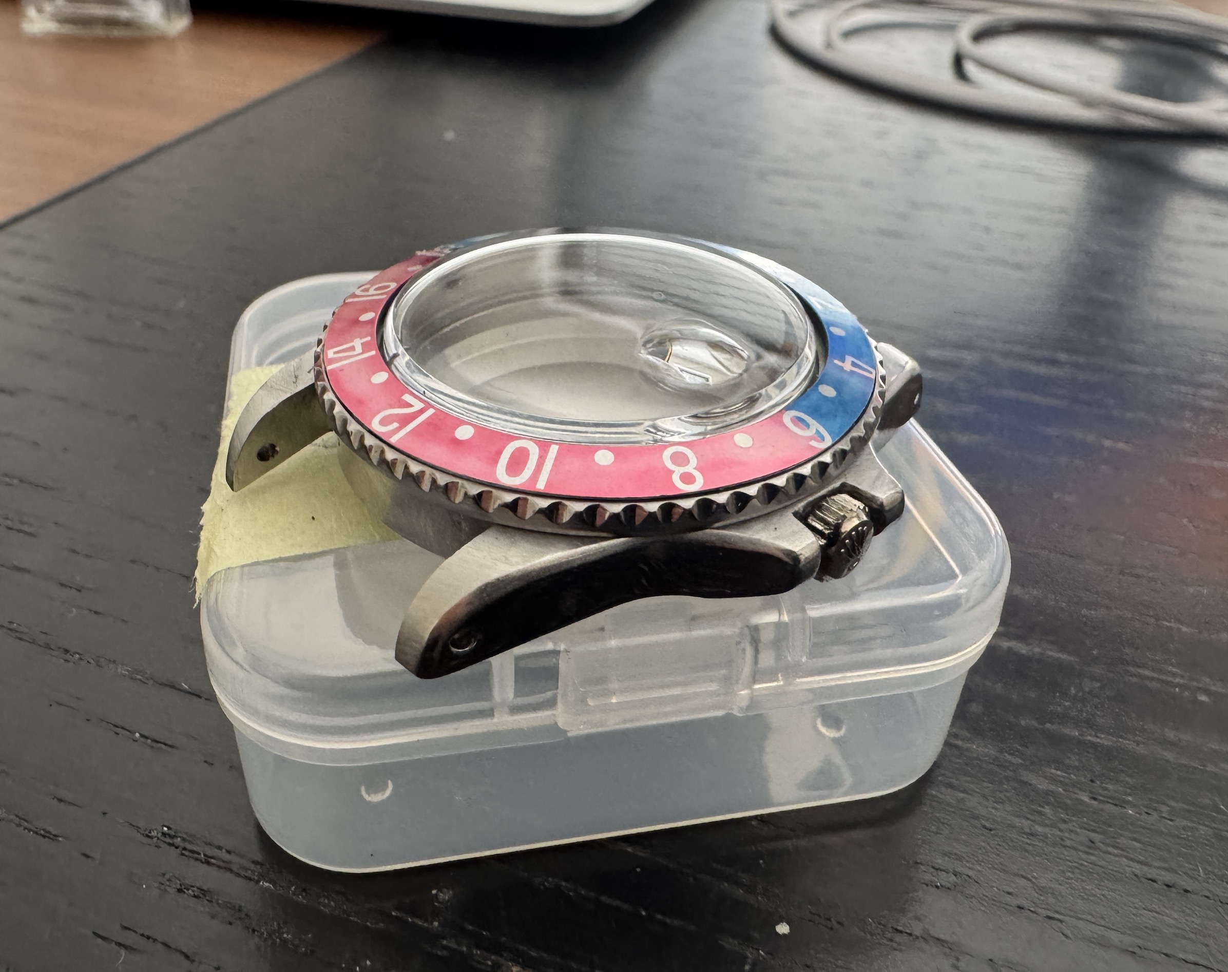

Another fun build iam working on.
Tried to fit a sternkreuz (right date magnification position) acrylic crystal but the bezel would not fit for some reason.
So i tried to send it with a dremel.. learned never to do that with acrylic. šŸ˜…
So messed up the sternkreuz crystal and my bezel gasket.
Sanded the original date mag. of the Raffles crystal, cut the sternkreuz into pieces and sanded the date mag to UV glued it onto the Raffles crystal in the right position.
And also UV glued the crystal to the case.

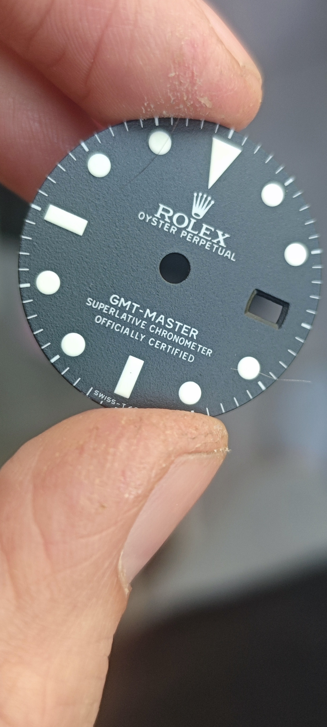

Aged the dial with lacquer spray, aged the insert with a little sandpaper and bleach.
Shaped the crownguards.
Expoxied the bezel onto the case, hopefully still fully turning.
If not, who cares.. i dont šŸ˜‰
Assembled everything and waiting for the epoxy to fully harden.
Will clean off some uv glued residu around the date mag afterwards.

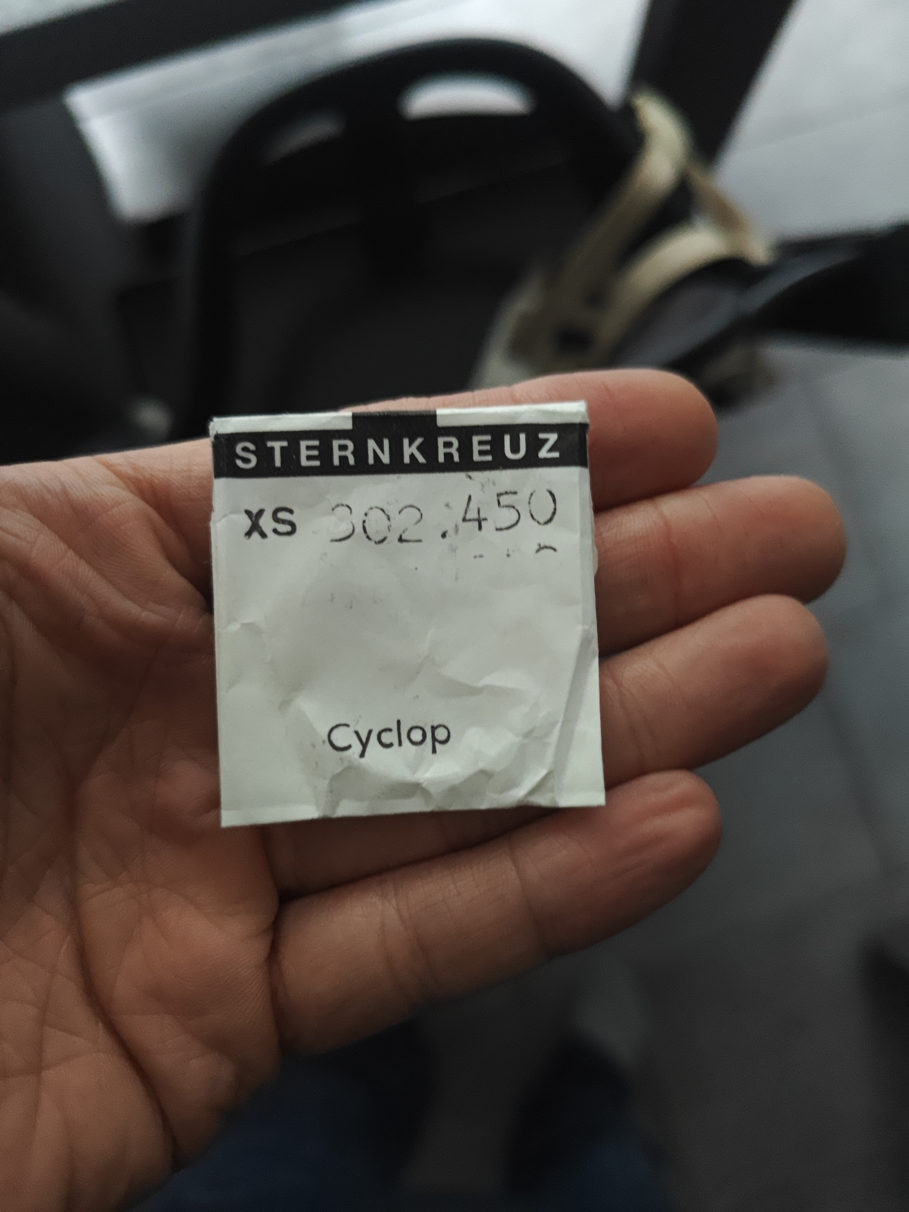

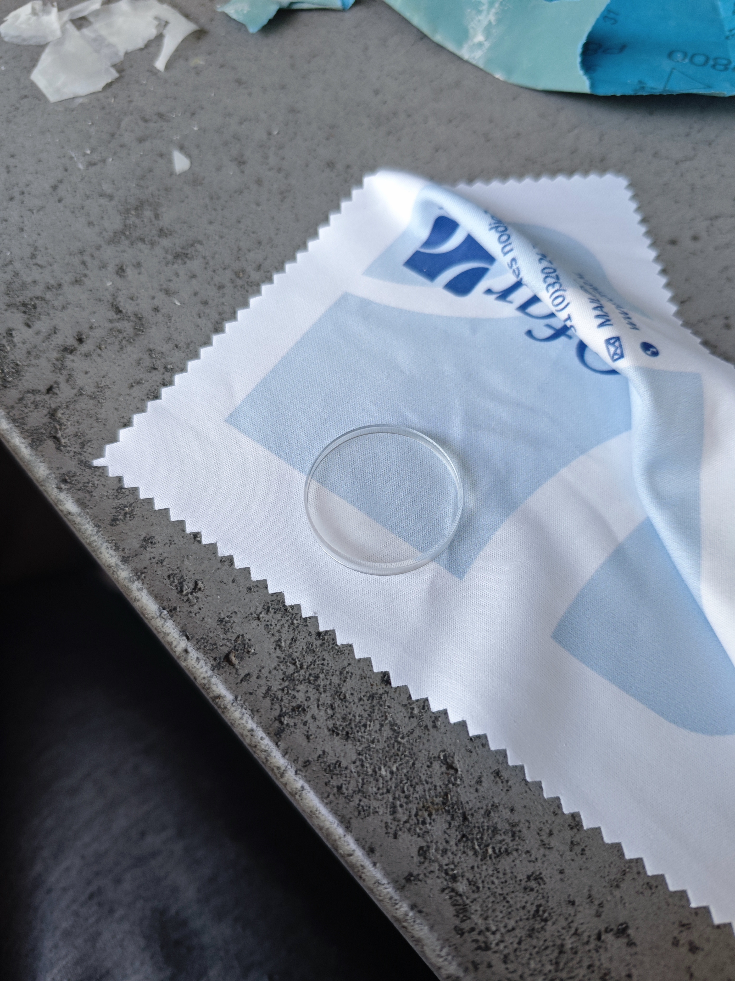

Do you have the exact Sternkreuz parts-number? Because there were 2 Sternkreuz crystals that people were mentioning lately. So, of i know which one you used and didn’t fit, I’m gonna order the other one šŸ˜…

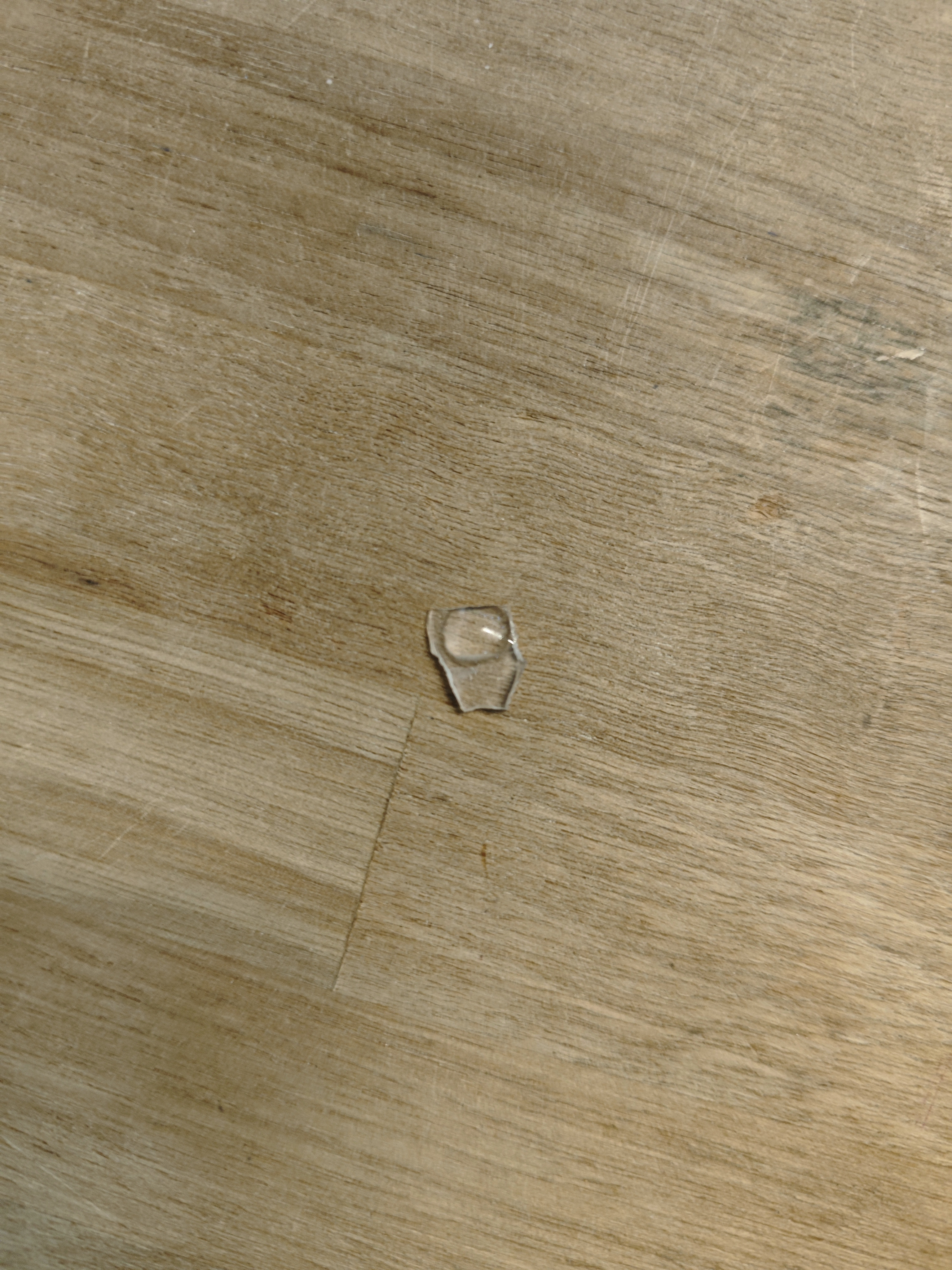

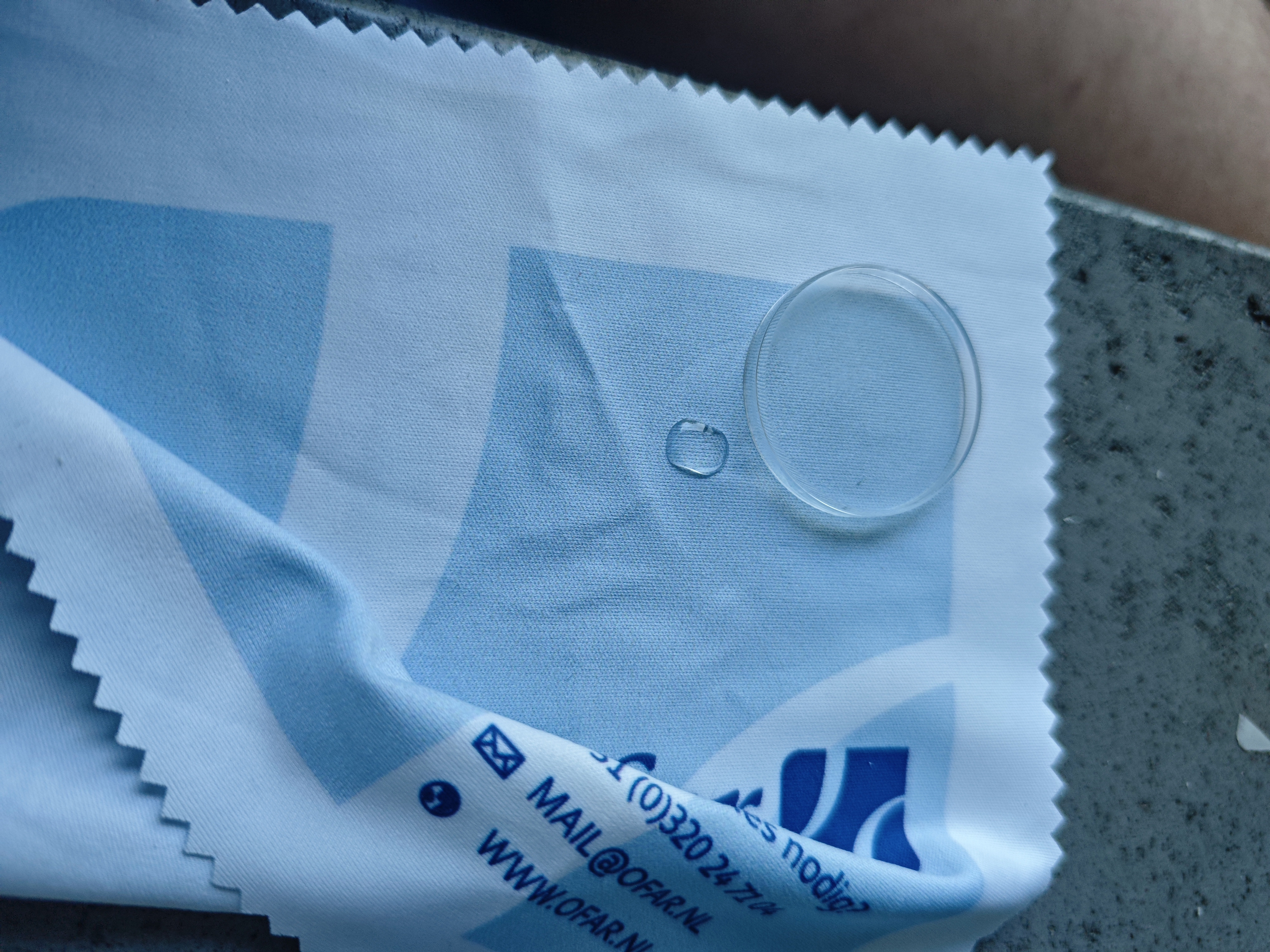

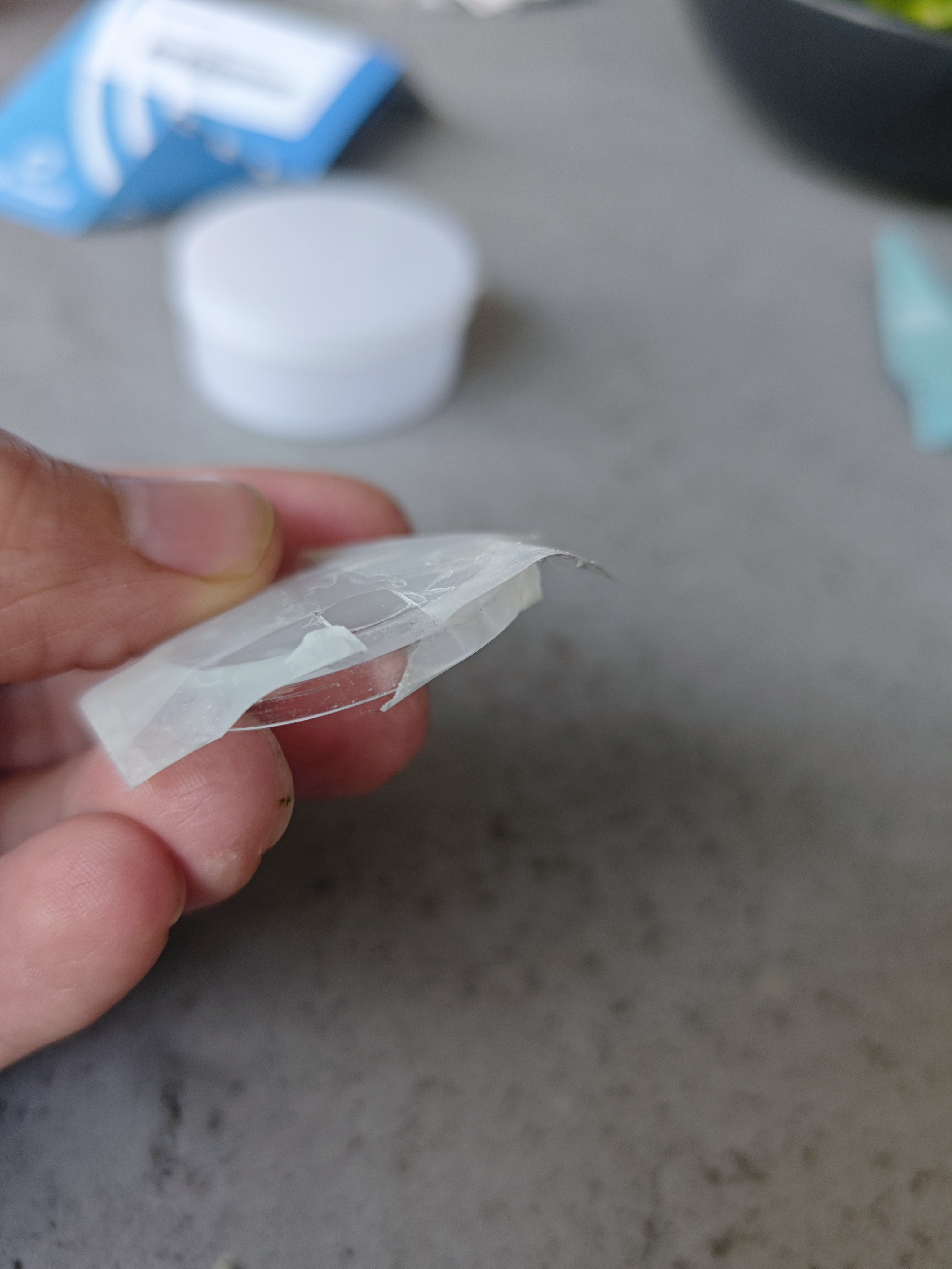

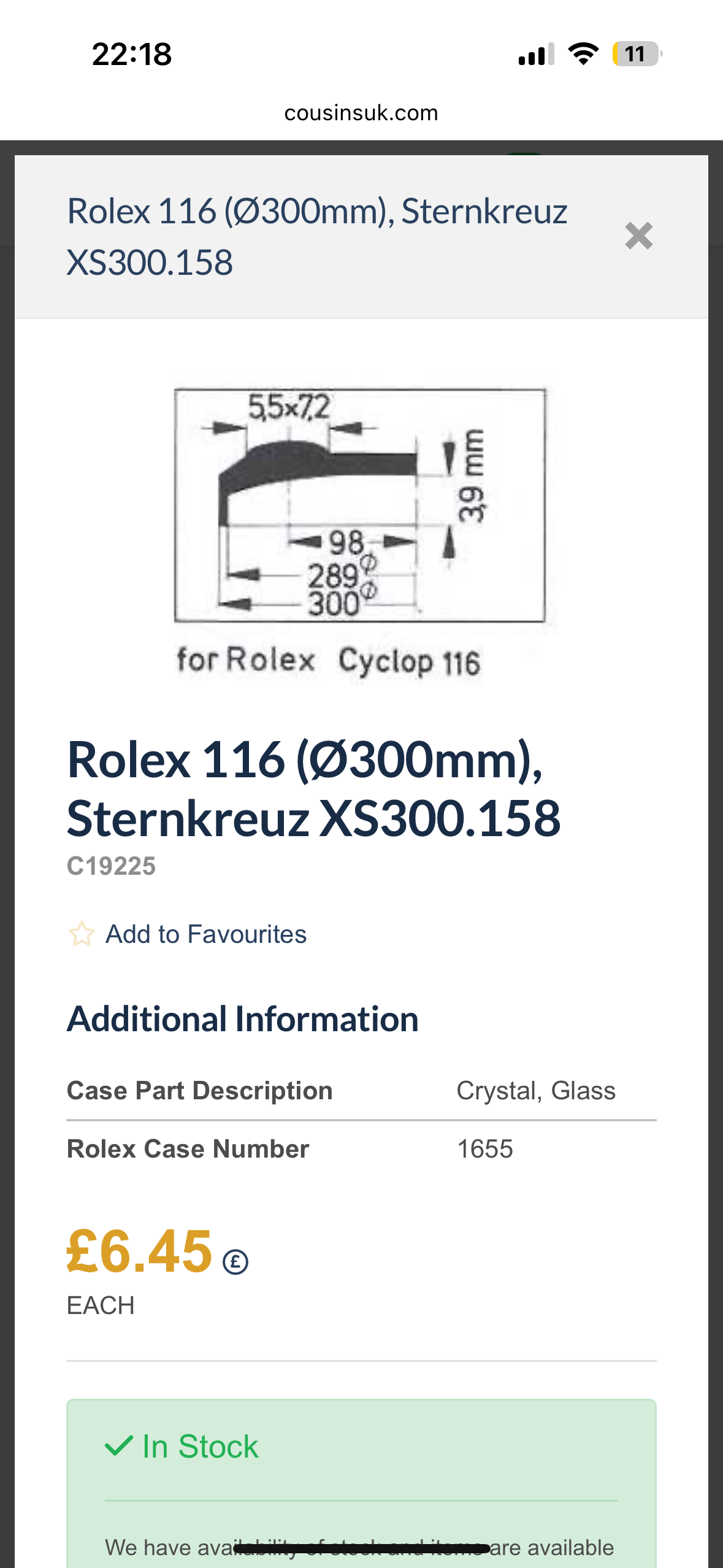

Do you have the Sternkreuz parts-number? Was it the 300 or 302?
Reactions: Blitza
Blitza
"you allready had a watch like this"
31/5/20
1,881
592
Whats different with the 300
WatchN3RD
24/7/18
676
828
In the thread that you linked, they are talking about the Milk case. Does it apply to the raffles case as well?
Yes. Both cases have a genuine size rehaut, so they use the same crystals.
The problem with the Raffles crystal was that it had an ETA date window The dimensions seemed okay though.
