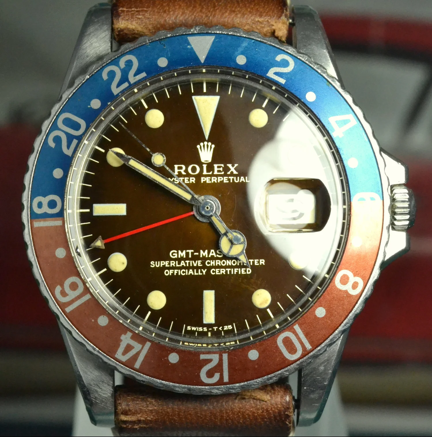

In convo with Raffles today , asking him if he would consider doing a dark brown tropical dial with gold print . He is unsure if there would be any interest from the community. I think it would be a nice addition to his line and offering a tropical gmt dial would be unique. not many offer one. The min is 50 pcs for an order. I think we can handle that. He does not expect everyone to commit to buying one or we need to have 50 buyers , but just to gauge interest. I think the interest would be there.
drop a like if you would be interested in seeing a tropical brown gmt dial to fit this case.
gen pics for clicks. - it would be similar to this. but with a light almond tone lume.

Generally , We know why (or how) a gilt dial turns tropical ,
Matte dials dont turn tropical. The exception being the 1680 red and very very few 5513 do. Why is that? I have not seen any other matte dial models turn tropical. Is it the paint they used ? if so, you think they would use that same paint on all the dials of that year. so why did some change and others not.

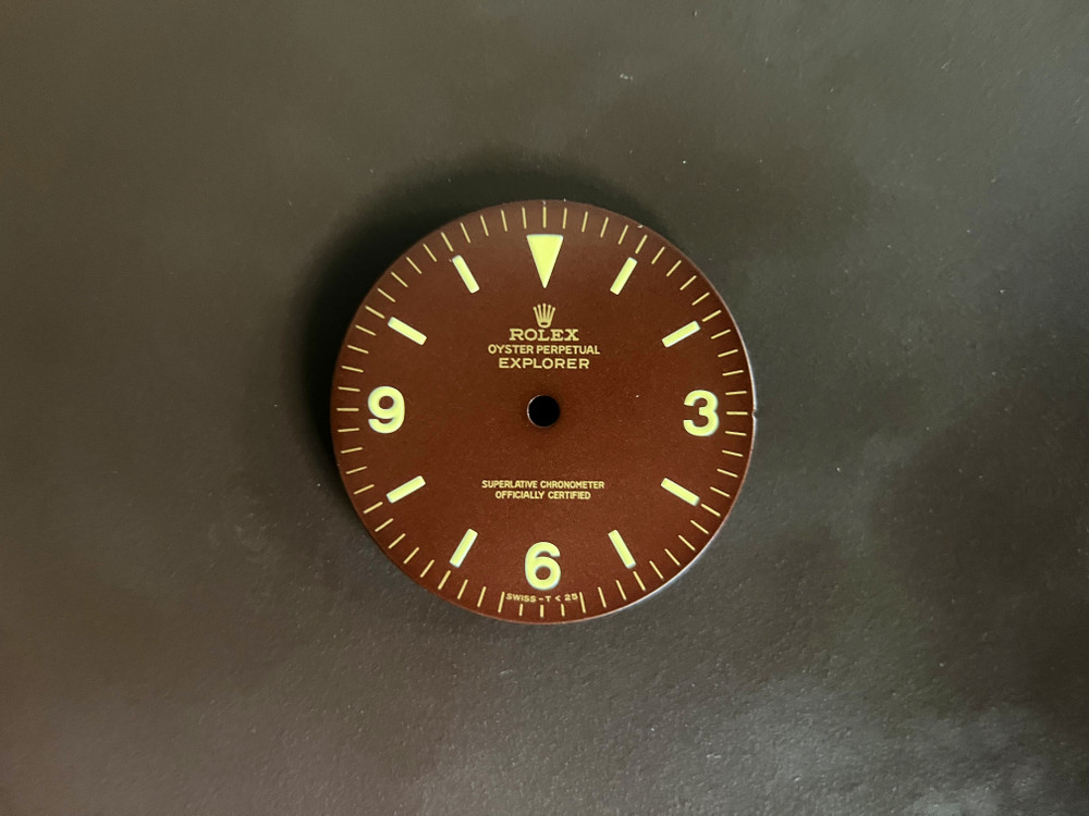

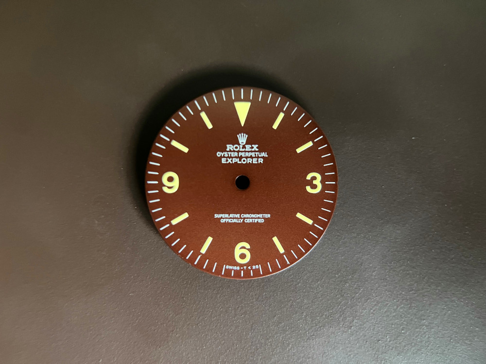

It would be nice that raffle offer dial with no varnish as a test dial I received from him, will post picture, the dial is much more plaisant without the thick Matt varnish....
