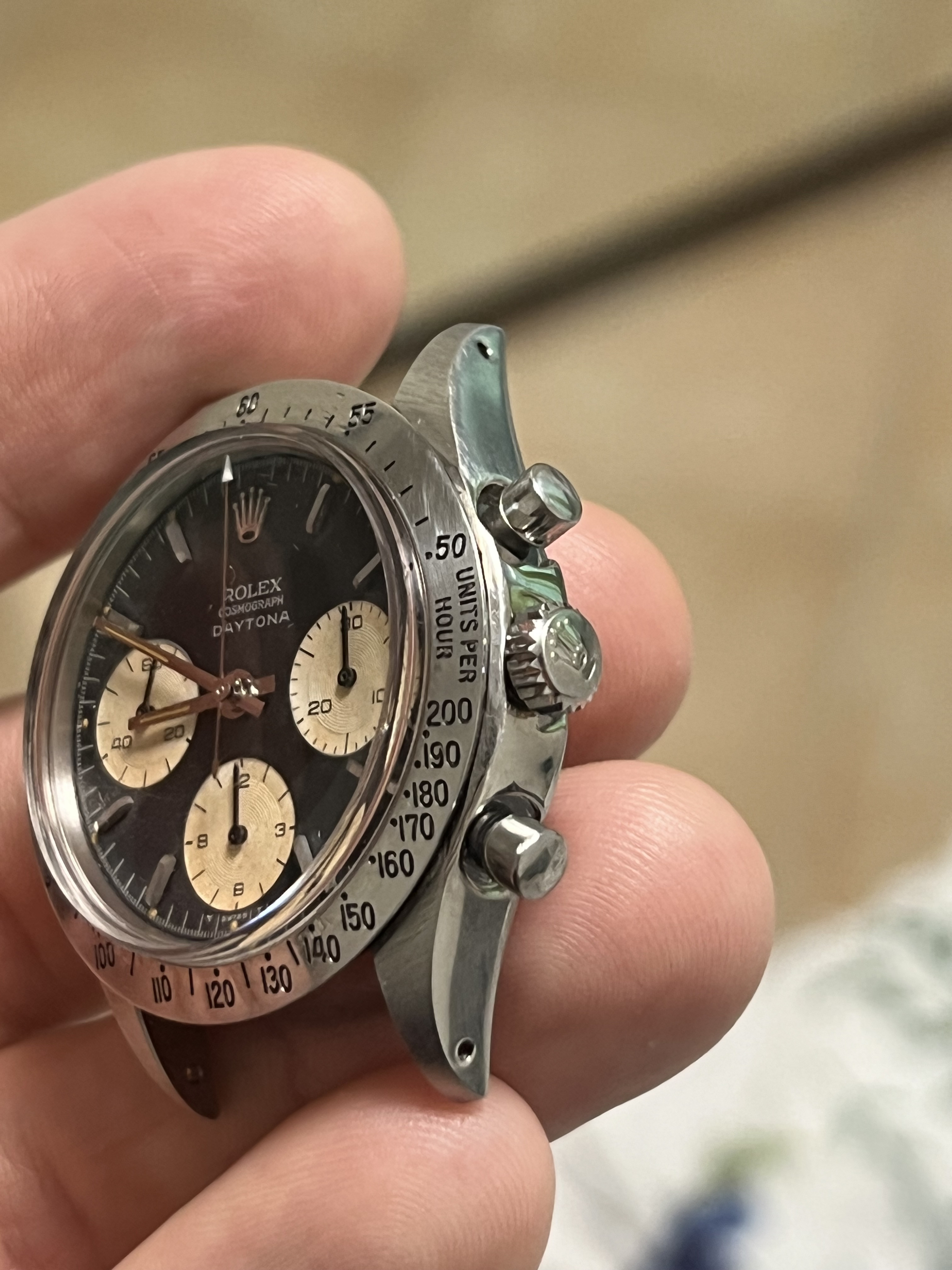

The first seems EE
The second is WMF
One of no name factory is this:

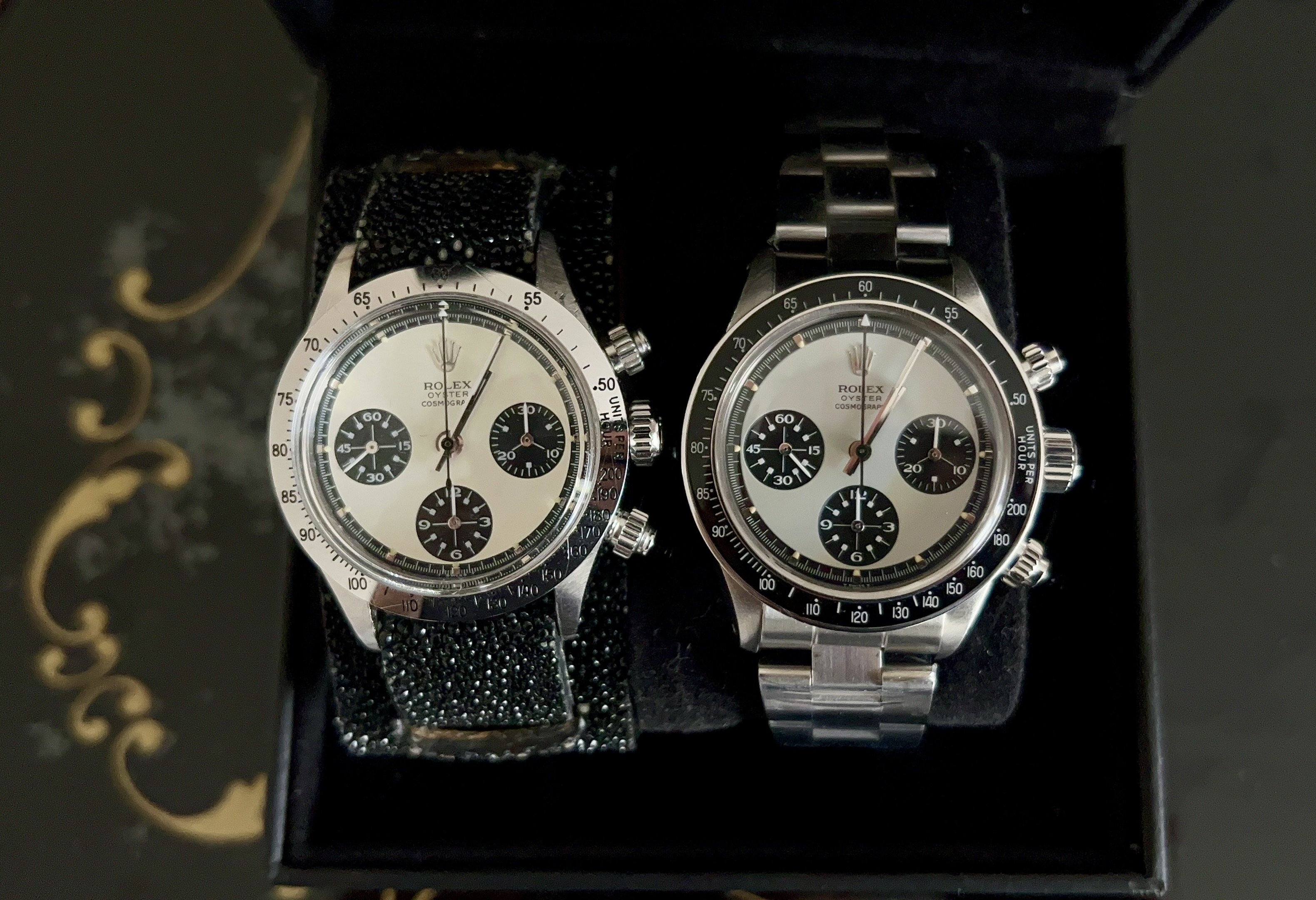

Confrontation between 6265 (left) light aged NNF out of the box and 6263 (right) high end with vj72

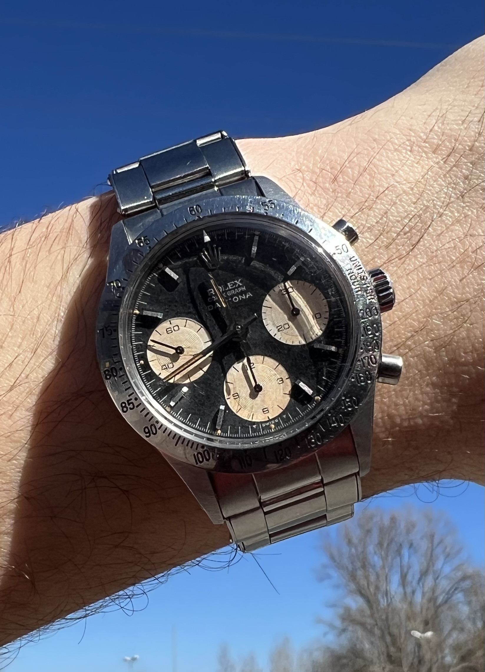

And this is no name aged 6239 with modded dial and bezel ;)
Your choice!!

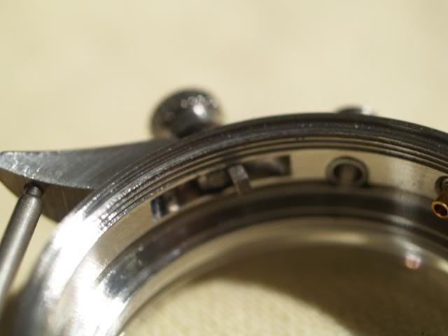

Thanks for your reply. I already completed my v23 build and did not want to glue the subdial hand to the dial. I instead glued a pinion to the movement and installed the hand on that (similar to how its mounted on the st19) imho that also looks better sice the hand does not sit on the dial but has a distance to it.

no, i used an old DW case for mystery movement (v23 "clone") or Valjoux v23. the V23 and mystery movement are a thinner in profile vs. the V72 since it lacks the 12 hour counter and therefore do not fit a gen spec v72 case. The stem is not lining up with the case hole/tube.
