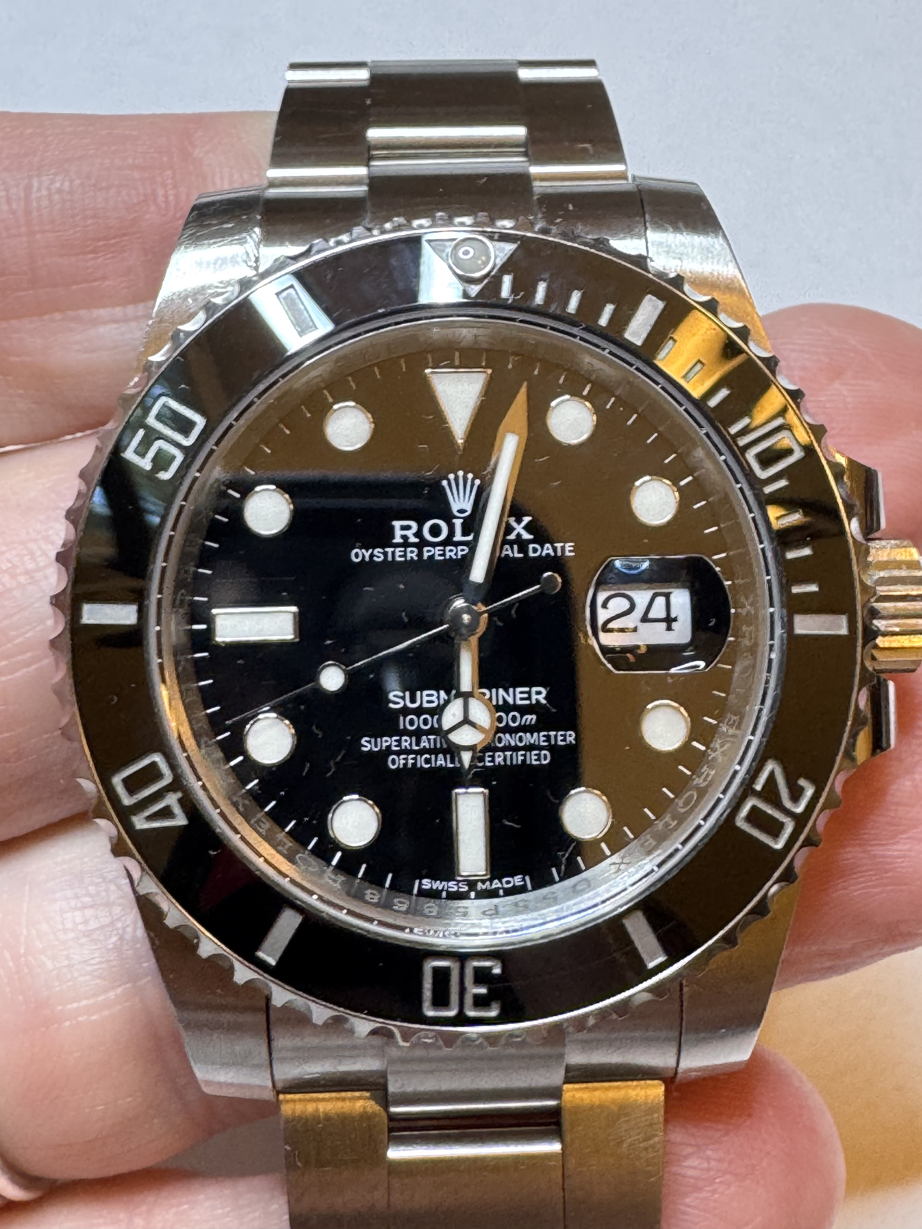

On second thought..........it may not look like a huge difference in those photos..........but I swear it is to the naked eye!
