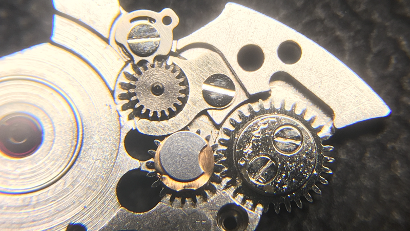

I can now confirm that Swiss ETA 2824-2 reversing wheels are a direct fit. I'm in the process servicing one now that had a faulty reversing wheel so I had to change it. Result is superb, winding is smooth and I think the autowind is more efficient.
santre22
22/3/12
1,646
343
There are some improvements on the ratchet click in the new batches. On my early the little spring can easy jump out of place before the click is tightened with its screw. The new style have a slot for the spring end and is much more reliable.

santre22 One more question please, I looked for the "Swiss ETA 2824-2 reversing wheels" and I did find 2 different part numbers ...
- ETA REVERSE AUXILIARY WHEEL FOR 2824-2 PART # 1530
- ETA REVERSE WHEEL FOR 2824-2 PART # 1488
Could you please point out what wheels are correct? I am guessing 2 pcs of the #1488, however I just wanted to make sure. Thank you yet again :)
Hi!
its one of the 1488 and one 1530 they are little different. The rotor connect to booth reversing wheels but the 1530 only connect to rotor and the 1488. The 1488 connect to rotor, the 1530 and last to the rest of the gear train.
The 2824-2 movement isn't compatible at all with the VSF watches. It's only that the custom 8500 movement clone use a few components from existing movements like 2824, 7750 etc.

santre22 Thank you for all the answers! So in other words I better don't #$ck it up, there is no movement replacement other than the VSF ;)
I am going to order the wheels to replace them, is there any other parts from other movements that would improve the VSF movement? I saw you mention that the keyless parts are the same as a, 7750 would it be worth replacing those? If I am going to take it all apart might as well replace every part that could improve it. Thank you!!
santre22
22/3/12
1,646
343
If you don't have any obvious problems with the keyless it isn't worth changing. The reversing wheels should be easy to change as you only have to remove the rotor then deco plate and then the actual auto winding bridge. The movement can stay in the case and in that process and the reversing wheels make a big difference.
