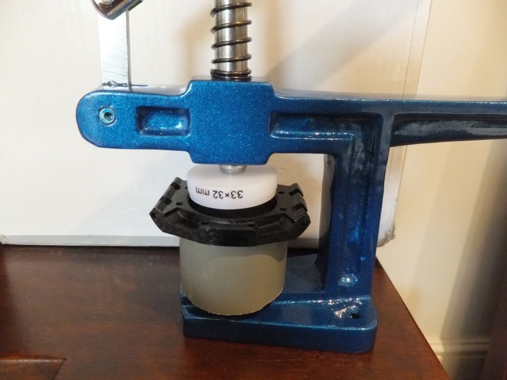

Yes, you have to press the chapter ring out of the case. I place a cylindrical object in through the back of the case which seats against the overhanging rim of the chapter ring, then I apply a downward pressure on the case and push it downward. Chapter ring comes out no sweat.

here astro .... here's what i done made a make shift support to hold the case with 1.3/4inch plastic pip cut down to size .. and press down with 32mm die ... job done!!

Thank you very much for the picture above! It really makes it clear what has to be done, but I still have one question: tubes (crown, chrono pushers) must necessarily be removed first?

Your very welcome ... just remove the pushers first and crown as Gio explained in hes thread , the pusher tubes and crown and be pressed out after you remove the chapter ring ... what did the golden pm say ?

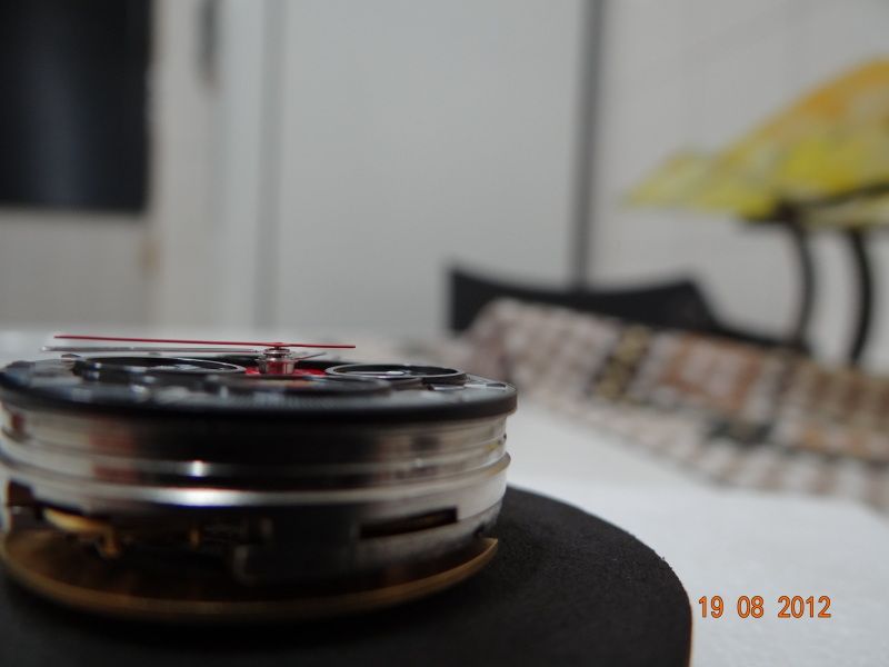

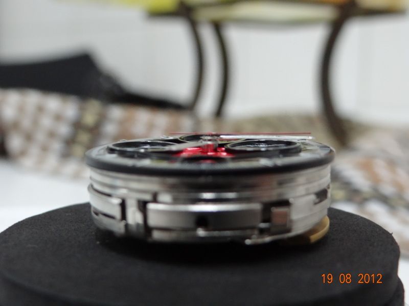

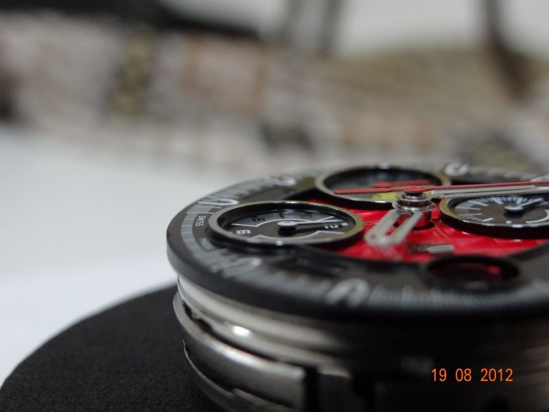

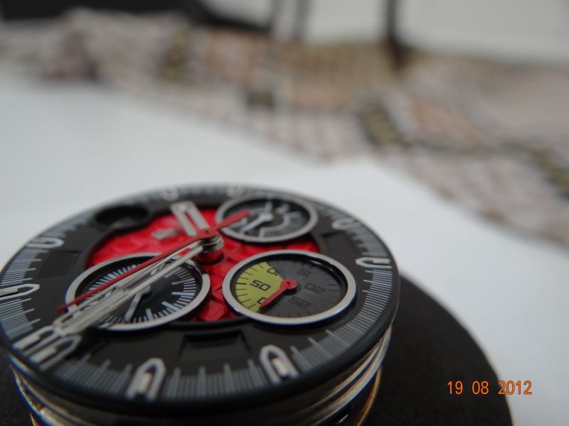

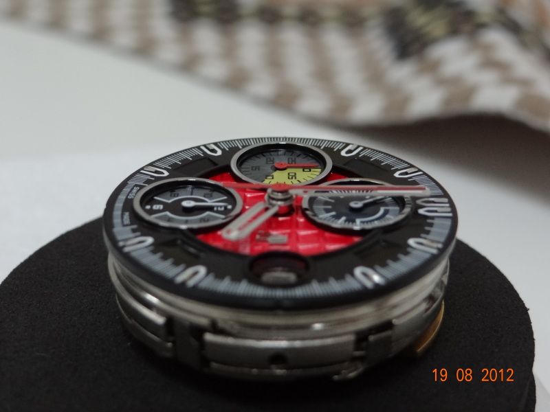

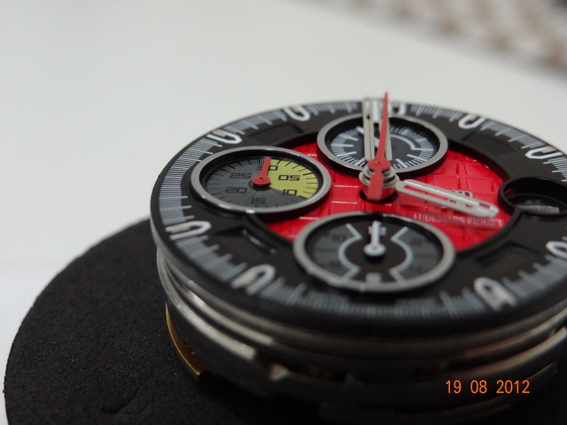

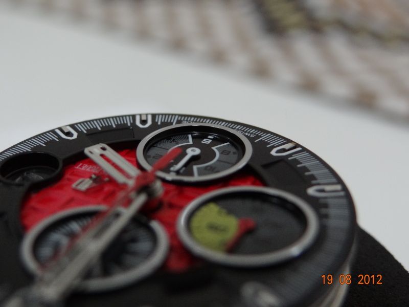

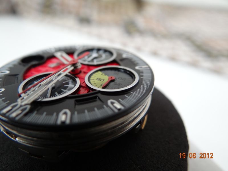

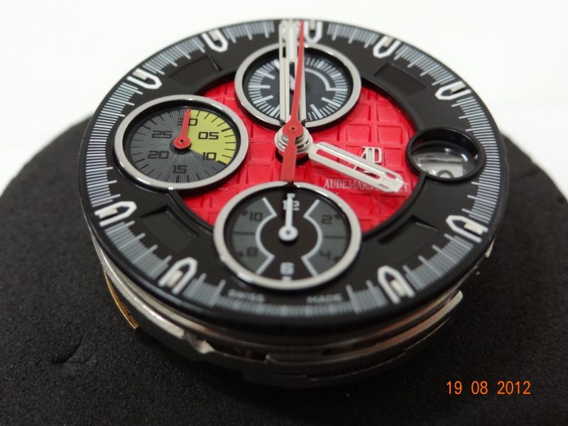

another issue on the rep dial?
I am next in line for the CF case!!
Maybe not the right thread, but have you guys noticed how the metallic rings surrounding the subdials are inclined towards the center of the dial? The outer portion of the rings, close to 6, 9, and 12 on the dial, sit higher than the portion close to the center of the dial, so that the rings lean towards the center of the dial. I include several pictures below that show the issue I hope is corrected by ryan and his dial project.
