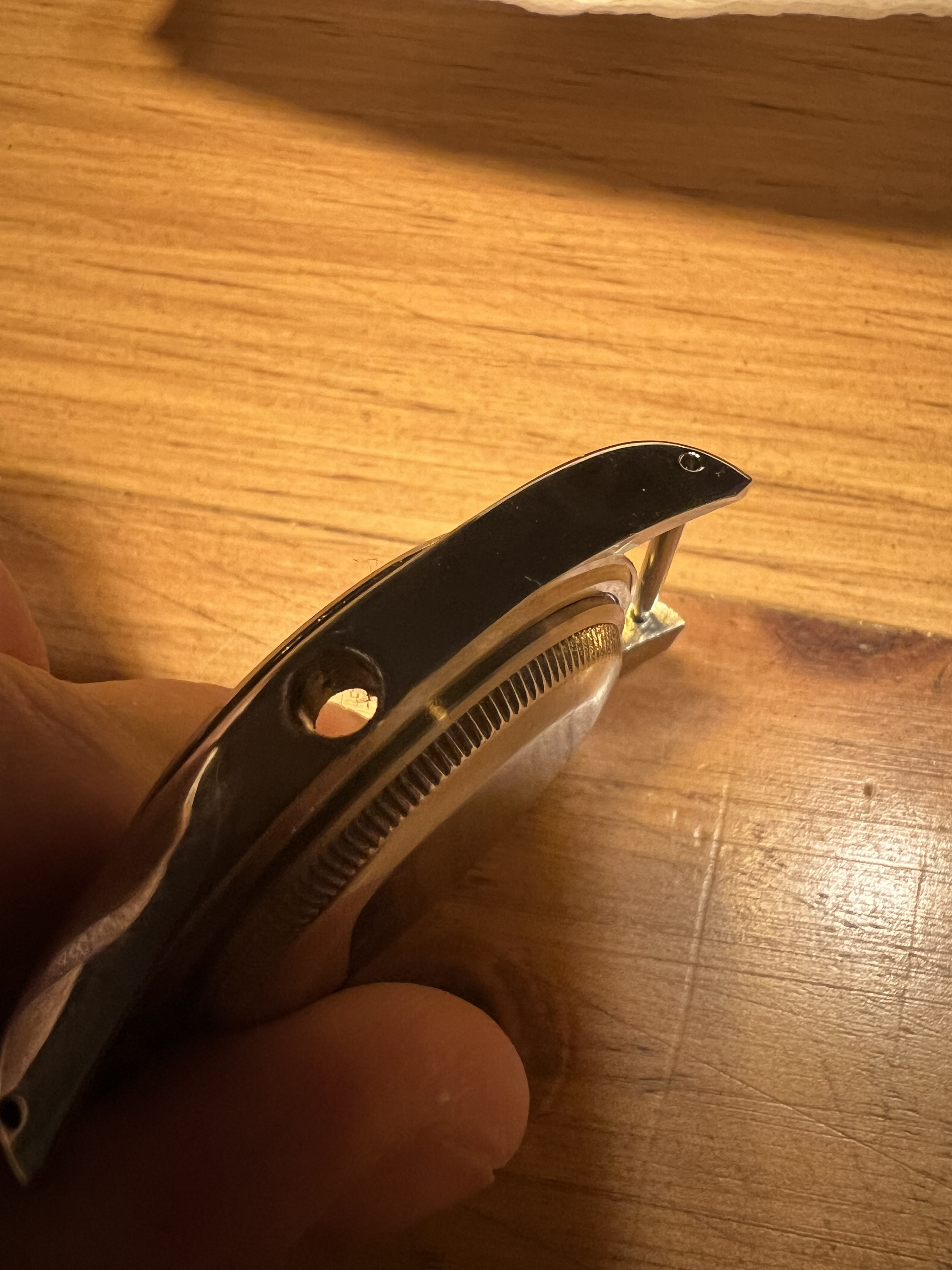

The tube is pressed in, maybe a tool will work, but in this case, as it is smooth on the inside, it could be a square screwdriver (I didn't try it). Heat didn’t work
I took it out by putting a file inside from the inside, hitting the file gently with the case and it came out without breaking, but it wasn't easy.
Now I have to widen the hole which is another challenge because the hole is not very centred and if you open it too much you can ruin the case.

any tips on how to determine if the tube is screwed or press-in?
A clue that it is screw in is the tube will show some sort of engineering (like scalloping, a geometric shape, etc) inside the tube to afford purchase for a tool. This may be at the very innermost side of the tube but it will be there.
Slugger
Absent Minded Professor
17/9/20
2,216
1,845
I use bits that are just an hair larger than the existing hole and then incrementally larger bits until I get what I want. This way, I am removing only a little steel at a time.
Also, make sure you are using a sharp bit that is rated for stainless steel and plenty of lubricant (WD-40, for example). Done this way, you shouldn’t have much drifting.
If you want to move the center of the hole, a vise and drill press would be your best bet to getting it exactly where you want.

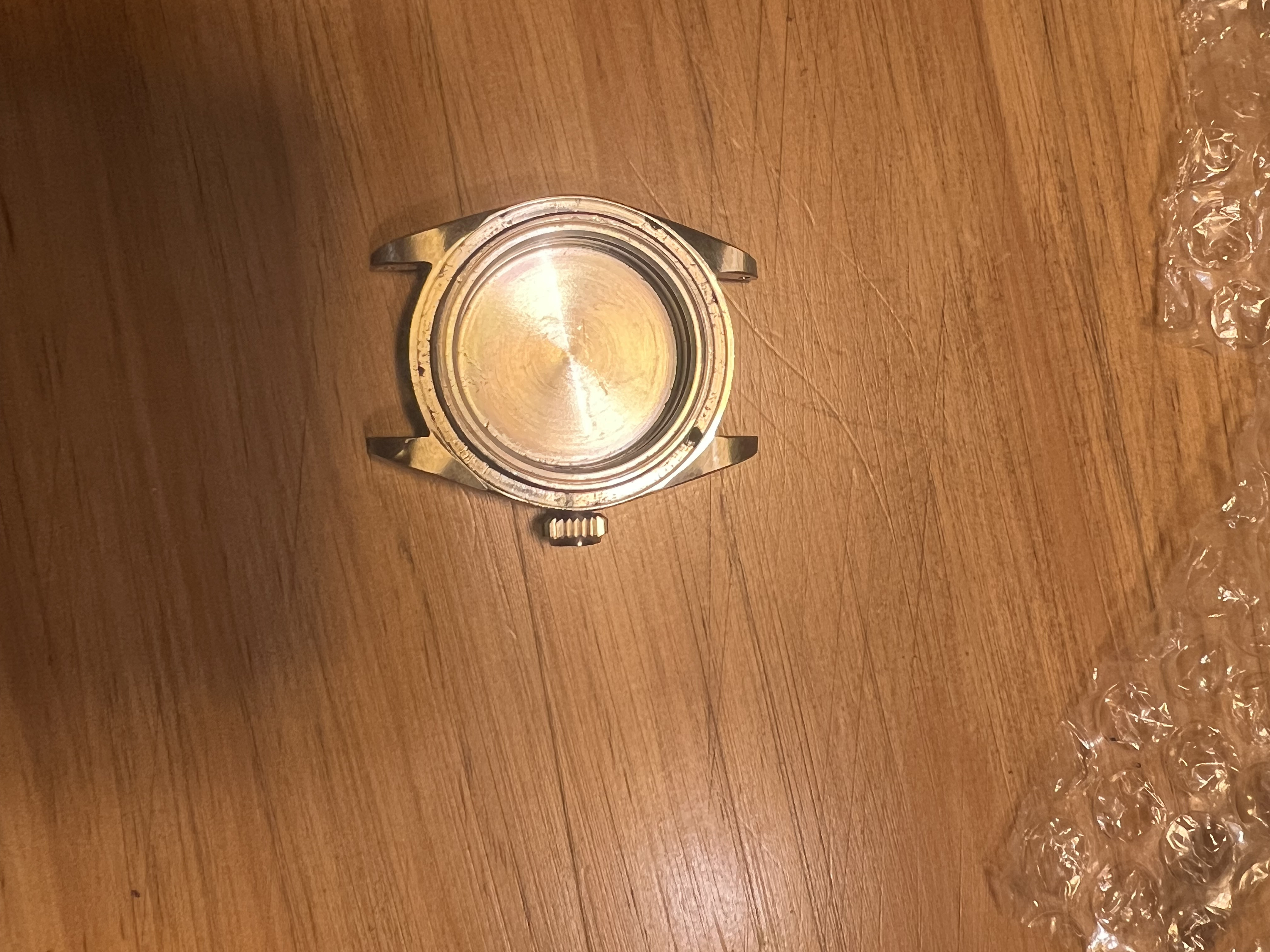

I've drilled a little today the hole of the tube, the only thing I haven't gone beyond the 3.2 bit because I do it with a dremel and I think it's not ideal because you can feel a vibration that doesn't inspire confidence.
I'll have to use a drill, I have the m4 x 0.35 mm tap on the way.

3,5 tube hole is done! It is not easy. The material is very very hard, impossible to do it with a dremel at least for me, use of cutting oil is a must (and a lot of patience). First of all 3 mm hole… 3.2 mm.. and finally 3.5
Now the B part is missing, using the 4 x 0,35 tap, I'm following a tutorial I found, pity I don't have the tap yet (Chinese year has delayed me a lot the delivery and I couldn't find one in my area).

Athaya tube and crown installed, not easy, the material is very hard.
Now I still have to do
1. the part of aging the dial (a thousand doubts about how to do it), I'm torn between trying to create patina or using makeup, I even investigated ways to create patina with chemicals
2. Decide for the bezel, none of them convince me about the quality and the pip I received has not convinced me either...
Otherwise, I'm happy with this project that I've been obsessing about.
