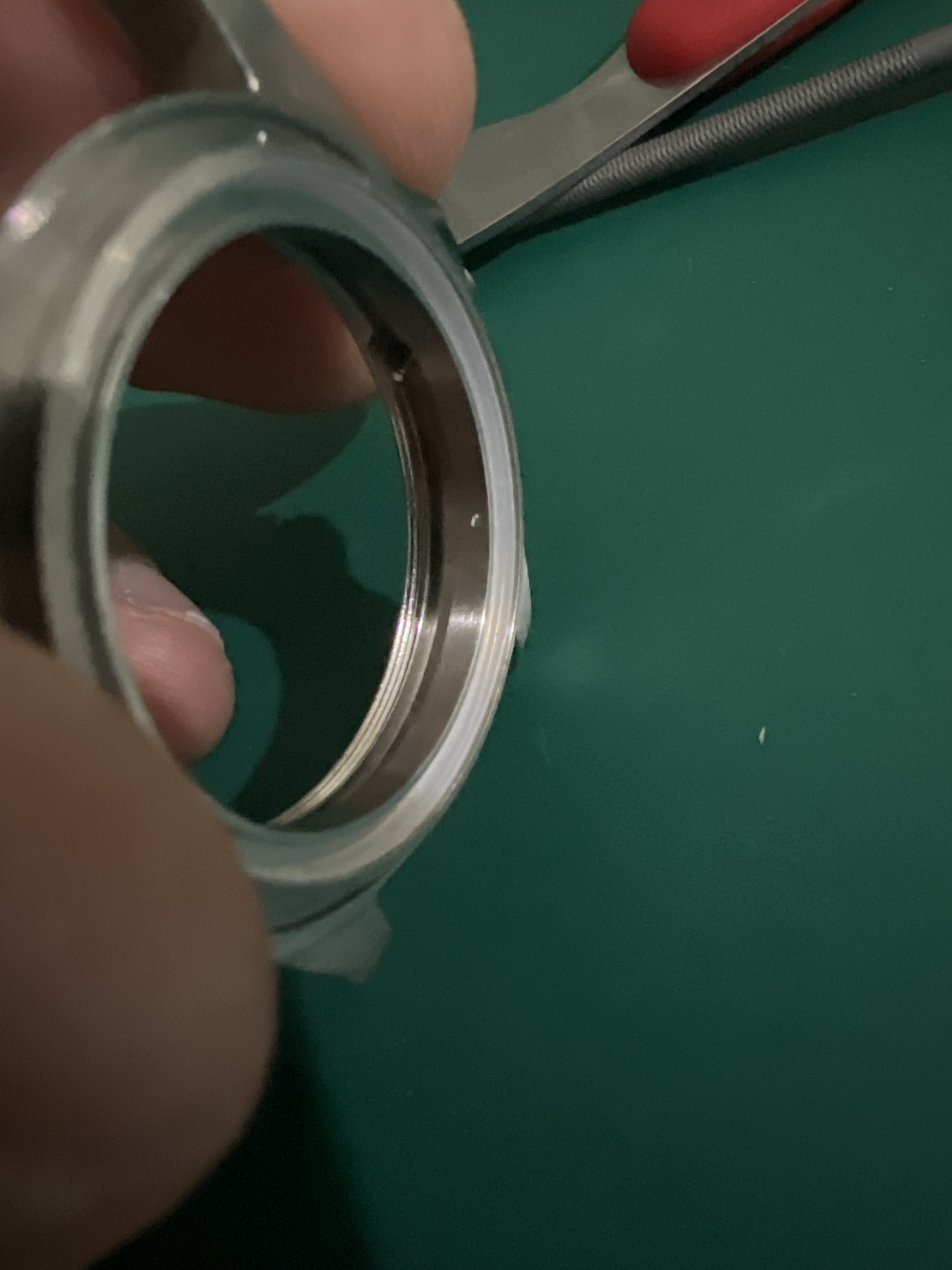

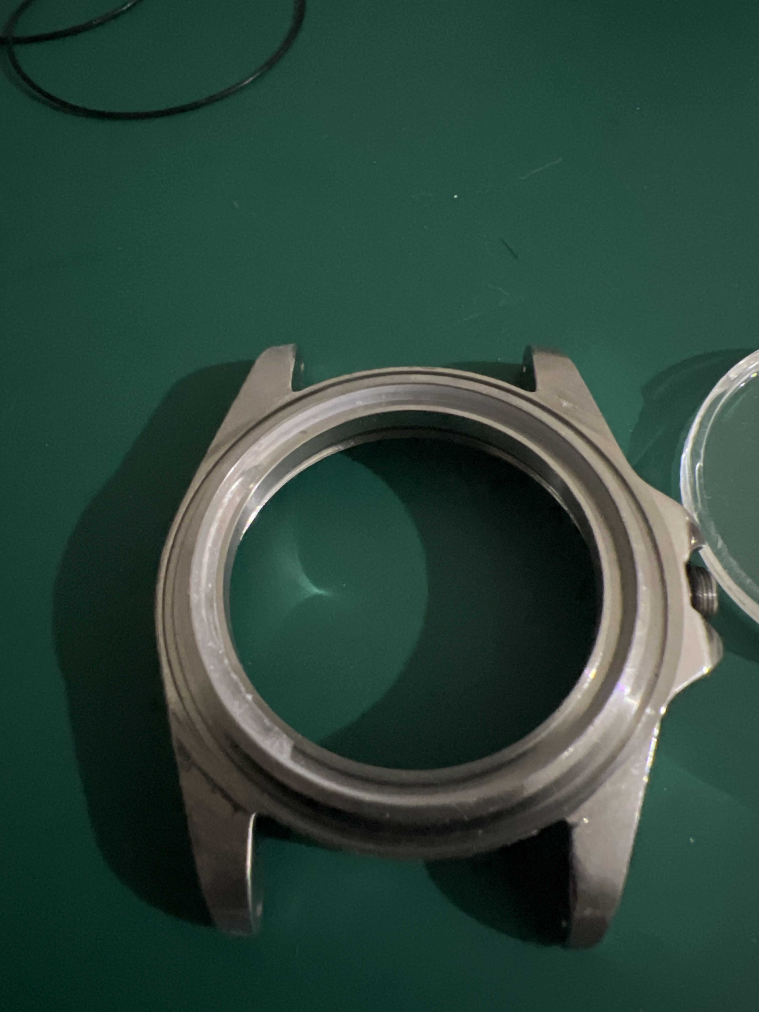

Eureka! Finally using hair a bit of hot Water and pushing crystal from inside the case
Imagine how stuck it was that a piece of it has stuck to the crack in the case

Now I see like a "plastic" in the slot, need to remove?
Karbon74
Pika Factory
5/5/23
12,271
25,805
EU - Kalos Region
the same happened on my 1016 case.
you need to let the case into an acetone bath to take off all the little bits, else it will be a problem later
don't forget to remove all the gaskets
and remove the tube !!!
