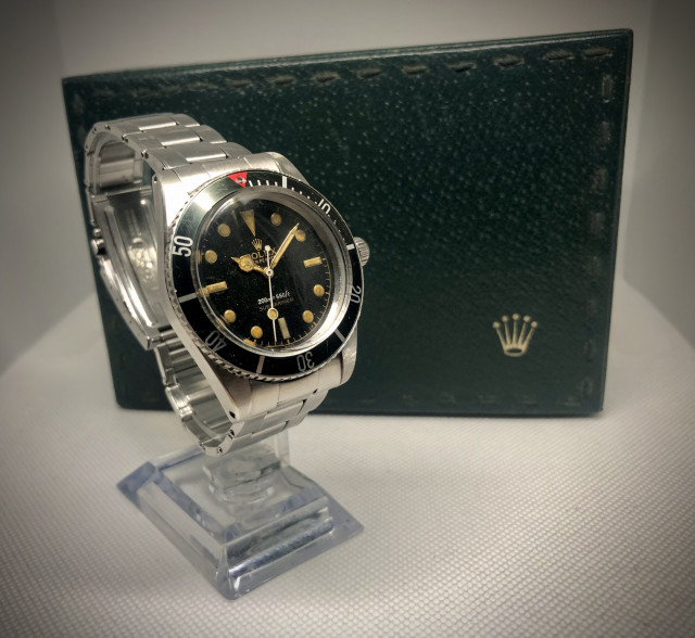

I take this opportunity to ask a few questions since my next project is this watch:
I have the materials on the way, to aged the dial I talked to @DeLoMan and I will use "tamiya", what do you advise to fix that makeup and that it does not move, spray lacquer?
@369mafia what did you do to modify the tabs you comment?
Thanks!

I will take this opportunity to answer both questions.
once you apply the weathering paint. use a dust blower to blow away any loose particles of the paint and what remains will stick to the dial It can be disturbed it touched but once you have the dial on the movement and the hands on the dial, it is unlikely anything will come in contact with the surface of the dial to disturb the finish
I tried sealing it in with a clear coat and the weathering disappeared. not sure if it was the moisture of the spray or the chemicals but the beautiful weathering pattern had disappeared. so I wiped it clean and redid it. the beauty of raffles dials, is that they are durable . so if you mess up or go overboard with the weathering , you can rinse it off with warm water and try again.
because the case is designed for NH movements they use a fitted movement holder and dont use tabs and screws to hold in place. you need to trim a pair of movement tabs and give them a slight bend so that they will fit into the gap of the case to hold in place. not anything different on how to mount an eta you just need to adjust the tabs is all.

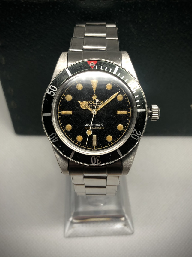

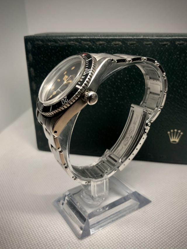

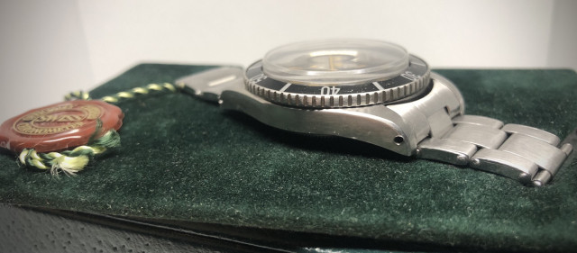

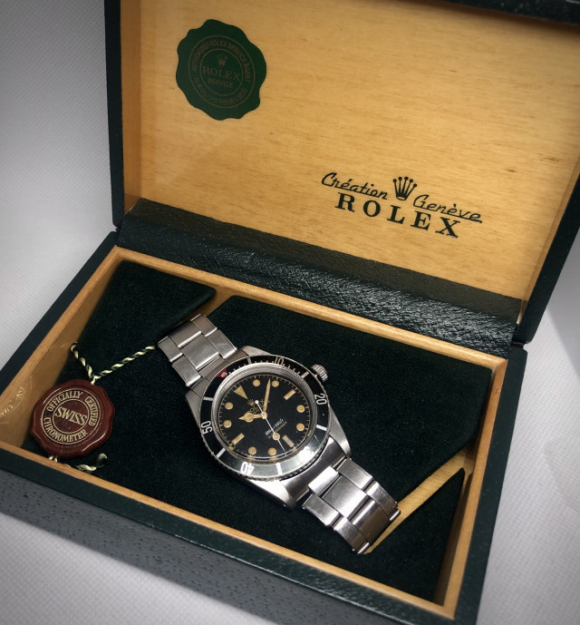

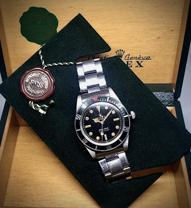

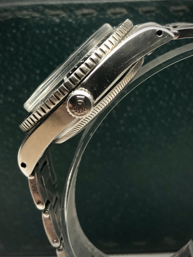

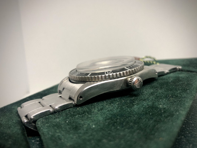

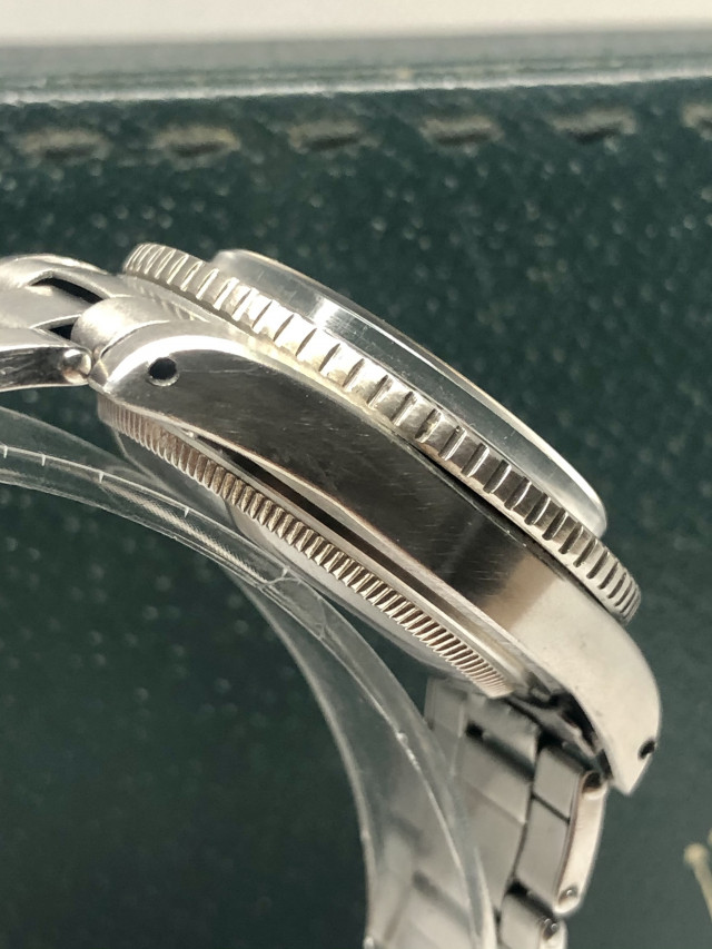

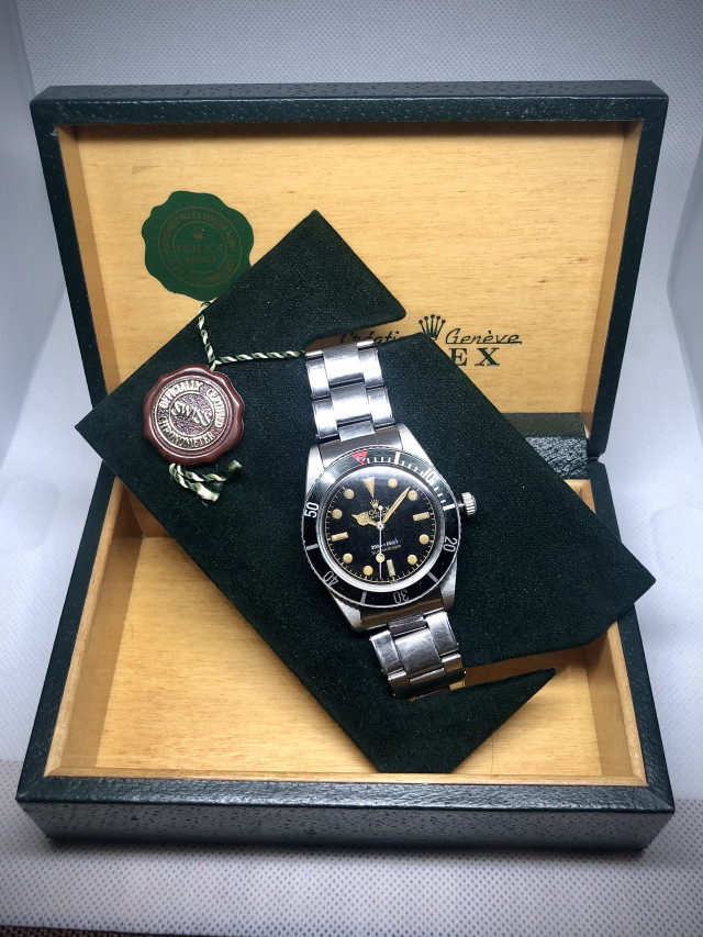

I couldn’t wait for a 6536 dial. I had to try it out and am not disappointed. 😍
Glued in the 116 crystal. No issues i like the beveled edge of the crystal for a change instead of the domed piece. However i think i could round over the wdge on this crystal a bit to give it some curve. Perhaps in the future.
Aged the case and enlarged lug holes.
Aged the bezel expecting to see some brass but nothing yet. Will try heat next when im back at my shop where my torch is The wear on the bezel make it look well worn
Did a bit more shaping and softening of the mid case
Overall very pleased with this case set. A great economical option for a viet case set with litte work. I am satisfied with the appearance at present however if you were so inclined. I could remove more material from the mid case and really thin it out which would be a suitable case for a 6205 or wven early tudor small crown subs. 7924 7928.
Some final pics to show those curves and flanks and the completed piece for now.
This was a fu. Project and will provide pick up a couple more for future builds.

Great job! I just ordered one to upgrade my Raffles case.

Amazing!
dial is from Raffles but handset is Helenarou? Looks great for me

Yes. Dial is raffles will be replaced with a proper gilt 6536 decal dial in good time. Hands are tudor sub from wso.
