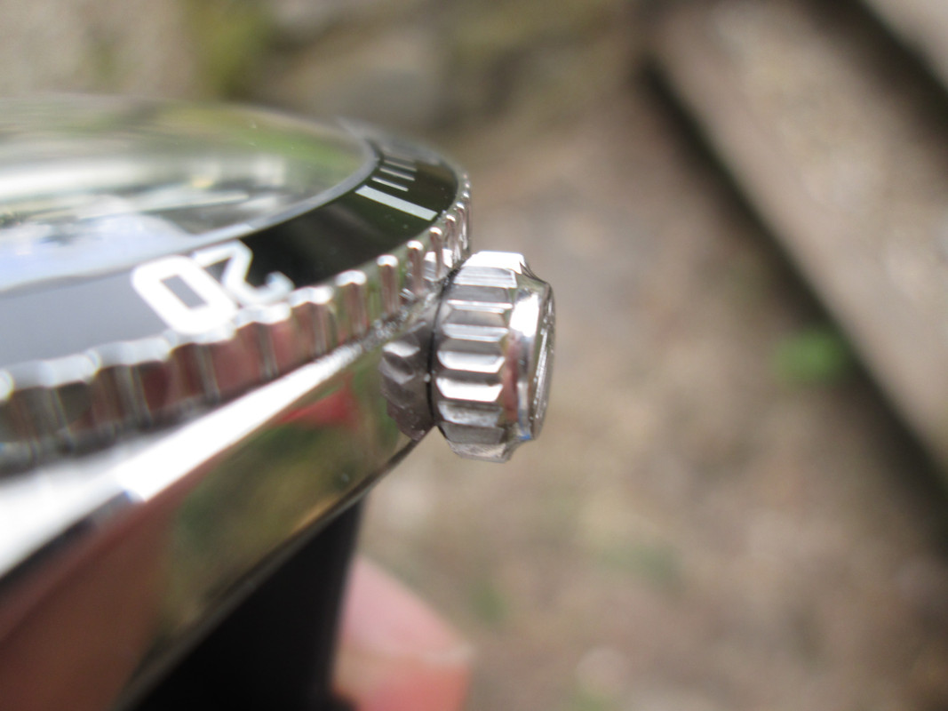

Build specs:
- Dial : Decal dial
- Bezel : Tiger Concept
- Case : Tiger Concept 5508 v6
- Movement Ring : Tiger Concept
- Crown and Tube : Athaya 800 (see pics below)
- Plexi crystal : Tiger concept
- Movement : ETA 2840 serviced by me
- Hands : Cartel hands
- Spring Bars : 2mm from CousinUk
Pretty sure it's the tiger concept 5508v6 case that you can pick up for $139 with 2813 movement.
Yes it is, I bought only the case with mouvement ring, caseback, gasket and insert included for 90/100 euros from TC
