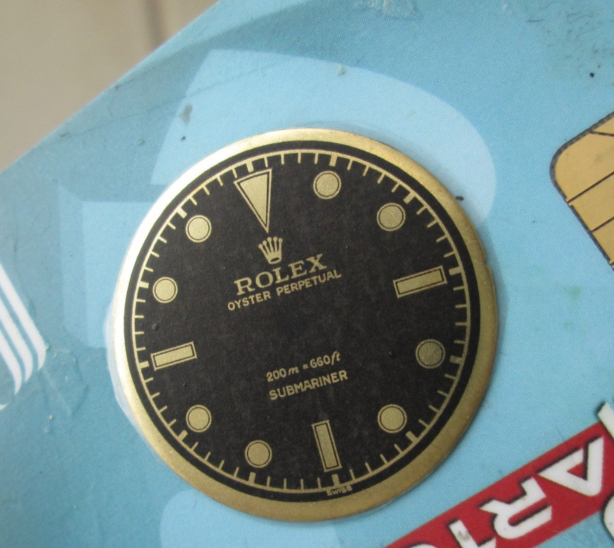

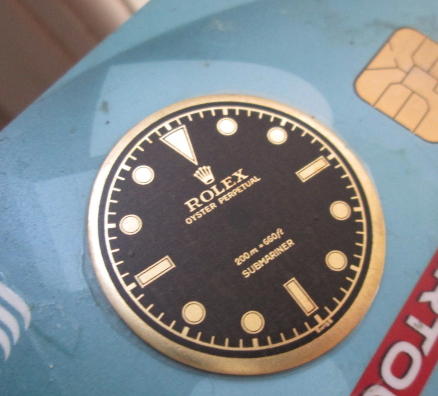

Yesterday I achieved to make something special ...
domed negative gilt dial ????
YES ... a domed one !!!
Not a rep but a custom one for a lady who wants her own unique vintage diver
Envoyé de mon Moto G (5) Plus en utilisant Tapatalk

Whoa, that's interesting. I would not have thought that the decal would adhere to the sloping edge so nicely. Some of the early Rolex and Tudor dials were domed just like this.. I wonder where you got such a dial?
Well ... I've just sanded a very old Rolex 4499 dial from the 40ies ????
Just a joke of course ???? as I'm trying to build one for my Air-King collection.
That dial was in a little French diver from the 60ies.
The printing was not really nice so I've sanded it to build a custom gilt diver.
All the parts will be kept but all of them will be modded so that I can get something "unique" at the end.
I've used some "tricks" to make the decal curve and adhere on the doomed dial plate and ... sometime secrets must be kept secret ????

I see, well nice work. I wish there was a cheap source of domed dials like this. It's one of the subtle features on the real watches that makes the illusion of the dial jumping out at you. On the gg-w-113 pilot's watch I have, the domed dial actually sits higher than the case itself, creating a cool bubble effect.
Indeed !!! really cheap diver from the 60ies that a friend gave to me, not working.
I have serviced the movement, a LorsaP75 P75, made a gilt dial, reworked and gold plated the hands.
I'm building a custom rotating bezel (engraved SSteel) and ... that could be a killer skin-diver when finished ????

Yes, how did you do that?
VHT gloss engine enamel, applied twice, the second layer a day after, and after sending with 1200 grid water sandpaper. How it is now, I can water sand it again, and polish it and it'll still have the crackled pattern, but very subtle, which also looks highly vintage.
