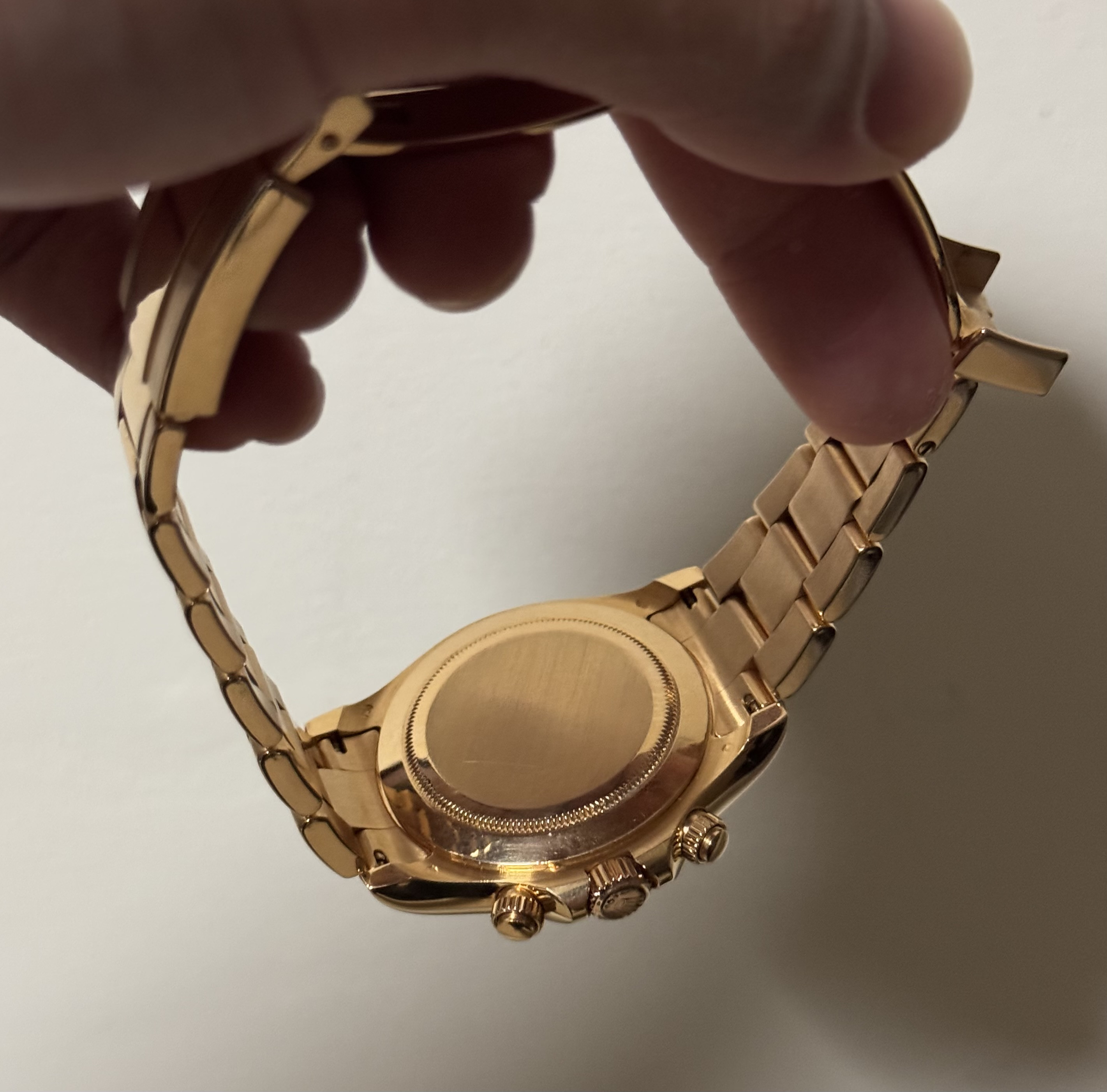

I have the same 2.0 case set but for RG. It has the correct protruding end links for 116505 and 116509.
Rehaut is hard to see without good lighting, but it’s currently one of my favourite watches with the NNF meteorite dial
Weighs in at 205g(195 with 2 links removed) clasp feels good. I’m hoping the plating will last a while.
