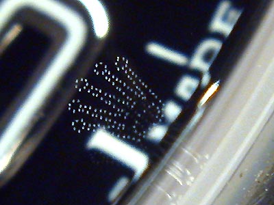

Live1, Benji is correct. We have all been saying that the gen SD never had an LEC, but that was false. It never received the upgrade to the engraved rehaut, but it did get the LEC at the end of 2002 or beginning of 2003. Rolex was installing non-LEC crystals at the same time the were putting in LEC crystals until theu ran out of stock on the non-LEC. The SD was a lower volume watch, so it evolved over time without sudden definitive changes.
In any case, here is an excerpt from my earlier post which will hopefully settle the issue:
Now, I just want to correct a previous misconception that I was under and has been repeated often (including by me) throughout the thread: Many respected members hae said that the SD 16600 did not have an LEC on the crystal. This is FALSE. My WM (who worked for Rolex) corrected my misconception. All SD 16600 made in 2003 forward [correction: most] have an LEC on the crystal. The LEC is usually located at ninety degrees from the cyclops on a rolex crystal. On watches that didn't have a cyclops, there was no process in place early on to line up the LEC perfectly, so on many Daytonas, ND subs and SD's made before 2005, the LEC could be found anywhere--not necessarily at 6. Later on, Rolex tightened their standards so that even on non-cyclops crystals, the LEC appears at 6. Here's a picture of a gen SD with LEC:
The fact that the BPSD does not have an LEC means little to me though because a real LEC should not be visible anyway. The only visible LEC's are the crappy LEC's on older reps. I'll skip the LEC and enjoy the amazing quality, gen spec crystal that comes with the BPSD!

set2374 so if you say not all sd from 2002 had lec does that mean our bp subs are still correct not having lec?
M seial serial is 2008 yes?
set2374
19/7/12
1,714
44
Well, I believe the 2002's and 2003 had cases with holes, so that means the answer is no. Missing LEC's is really not important to me though. Gen LEC's are practically invisible. You need to have the crystal at a certain angle, direct light on the crystal at an opposing angle and view the crystal with magnification to see a gen LEC. If the LEC isn't at the 6 O'clock position (as was the case with many SD's), it would be very hard to find--which is why many thought their watch didn't have an LEC. It would have been nice if the rep had a 1:1 LEC or one at least as good as the noob explorer 2 and sub-c v2, but most LEC are terrible. If you can see the LEC with the naked eye looking directly at the face, it's way too big and screams rep. You're better off not having an LEC than having a big LEC IMO.
