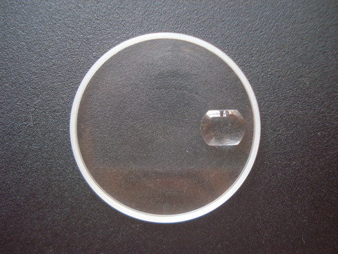

I'm planning to install a new sapphire cyclops to fit the Gen dial, but I'm not sure what size to choose. And can I use UV resin adhesive?

Why not swap a complete crystal at this point?
I'm guessing here that this is for a Raffles case with sapphire non-cyclops crystal, as the Raffles case with Cyclops sapphire crystal has the cyclops poisoned for an ETA date wheel. If the OP is using a gen dial, the non-cyclops crystal with stuck-on cyclops is therefore the easiest way forward...
You can buy a crystal on Raffles website with the correct date window.
I have done this with success using UV glue and gently cleaning the excess glue after with acetone. I also used masking tape as an outline to make sure it was properly aligned when gluing.
Thanks for advice! I think masking tape would be a big help.
