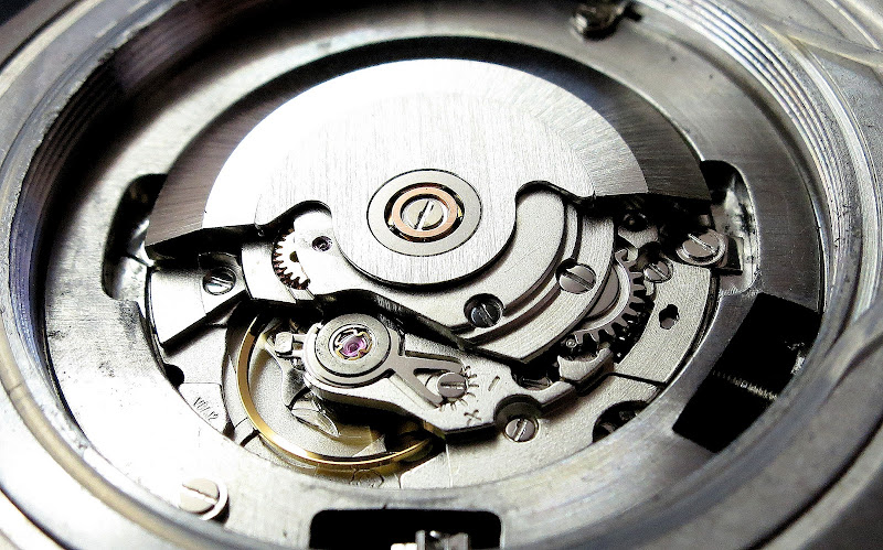

This is my movement... At least it's an ETA too bad no decorated Rotor, but no 7750 wobble.

But with this movement you dont get the choppy sec problem and also who will ever look inside your watch. :)
