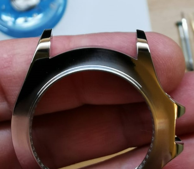

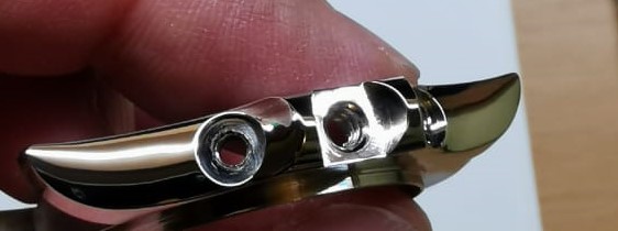

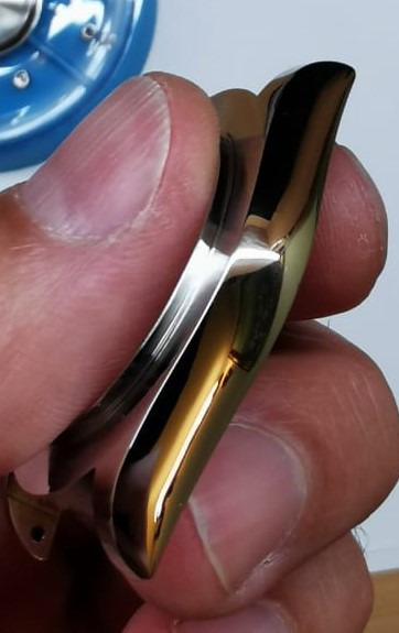

Regarding the case shaping , i could explain it better in a video, but i'll try to summerize what's wrong with noob :
- sides are not "fat" enaugh
- lug top surface needs to be angled towards the sides ( bottom )
- tips should be equal in width
and few more things i find very hard to describe without showing them on the case itself.
Here is a pic of my modified case for reference :
It's not perfect of course but it's a step in the right direction.
What you always need to have in mind is that rlx will always keep surfaces flat and round only the edges slightly.
I've seen many modified cases that look overbuffed.
In order to make noob as close as possible one would have to weld the sides and add some material, then reshape the case .
Depending on QC cgs may need to be modified as well .
In order to understand what needs to be done you first need to try and understand the shape of the genuine case .
If you look at it for long enaugh you'll be able to tell what the differences are . Try understanding it in 3d and not by drawing lines on angled pics :) .
Eventually you're goona be able to tell the GEN from any other case in an instant. It's like having twin friends. After a while you'll be able to tell them apart easily.
After a couple of years they'll seem so different it would be impossible to mix them up .

Unfortunately this is completely true. The geometry of the daytona case is something that bothered me so much I refinished one by hand during lockdown when my tools were all in storage. I'm still not happy with one of the lugs either, and that was after 3 days of sanding, brushing and polishing.
The main issues are the first two listed, and the second in particular. The curvature of the lugs is very sharp when you examine the gen in comparison. Aside from the straight curve down from the top, it also needs a fair bit taken from the bottom in order that the lug points down and is chamfered at the edges. There should be a subtle rounding - the noob cases look more like GMT.
Fortunately you can thin the fat one out a little and the put the difference down to over polishing. But as Spatiumtemporis says, you can't work on the watch unless you understand it, and you can't understand it without scrutinising a number of gens.

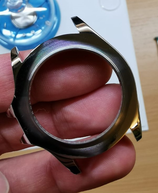

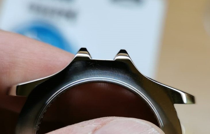

Here is another modified case.
I think this one came out better . Let me upload some pics real quick :
